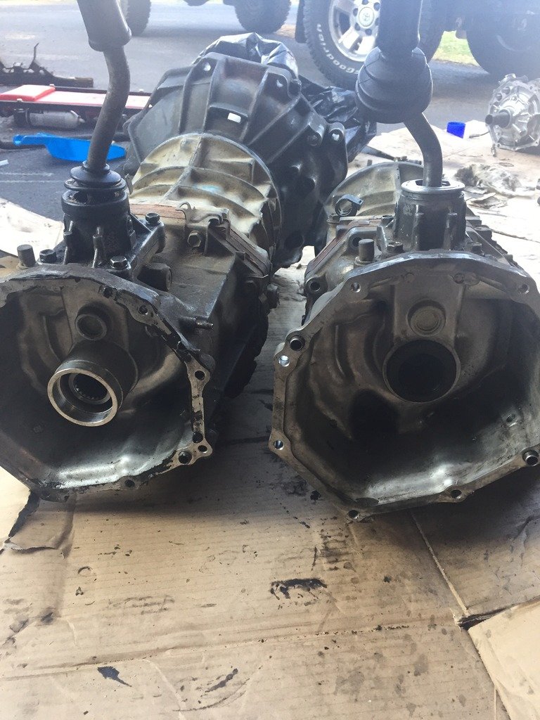

    This is a photo of the back of the "99" transmission on the left, and my 95 on the right. Both have the t case removed.
    All of the transfer cases I've seen from my 95, the 98 and the 99 I saw a picture of, seem to have female connector tube that appears to slide around a splined shaft that comes out of the transmission (you can see it below, it's a picture of my 95 transmission, except I seperates the two housings)
    However my "99" transmission, doesn't have a spined shaft out the back, instead it looks like it has the exact opposite, a female connector tube.

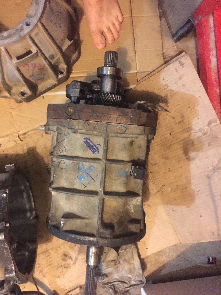

    9239F1B3-894B-4B53-8DE1-8A6ECA6949DB_zps_5d8c23336e3982fa91630e1581ff782e9ed4dbd0.jpg
    Hers the picture of the two transmissions. My stock transmission is on the right, and my "new" transmission is on the left.
    Both input shafts are the same length, and the only major difference is that the stock 95 transmission has a spined shaft sticking out the back that the transfer case slides around. And this new transmission has a splined sleeve that a transfer case should slide into

    The new trans has a seal adapter for a dual case setup, that's what the big round looking thing is. You should be able to swap the back half of your old trans onto the new one. That seal adapter is pounded on there and secured with locktite so it's not coming off.
    The inputs are both male and should have a female adapter tube, if it's not on the trans output, its stuck to the tcase input (most likely scenario).

    I feel like that aluminum part is a sleeve that can be transferred over. Anybody confirm?

    It's pounded into the back of the trans output and usually coated with red locktite. You aren't getting that out without damaging the transmission housing. That sleeve is aftermarket and part of a dual case seal adapter.

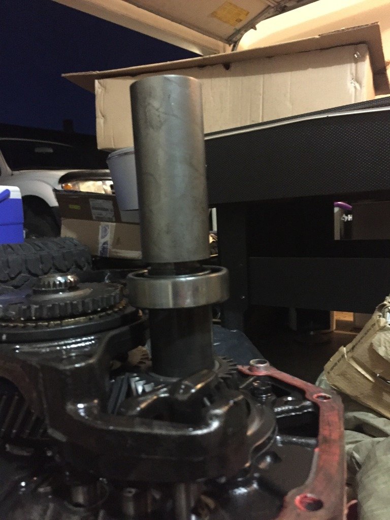

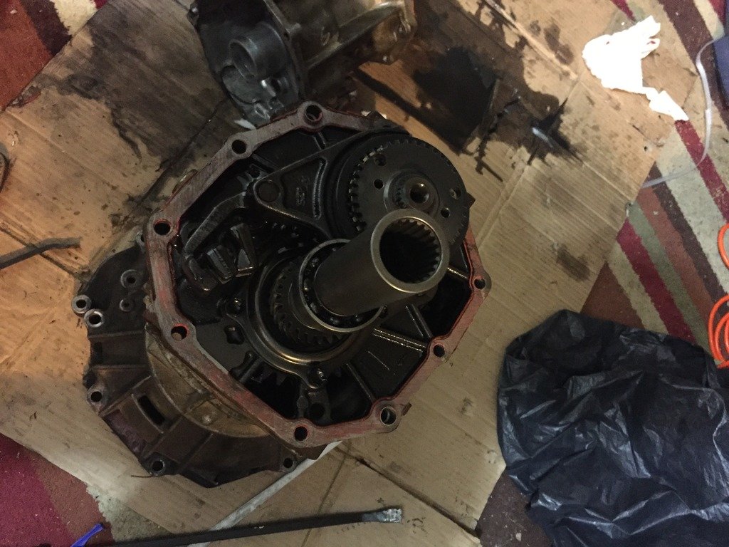

    1B7E60DA-0E87-46CF-92B0-012DEFC9A608_zps_5df6782f2dd272d2d95ccda824763b893d81c8ea.jpg
    6C0A85AA-C88A-4E94-8018-F37993BA28EF_zps_878e432eeb323a71ce17e2568054b94c517be8ff.jpg
    So I split the two housings, and I need to get rid of this sleeve. How do I go about removing it? I'm assuming I have to completely remove the output shaft and re use the old one. Is there anything special I need to do or not do? Messing around with the inside of my transmission has me extra paranoid

    That sleeve should slide off.

    Sleeve could just be stuck on the spline. get some penetrating oils on there, kroil is best if you have it or pb blaster if not.
