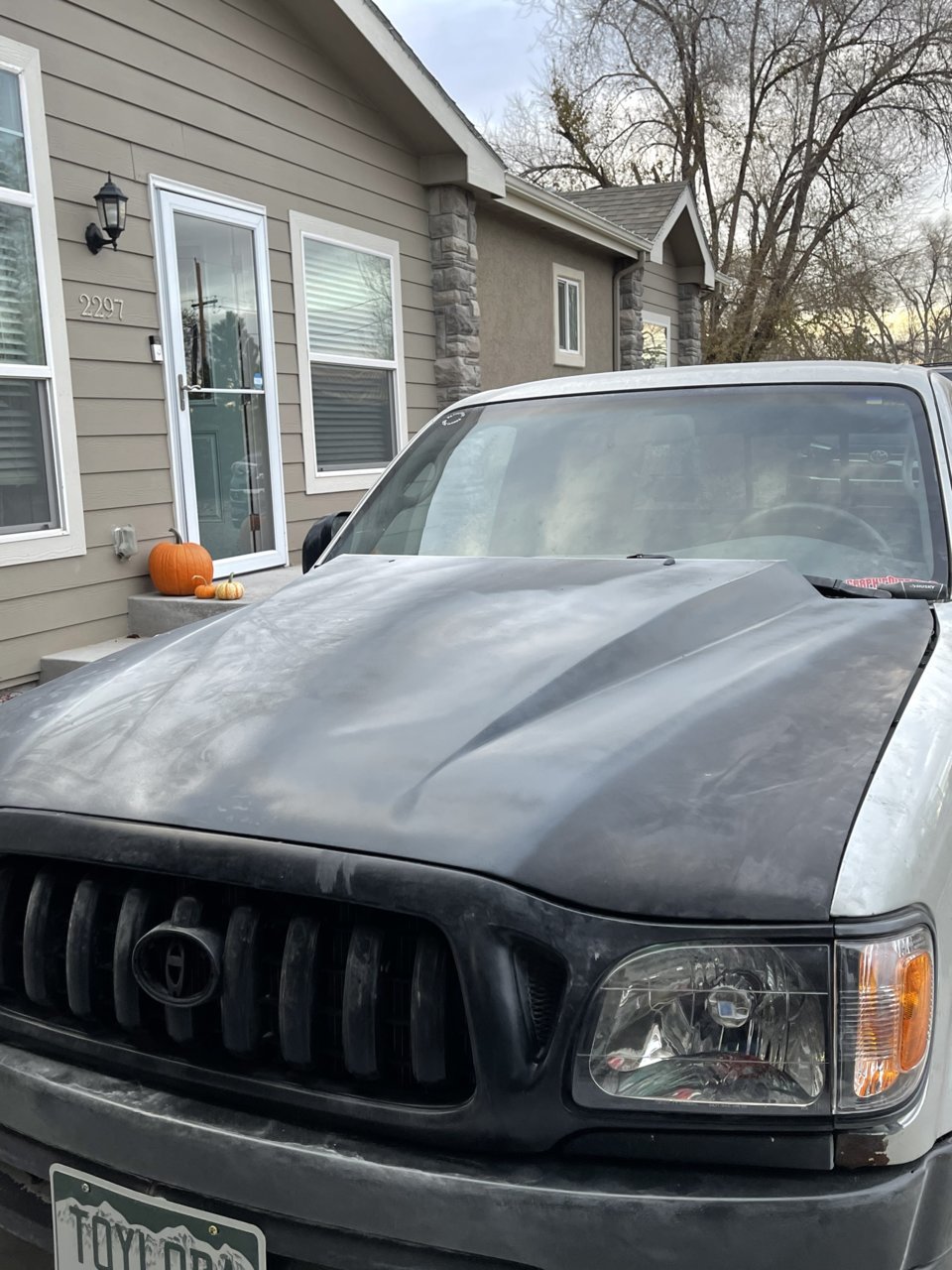

    Even with the hood I made there isn’t really any room for the snails. I’m sure I could jam them in there but it would be difficult 873212B5-E9D1-474D-A8B1-20864552B63A.jpg

    I had to raise the motor up to make room for the steering and to clear the flipped off-road oil pan. That’s the only reason I made the hood. It nearly hit the hood when it was stock. The truck is corvette front suspension in the front.

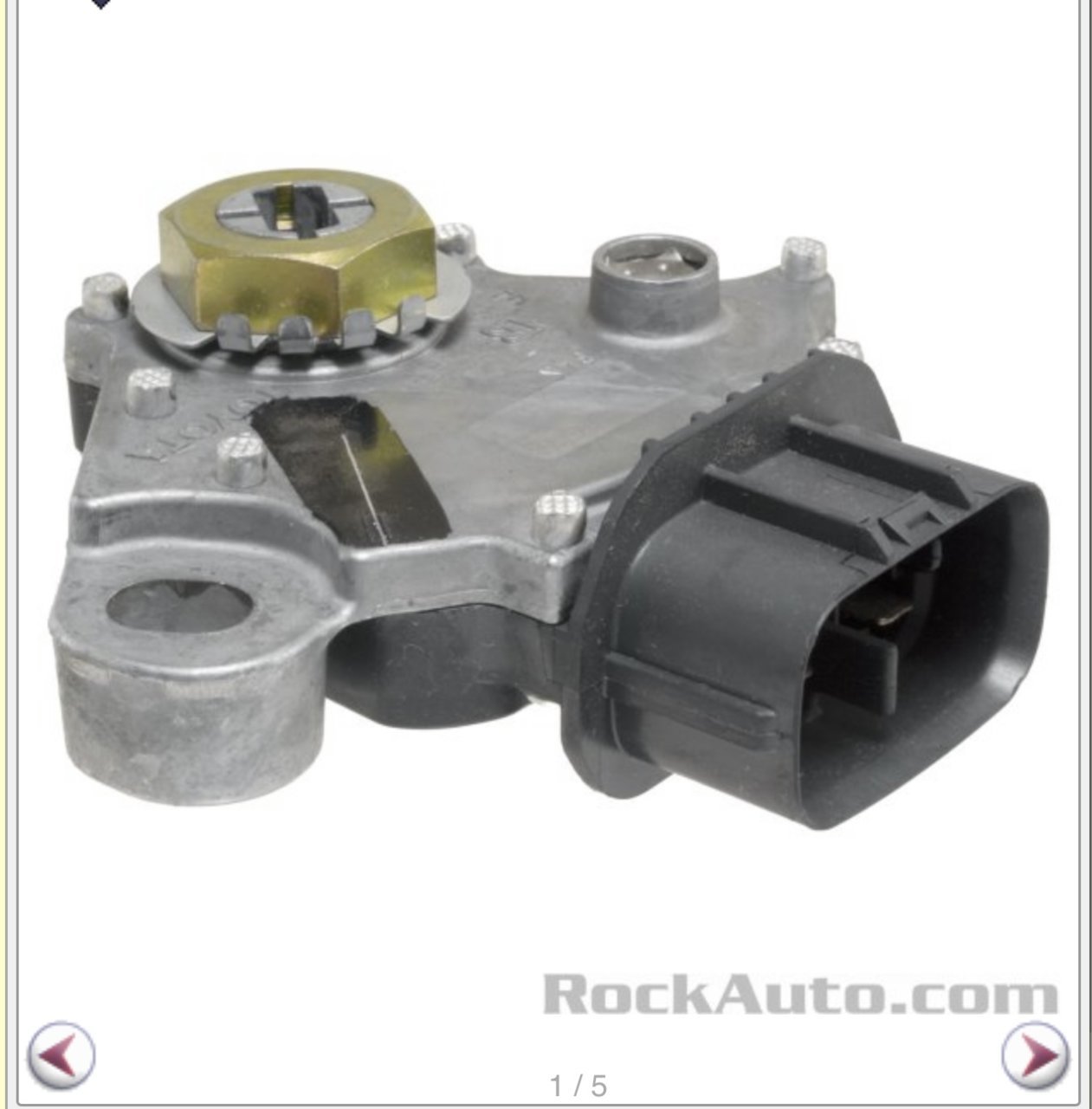

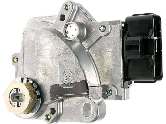

    It starts, once warm if I turn it off it won’t crank at all. Like other have said it feels like it might be something in the nss. When I turn the key I get absolutely nothing.
    I’m wondering if I just need to grab a new nss. Looking online tho it looks like the 2x4 and the 4x4 nss differ in the plug. Can anyone confirm this? I put the off my 4x4 on the trans that’s on it.
    Not that I’m typing this I’m wondering if I need the 2x4 one and to rewire the right plug for it.
    and this is the one that came from my 4x4 so the plug that’s on my truck59D790AC-D61D-43A3-9386-20D638B57BB3.jpgboth of those are listed as auto transmission on rock auto for 2002 tacoma
