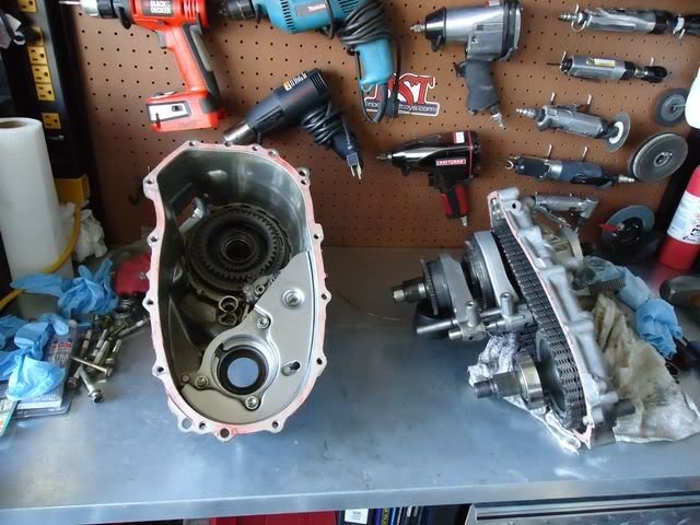

    From the outside it looks just like the FJ case with the exception of not having any shift levers and and motor hanging from it's rear. But then you open it up an a new world awaits you.
    Getting it open is as simple as pulling off the front drive flange and then taking out the twelve 12mm bolts that hold the front half to the rear half.

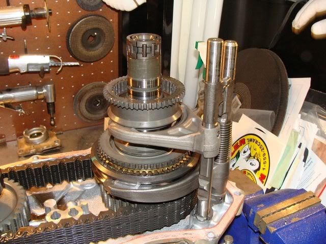

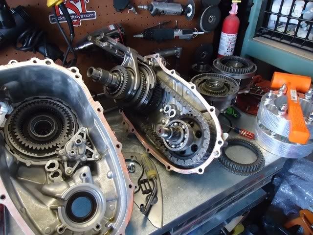

    In this photo you can see the front half has the planetary gears in it and the rear half has the shift forks as well as the hi/lo and 4wd gear sets. Another thing you will notice is that the shift forks are upside from the common configuration of most other Toyota case's and it has one shift rod that controls another internal shift rod. Because of this one rod you would have to rig some sort of lever off of te back of this case t move this rod. The problem with that is once you take the motor off of this case there is an o ring that keeps dirt out and oil in the case that will now be gone. I don't like that option.

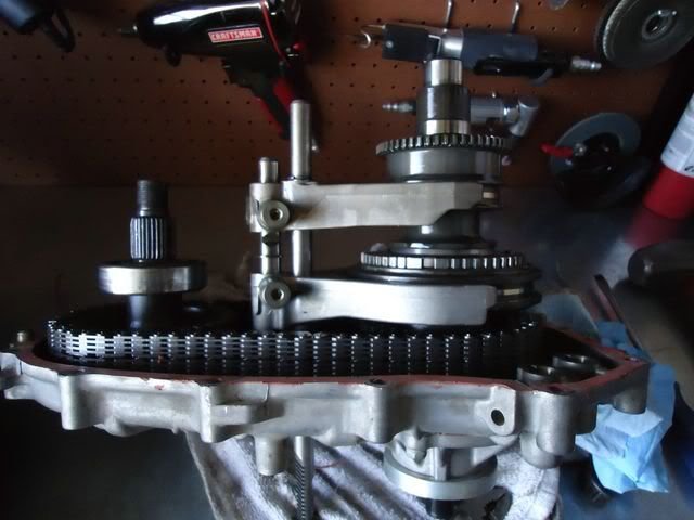

    This is the inside of the FJ Cruiser T case. Notice that the two shift rods are a the top of the case and not at the side of the case like the Tacoma's is.

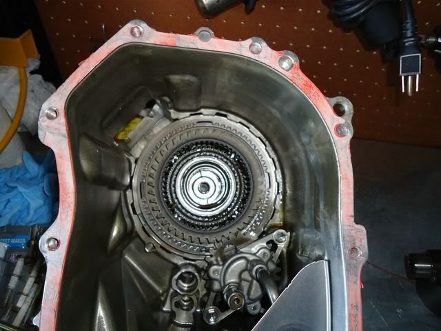

    This is looking at the planetary gears and the oil pump in the front portion of the case.

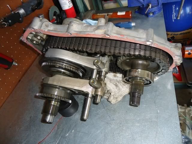

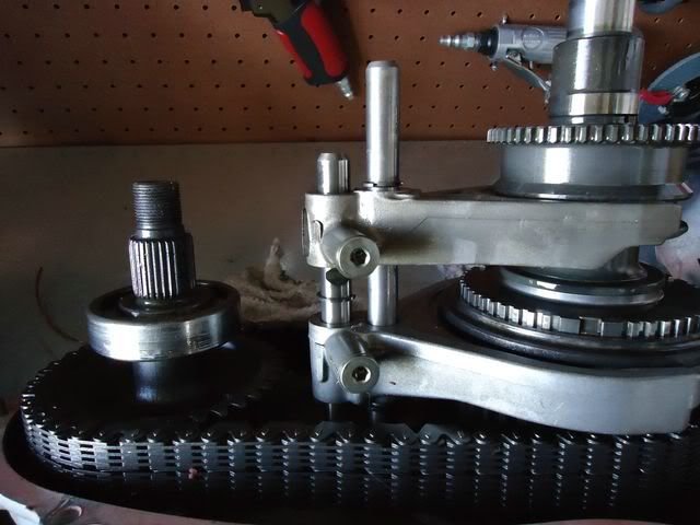

    Here is the back half of the case and it holds the hi/lo gears, 4wd, as well as the shift rods and forks.

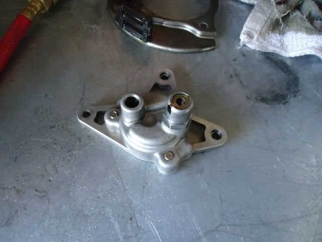

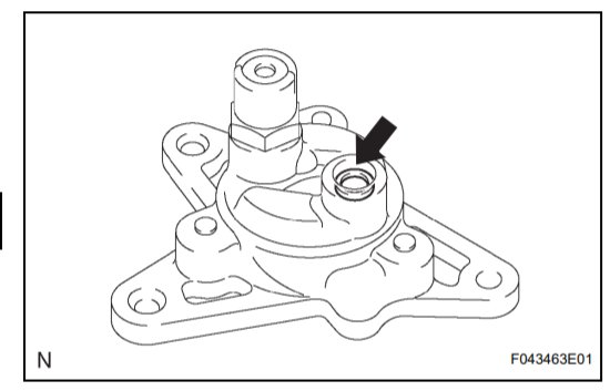

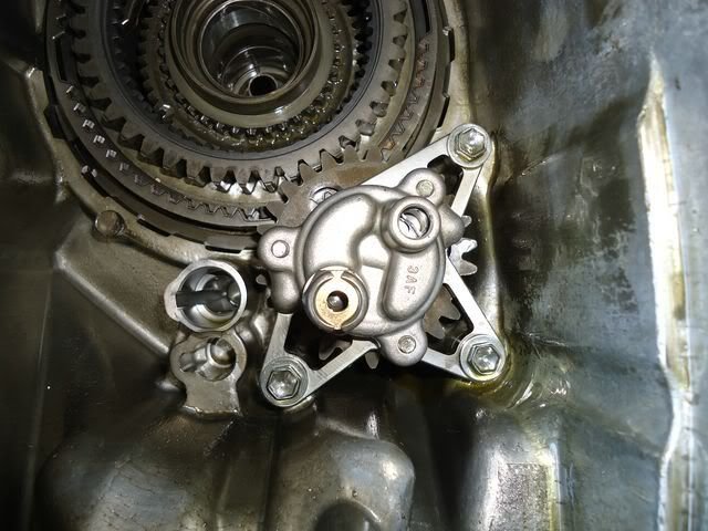

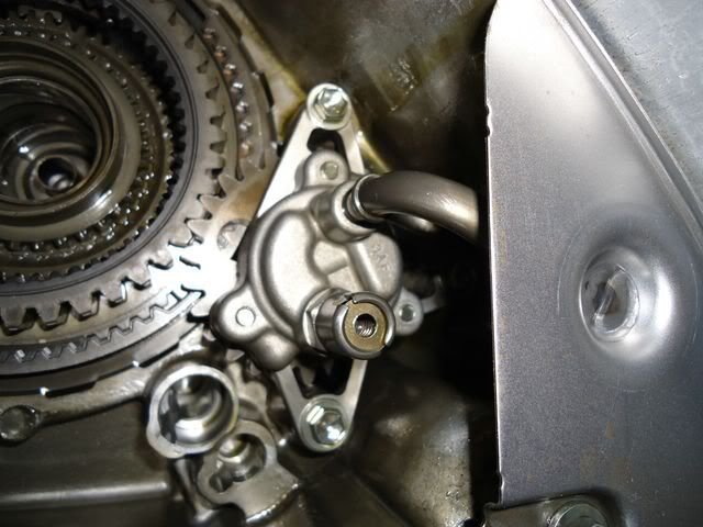

    First thing you have to do is take the oil pump and pick up off. There are three 10mm bolts that hold the pick up on. Take those off and out comes the oil pick up.

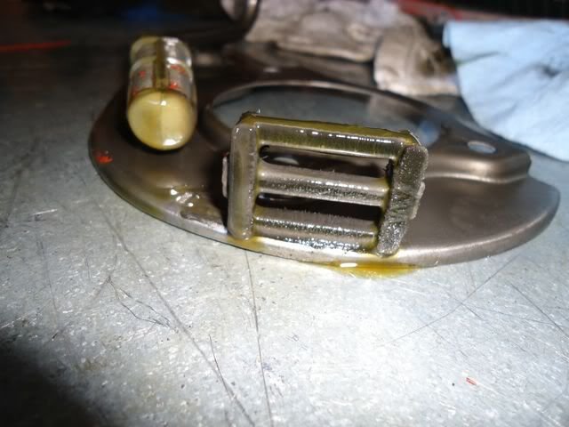

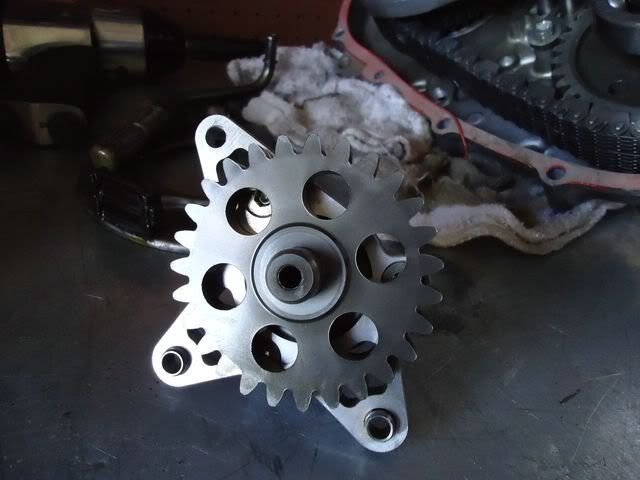

    Oil pump behind the pick up.
    Oil pick up with screen. You can see some of the sealant that Toyota used on the screen. There is anlso a magnet on the bottom of it to catch any metal particles.
    The oil pump once the pick up is removed. There are three 10mm bolts that you need to remove to get it out.

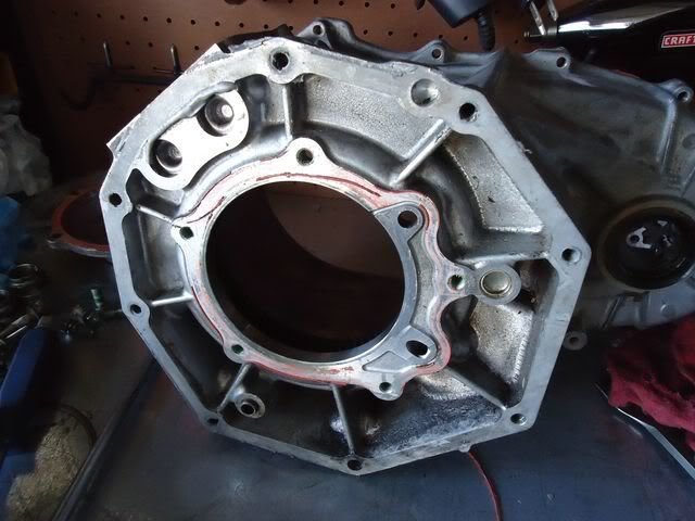

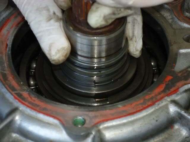

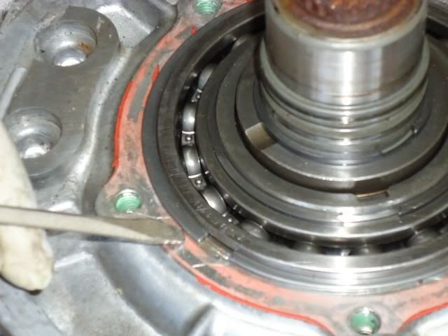

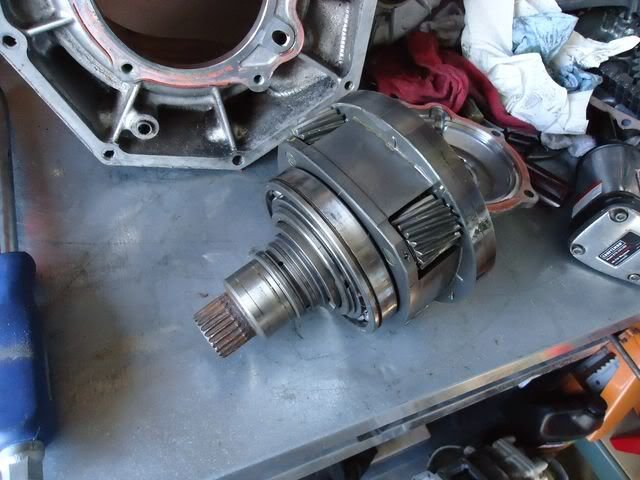

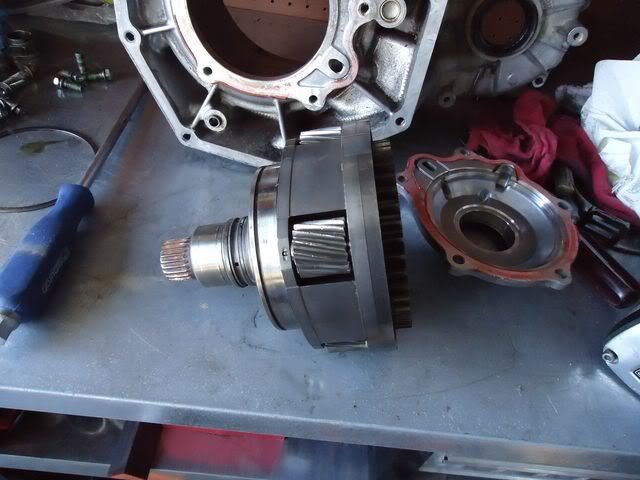

    Once the pump is out you can now turn the case over and remove the input shaft cover plate. There are five 12mm bolts that hold it on.

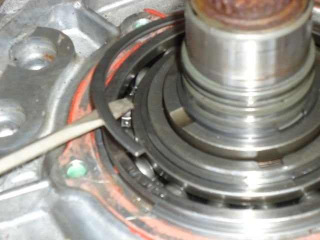

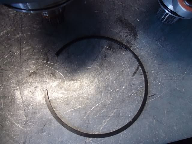

    Once that is off you'll see a snap ring that is holding the planetary gearset with the input shaft in the case. Remove that snap ring and the entire gearset will come out of the case through the inside.

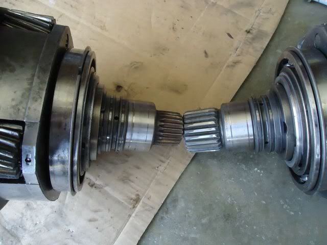

    In the picture below are the two different input shafts that you'll find in the Tacoma and FJ Cruiser t case's. The huge one is the 22 spline six speed input shaft and planetary gearset and the smaller one is the 23 spline automatic input shaft and planetary gear set. You'll also find the 23 spline case in the 2.7 4 cylinder Tacoma. As you can see the six speed input shaft is huge compaired to the 23 spline shaft from the Automatic transmission trucks. Everything else is the same with the exception of the front plate so they are a simple swap if you know what your doing.

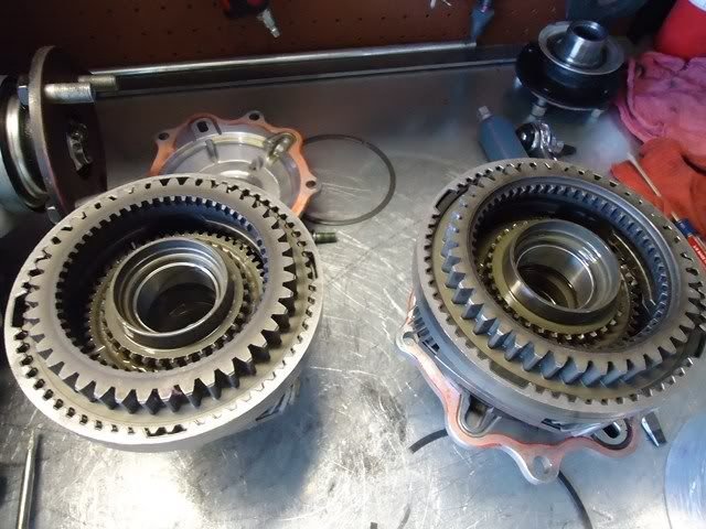

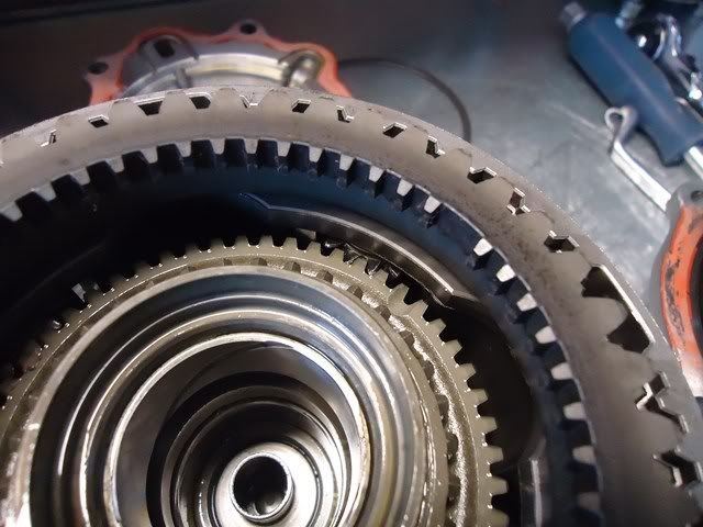

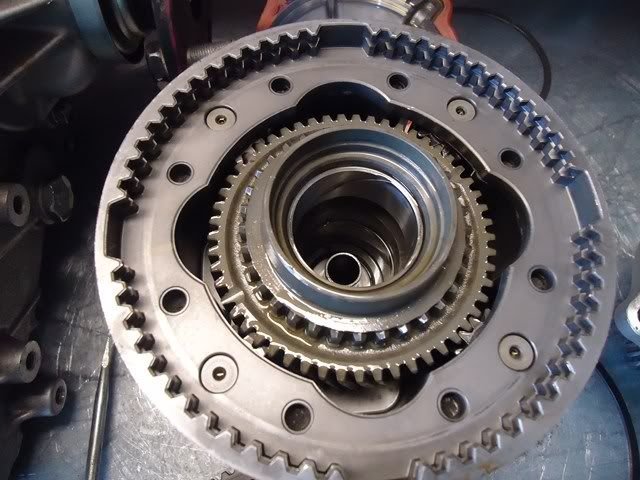

    Now, when you swap in the six speed planetary gear set into the automatic FJ case your going to need to change the rear ring gear in the planetary gear set or the hi/neutral/lo shifter will not work properly. Following is what you'll need to do for this swap.
    Here are the two planetary gear sets side by side. the one to the left is from the automatic and the one on the right is from the six speed.

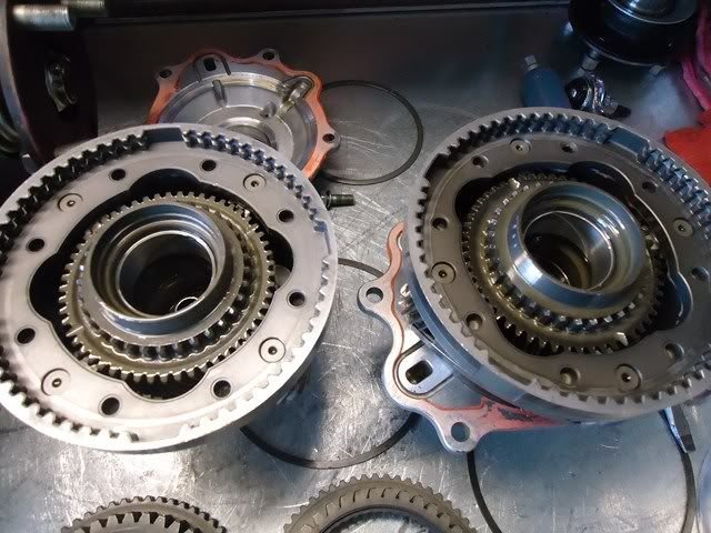

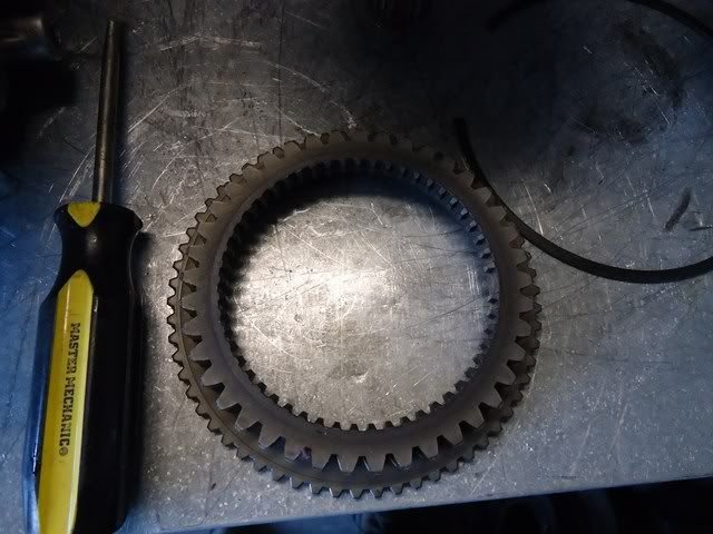

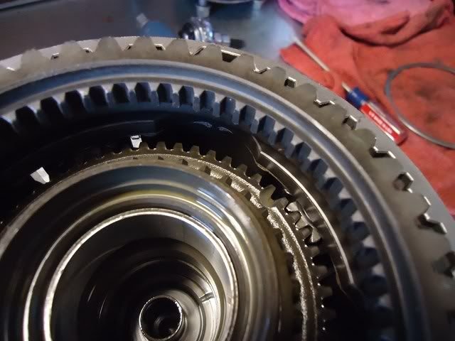

    In the next two photos you can see the big gear. The inside teeth on that big gear are flush on the automatic case but they are stepped down on the six speed case.
    The first photo is the automatic and the second photo is the six speed.
    There is a big c clip that holds this gear in. You take that c clip off and out comes that ring gear.
    This is the gear from the automatic case. Notice that the teeth on the inside are flush with the ring.
    Here is the planetary gear set without that ring gear.
    Both planetary gearsets side by side. These internals are identical between the two.

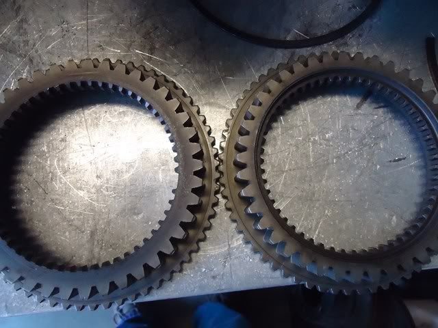

    These are the two ring gears side by side. If you look close you can see the difference between the two.

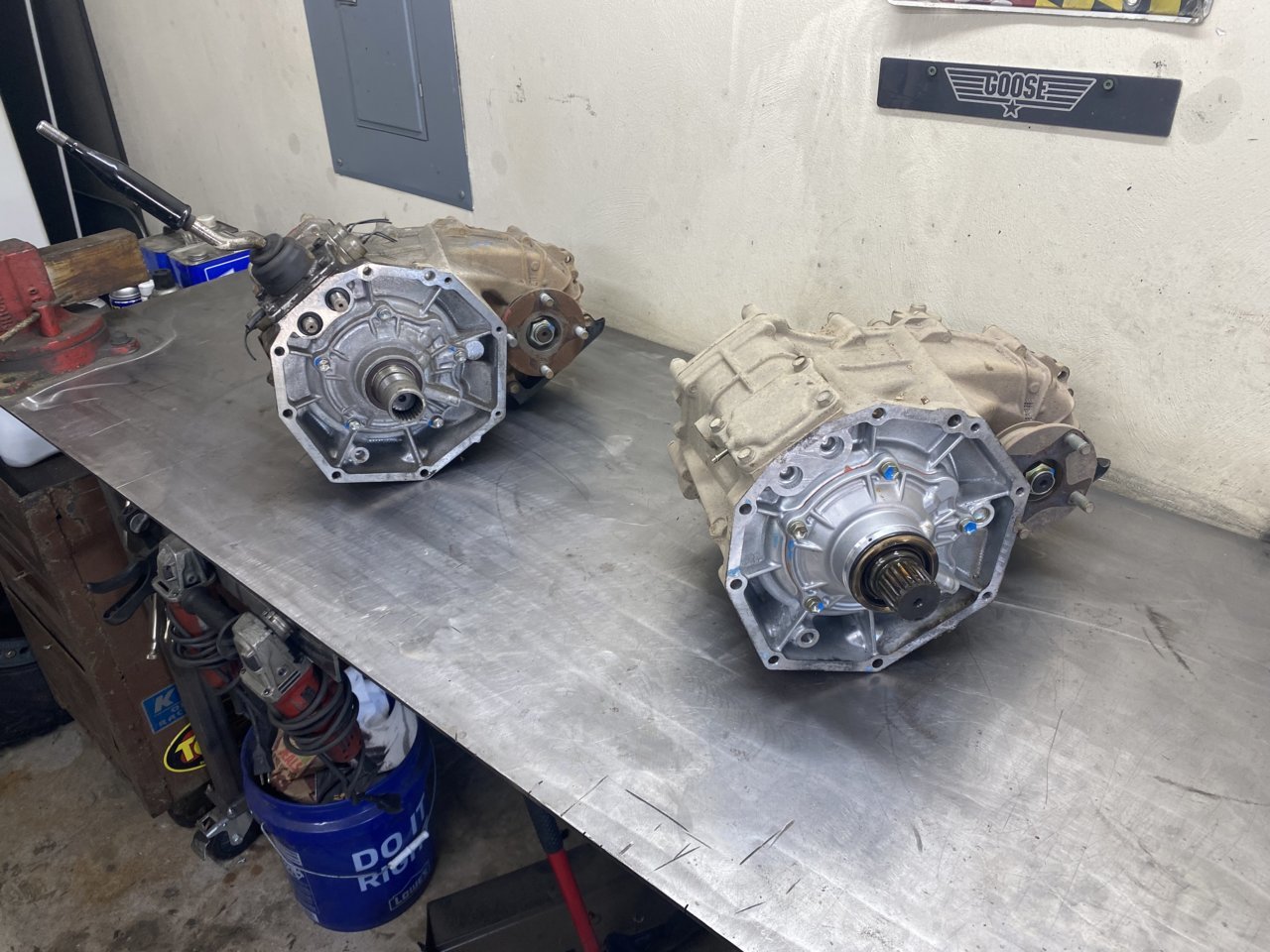

    In this pic, the case on the right is out of my truck. Notice the O ring on the cover around the input shaft.
    I reused the FJ cover, which doesn’t have the O ring. Leaked a bunch of trans oil.
    So I would also like to add to make sure you reuse your cover with the O ring. I missed it because it wasn’t in the original write up and I wasn’t thinking.

    That'll do it. The A750F has a rear seal in the housing whereas the RA60F does not. I do remember when swapping my crawler in, putting the seal housing extention in thus negating the need for the O-ring. If you are strictly swapping an automatic FJ case into a RA60F 6 speed you will need that O-ring otherwise there will be no seal between the transmission and t-case as you found out the hard way unfortunately.
