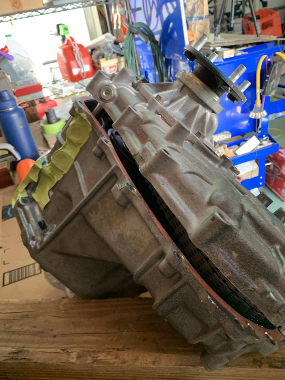

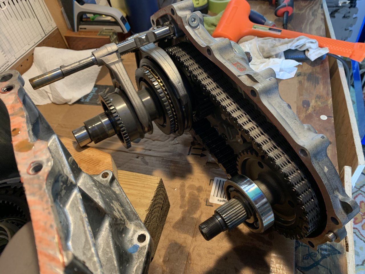

    There’s no need to remove that flange to separate the case. All you’ve gotta do is remove the front driveshaft output as well as the shifter and the 12 bolts but it sounds like you already did all of that.
    You can see in this pic how it looks separated, that front input shaft stays in place so no need to remove that seal/flange thing.
    I guess just keep wiggling and prying until it comes apart?

    I think his question is just “how do I get this case apart?” Because it’s not coming apart even with the correct stuff removed, i.e. bolts holding case together, front driveshaft flange and shifter.

    Got it! Had to stand up on the work bench and lift up.... too heavy to wiggle out I guess...
