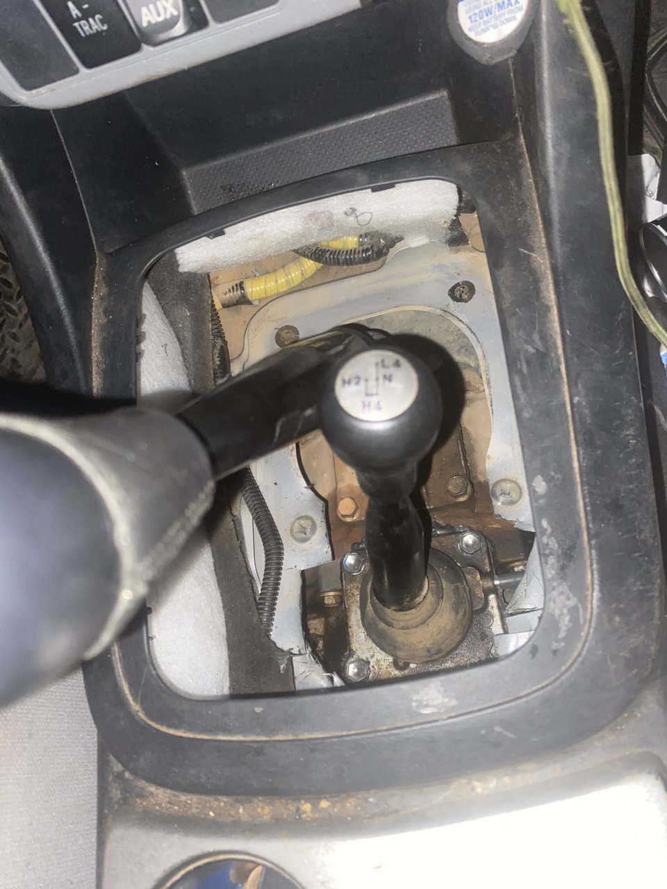

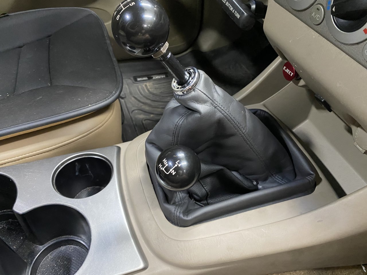

    How did you do the leather shift boot for your shifters, I’m trying to figure out if the Toyota boot will work or if I need to make one
  2. Jul 3, 2022 at 7:52 AM
    #82
    EatSleepTacos
    EatSleepTacos [OP] Well-Known Member
    Mar 24, 2015
    #151688
    59,842
    Randy
    West Valley, AZ
    2017 4Runner
    There’s a whole lot of examples in the below thread. Me, I got a generic boot off of Amazon and “sewed” it into my stock boot. Aka poked a few holes and zip tied them together.
    https://www.tacomaworld.com/threads/lets-see-your-fj-case-swap.455278/
    https://www.amazon.com/dp/B07S68934W?ref=ppx_pop_mob_ap_share
    dborrer and Littles like this.

    I’ll probably take your route with it just needed an idea/

    The price/effort to finished product ratio is hard to beat imo. $15 and some zip ties and it looks factory at a glance.

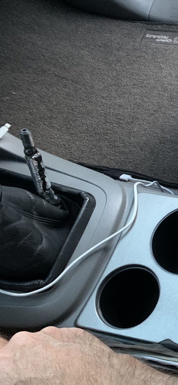

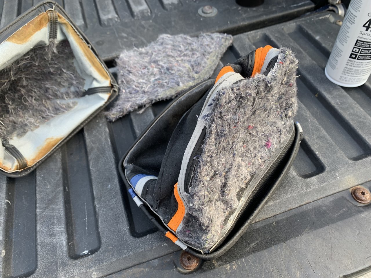

  6. Jul 3, 2022 at 5:45 PM
    #86
    dborrer
    dborrer Well-Known Member
    Apr 28, 2018
    #251944
    550
    Mr. Dan
    St. Augustine, FL
    2006 Tacoma TRD Sport 4x MT
    2018 new Frame (thank you Rust!), FJ T-case swap. SPC(LR) UCAs, Bilstein 5100s front - rear, OME 883 at 0, HeadStrongOffRoad 3 leaf progressive AAL, MESO custom 2nd gen (Red/White) LED dome & Ultimate Maps, Spyder Halo Projector w LEDs (which SUCK), Spyder LED tails

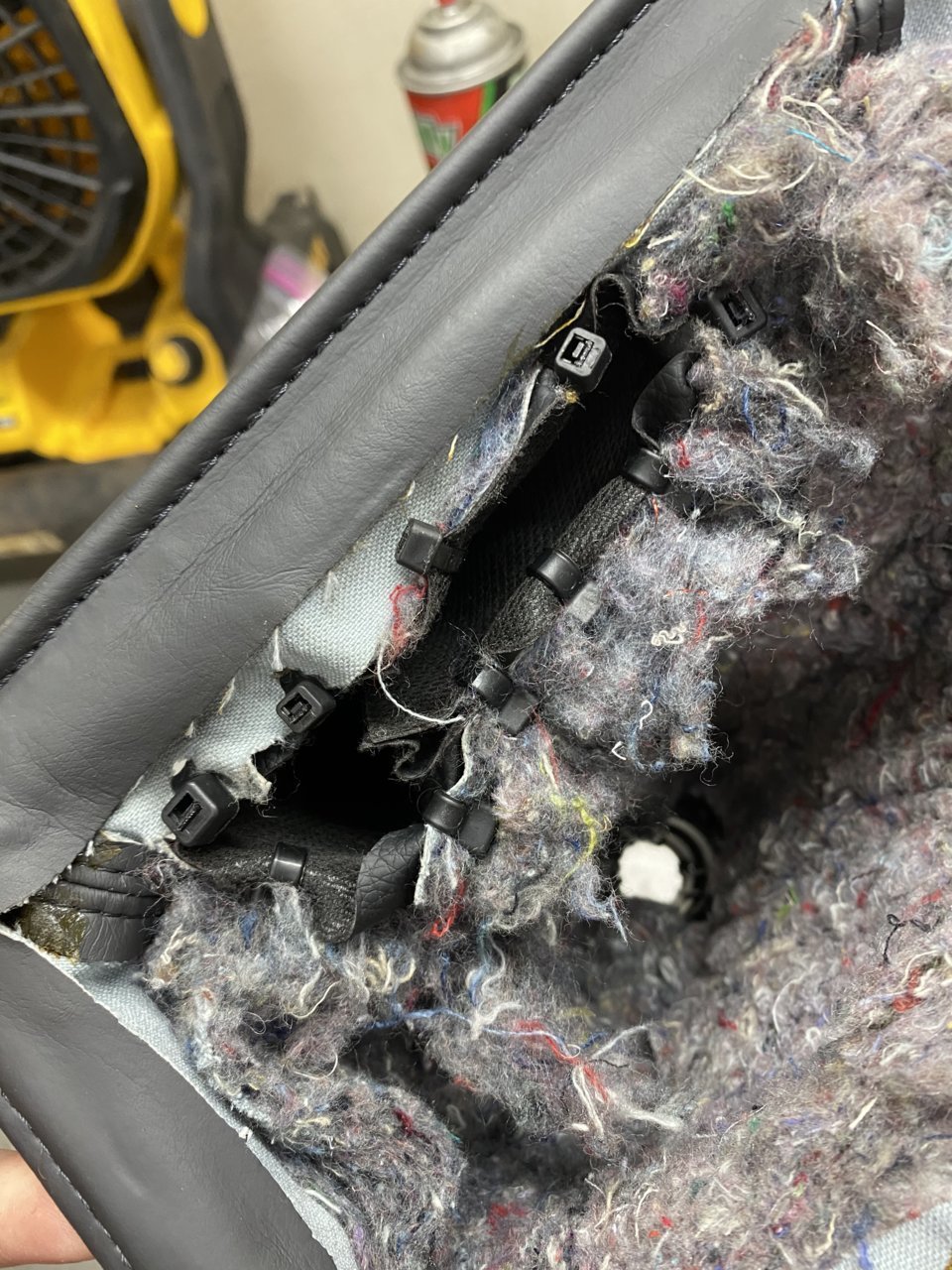

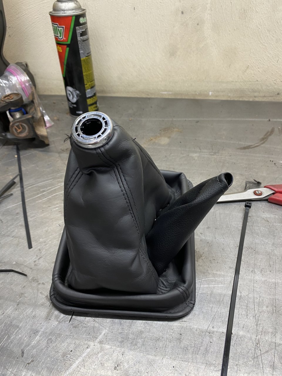

    https://www.redlinegoods.com/Tacoma05shiftboot.php
    I ordered a custom boot from them, and it took multiple emails to get the measurements correct, and it did take forever (but it was actually had made in Poland....).
    I also pulled out my insulation from my OEM boot and added to the new custom boot... got to mod new stuff!....
    During the wait/order time, i did as EatSleep did below, without the added on boot part.

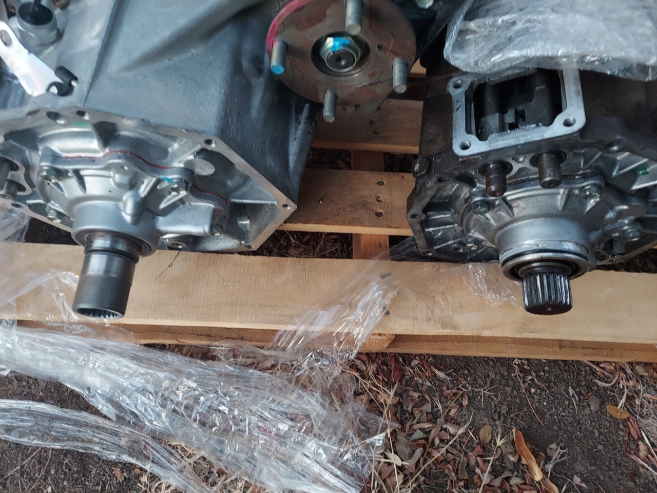

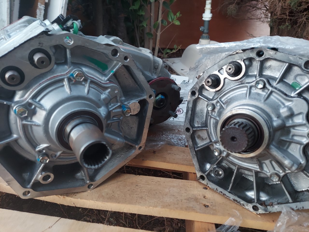

  18. Sep 16, 2022 at 5:51 PM
    #98
    BzWires
    BzWires Member
    Apr 29, 2011
    #55771
    20
    Oakland
    07 FJC TRD-SE
    King Shocks @ all four corners BozTec Diff Skid and Ant Mount

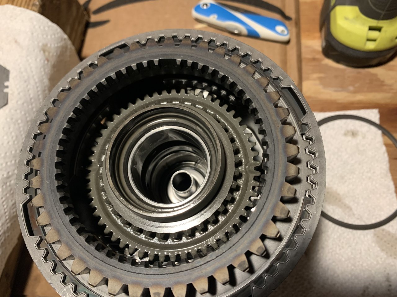

  19. Sep 16, 2022 at 5:53 PM
    #99
    BzWires
    BzWires Member
    Apr 29, 2011
    #55771
    20
    Oakland
    07 FJC TRD-SE
  20. Sep 16, 2022 at 5:57 PM
    #100
    BzWires
    BzWires Member
    Apr 29, 2011
    #55771
    20
    Oakland
    07 FJC TRD-SE
    I guess I'm going to have to pull the full-time tcase apart and see what I can figure out
