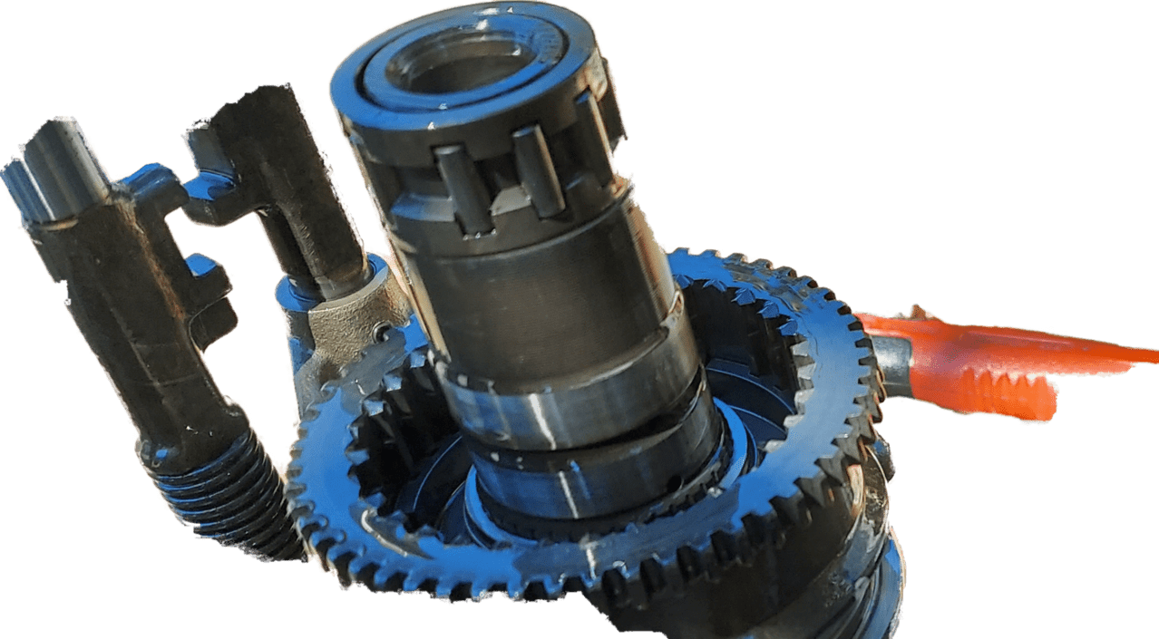

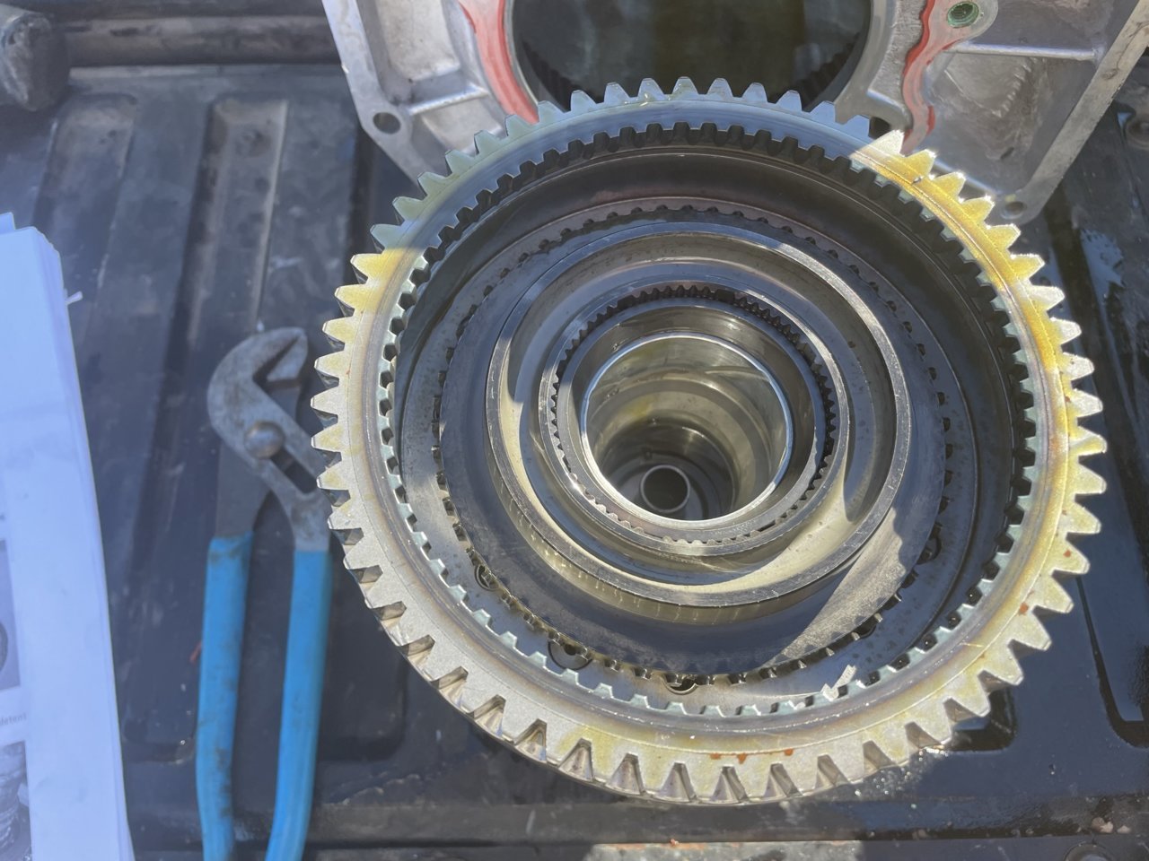

    Here’s a pic of the AWD input shaft on the back side. It’s larger than the one on the part time case

    I'm assuming that gear isn't able to be swapped for the one on the AT tcase?

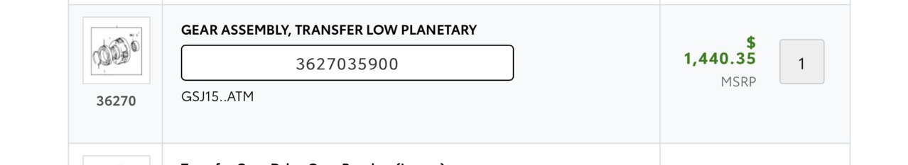

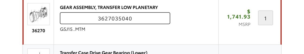

    I believe the planetaries are a little different (part #s below). The Tacoma t-case input is going to be the bolt up solution and make things work for sure. I would try to hunt one of those down.
    manual
    auto
    BzWires[QUOTED] likes this.

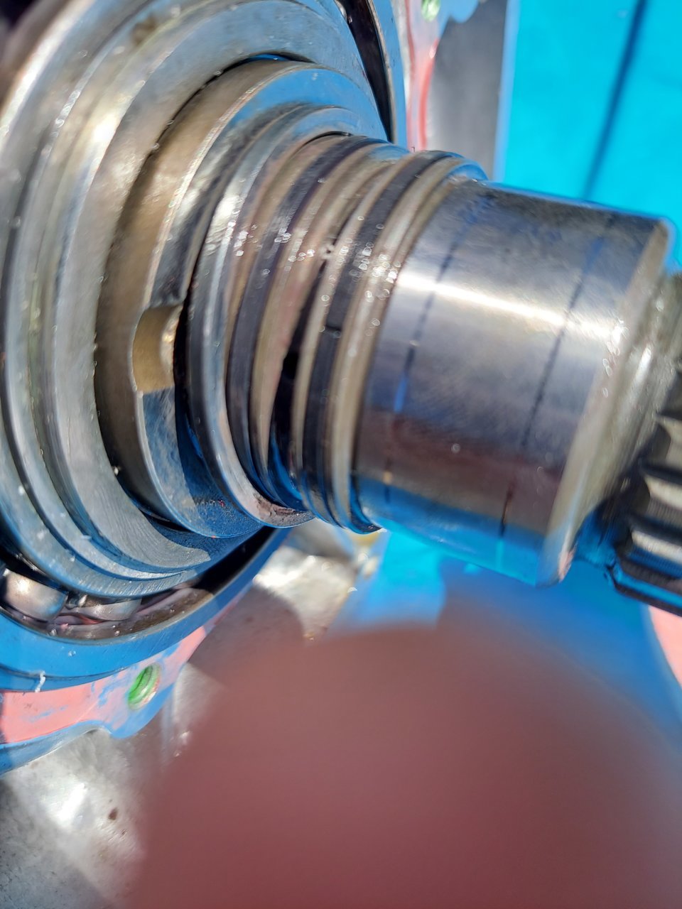

    I want to thank all y'all for your help without this thread I would have been lost. I broke down the donor case and swapped the input shaft fairly quickly with only a few hiccups along the way. I also forgot how much I enjoyed wrenching & how much I hate scrapping gasket surfaces. Pics and write up to fallow

    This little guy is pita and I used a bunch of assembly lube to get it to stick together

    I found a cir-clip had gone for a walk and had to encourage it back into place

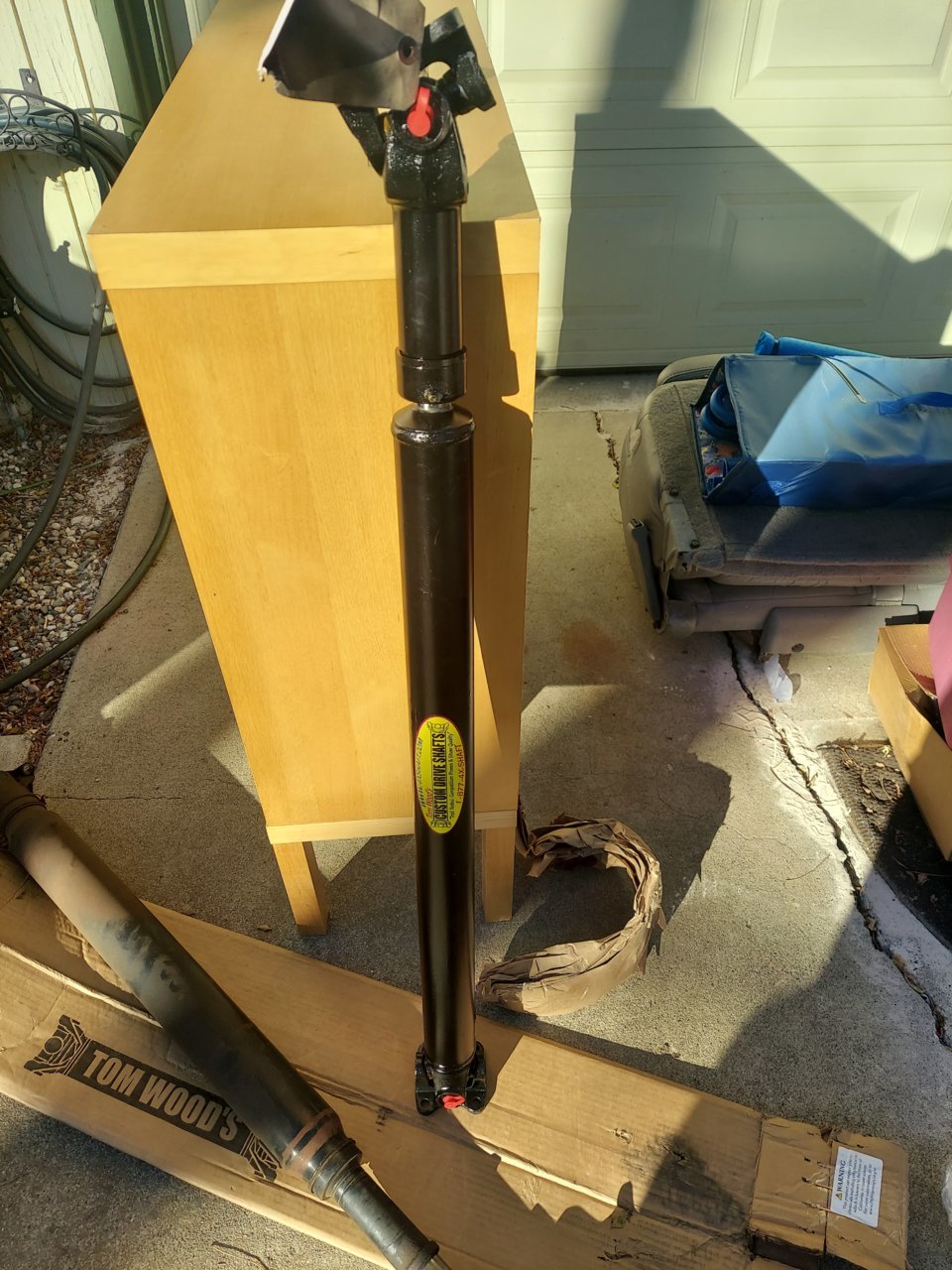

    The FJ is alive and moving under its own power! In 2wd! Thanks again for all the Information and help. I just took a quick lap around the block, now I have to wait for the front diff to be rebuilt
