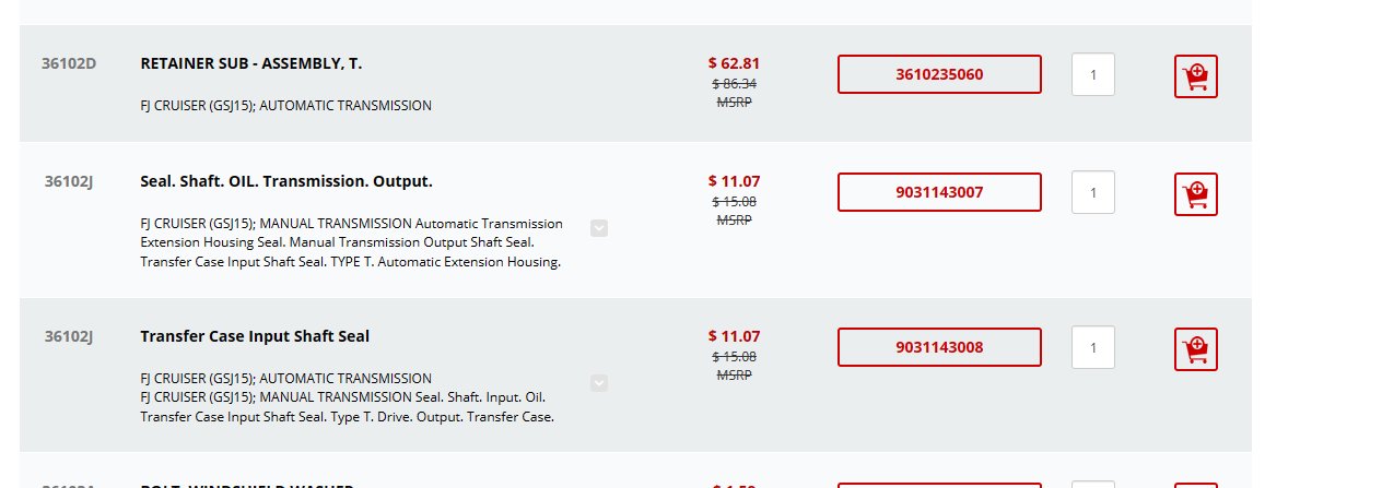

    Can anyone confirm the part number for the manual trans/transfer case input shaft seal?
    It's not clear to me from the diagrams whether it's 90311-43007, 90311-43008 or 90311-43021. Or is it both 007 and 008 that I need to order?
    This diagram includes the o-ring (96721-35063) so assuming it's the correct diagram for the manual trans t-case input shaft assembly.
    But then goes on to list two part numbers for the seal
    Am I right in assuming there are 2 seals here?

    I finally got the seals from Toyota Overstock (20 days from order to delivery! Not stoked)
