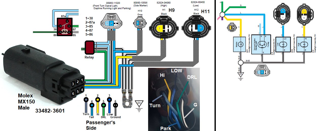

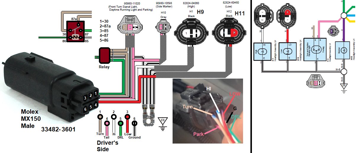

    @moon22 what you want to do is possible. It isn’t super straight forward as pointed out by @caribe makaira but it is possible. If you want the DRL amber, then we could build something with a switchback controller. If you wanted the DRL to be white, with Amber turn signals, then you might be able to get away with just a switch back. If you’re serious about the swap, let me know, I can make it happen. I like to imagine a tear running down @daveeasa cheek every time I build one….

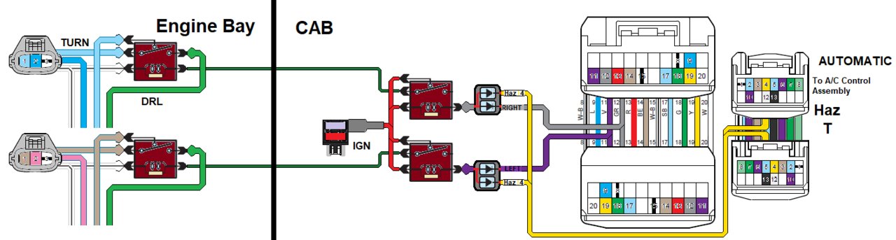

    Maybe this:

    A pair of 18awg from the added relays in the cab to the added harness relay (pin 86) Post #28. One wire per side. Relay can be mounted on fender (like @Puppypunter SR solution module)

    Yeah, it can be done, no permanent changes. The biggest issue you run into on these type of swaps is the ground. The LEDs only have one small ground, so we’d need to ground to the body as well. There are bolts right by the headlights for this. Other than that, it would be a tool-less install, all plug and play. Shoot me a PM and I can price it out for you.
