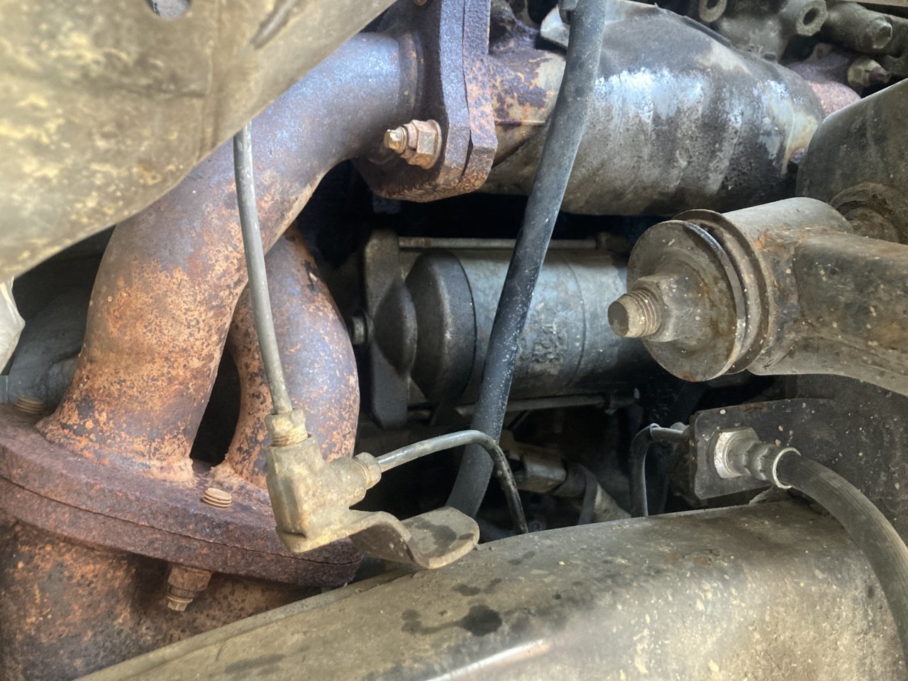

    I wish you could see what I’m looking at… there is a fuel line and break line in the way of getting it out the side

  12. May 31, 2023 at 2:13 PM

    I just carefully bent the brake lines to make room for starter to snake thru the passenger side. Tire must be taken off.

    What about the fuel line?

    Isn't that the transmission dip stick tube?

    Whatever it is it’s welded and inflexible

    Yes it is.
    Single 10mm bolt holds it and I've removed mine whenever I needed to pull the starter.
    I'd replace the o ring that comes from the bottom of that dipstick tube as well.

    It's not welded, and not meant to be flexible.
    You have a 2-piece transmission pan and that piece is the dipstick portion of it.
    It slides into a small portion of tube that extends upwards from the transmission pan.
    And o ring is all that prevents from fluid from seeping out between the two parts.

    Okay I have the break line and transmission line out of the way but still can’t get the bolts off lol
