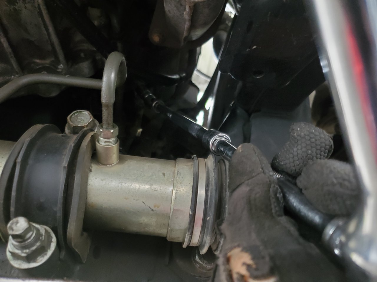

  9. May 31, 2023 at 3:26 PM

  11. May 31, 2023 at 3:28 PM
    #31
    newoldstaco
    newoldstaco [OP] Well-Known Member
    Jan 11, 2021
    #352422
    91
    I can’t budge the bolt lmao fuck this shit

    You realize that's a manual right?
    Everyone that says this job is super easy either - owns a 4x4 manual, owns a 4x2 auto, or 4x2 manual.
    The most difficult configuration is a 4x4 auto, but even that is easy. Just a little tighter in terms of access.
    Bivouac likes this.
  15. May 31, 2023 at 3:33 PM
    #35
    Kwikvette
    Feb 27, 2019
    #284735
    81,740
    Fresno County
    4 run, 2 don't
    The picture I just posted :rolleyes:
    4x4 automatic, it's how you can gain easy access and get a socket directly onto the bolt without stripping it.
