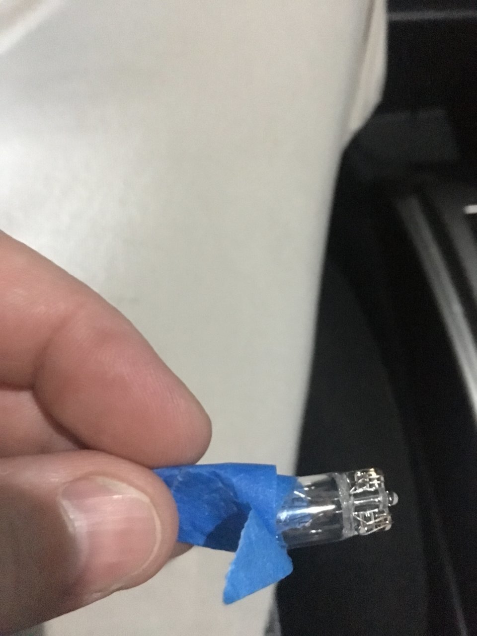

    The front two over head console lights are 194’s

    Thanks! @Babybluetaco, do you know what the dome lights are also? Have you done this to your truck?

    Not right off the top of my head I don’t. And yes I’ve swapped everything to led. Front to back
    Two front interior lights are 194 base as well as the tag lights corner lights reverse lights and the third brake light bulbs all take a 194 base led
