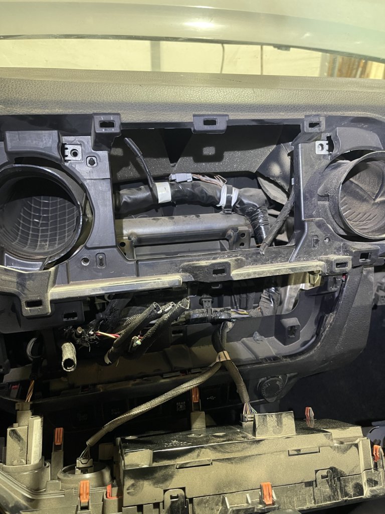

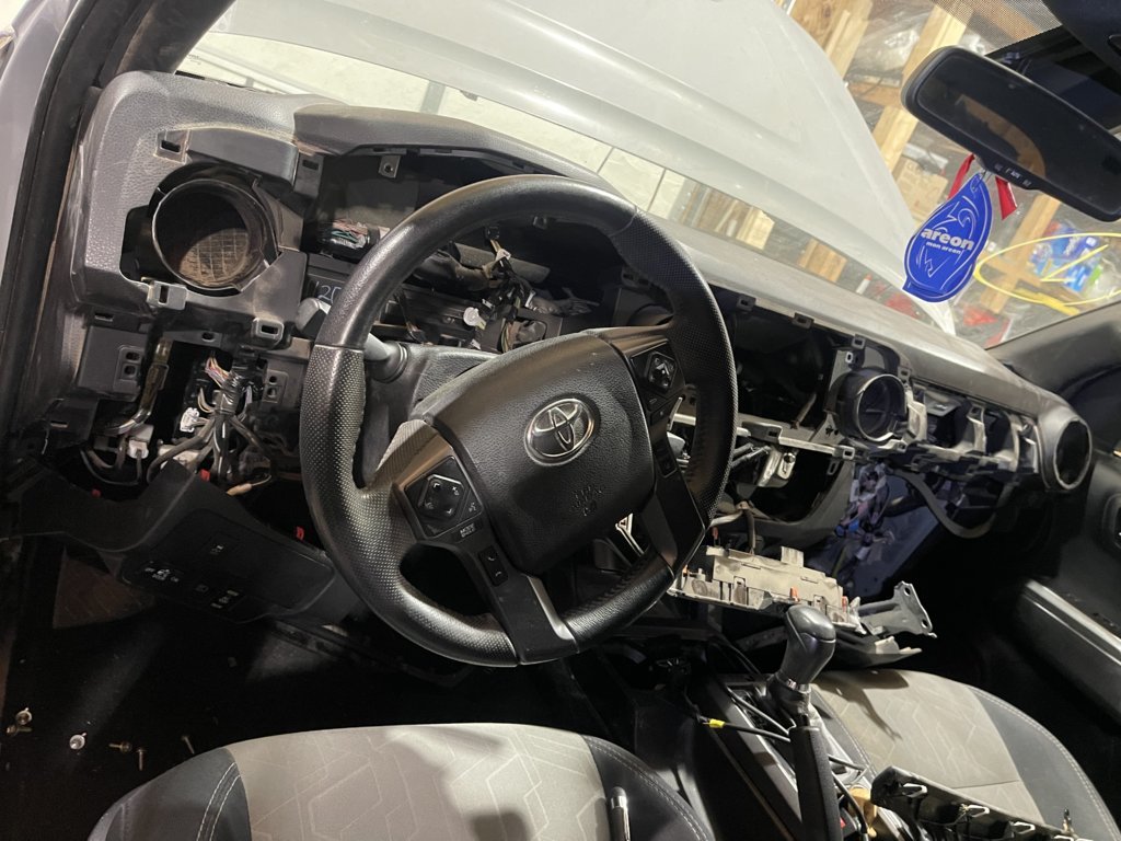

    upload_2025-5-20_15-9-18.jpgHaven’t gotten too far. This is where I got stuck on
  11. May 20, 2025 at 1:14 PM
    alexns7777
    alexns7777 [OP] Member
    Tuesday
    #471472
    8
    xander
    2021 Toyota Tacoma TRD sport
    Is the dash being held by anything from the exterior? I’ve already broken a bunch of snaps trying to take it off from the inside. This thing is a pain

    There are no screws holding the dash on from the exterior.
    Based on what I can see, you're almost there.
    1. You need to remove the steering column cover, the steering wheel, and the turn signal/wiper stalks. It's pretty straight forward but you need to look at the airbag connector closely as you disconnect it. There's a part that pulls out half way and then it slides off. Make sure you battery is disconnected and wait a bit before disconnecting airbags.
    2. You will also need to disconnect the passenger airbag.
    3. Finish unplugging the connectors and get those control panels out of the way.
    4. If I recall, the rest of the dash is held on by screws that are along the bottom of the dash.
    5. I'm not sure if it's strictly necessary, but I also removed the A pillar trim. Just 1 bolt on the driver side, 2 on the passenger.
    Once you get all the screws out the dash practically falls out. There are 5 self aligning pins at the top that keep the top of the dash aligned.
    Some things you should do to your dash while it's out. There is a bunch of stuff mounted to the underside of the dash, I think 2 electronics modules and your vent/defroster plumbing. I'd take the time to retorque those screws as mine were loose and it contributes to rattles under the dash. I took my interior apart mainly to apply sound insulation/deadening - it's also a good opportunity to do that if you are inclined.
