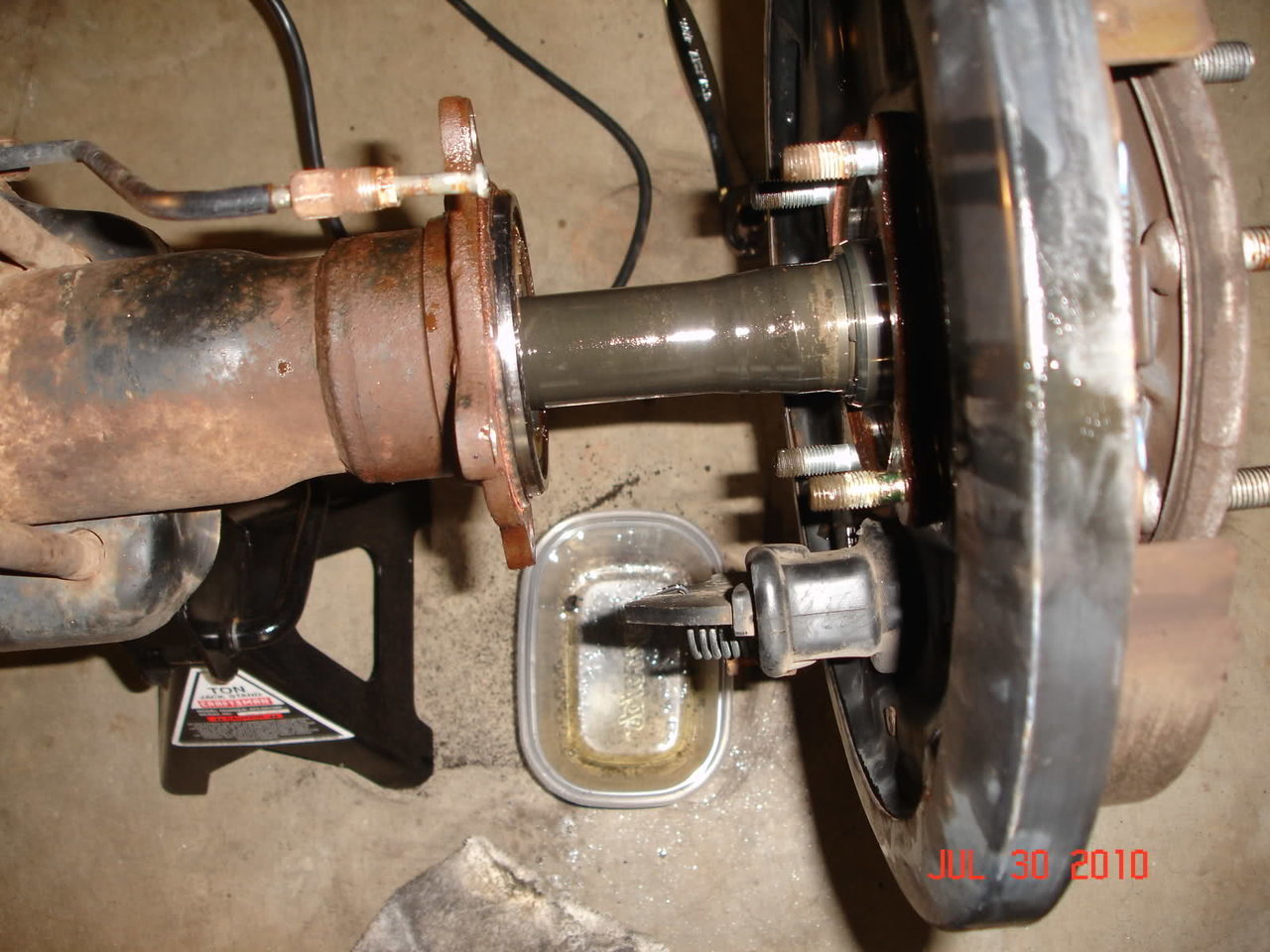

    That really thin paper can be a bitch. Smack the bottom of the diff near the 4 bolts that you disconnected from the driveshaft.
    That paper gasket is like super glue.
    Here's how far I had to take mine out till it came loose.
