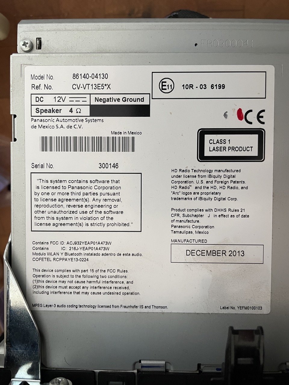

    I've pulled the (fully operational) stock non-JBL head unit from my 2014 AC 4.0L 6MT Tacoma and put in a nice 9" JOYING® aftermarket unit that has more features and sounds better.
    I plan to sell the stock non-JBL head unit on eBay; they're going for at least $150-$250.
    Are these head units "locked" to the vehicle's ECU/immobilizer in any way? Can the stock non-JBL head unit just be plugged into any other (compatible model year) Tacoma and work normally, or will it require some kind of "unlock" code before it will operate in a different Tacoma?
    The head unit's Toyota part # is: 86140-04130.

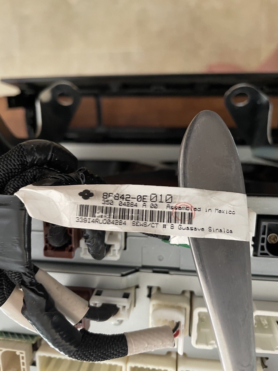

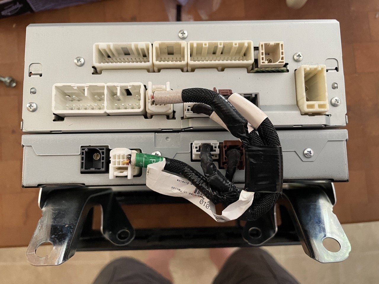

    I can't speak to compatibility with your truck. The best I can offer is clear documentation of exactly what this unit is, you'll have to DYOR as to whether it will work in your truck. It was a working pull when I removed it. Note, I bought the truck used (from 1st, original owner) at 60K miles. I have never (not even once) tested the CD player so I don't know if that works. I would guess that it does since the 1st owner took pains to disclose anything and everything that was wrong with the truck when he sold it to me.
    Here are photos of the back & top of the actual unit I plan to sell:
    zWeb_002-2023_07_11-10_56_21.jpg zWeb_001-2023_07_11-10_55_38.jpg zWeb_003-2023_07_11-10_55_29.jpg
