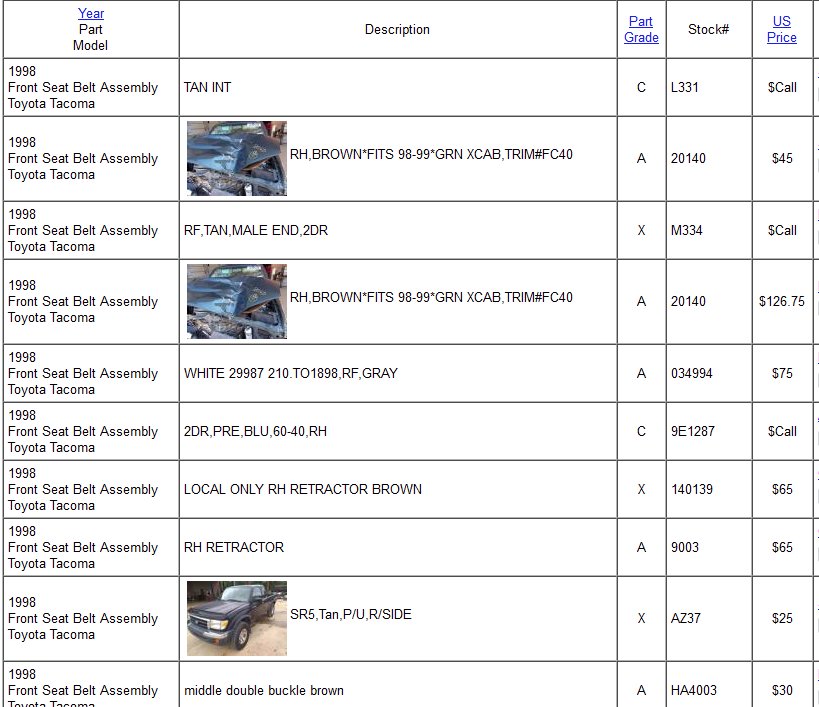

    How'd you search? I found plenty of them. Because the listings are sometimes a little vague and unclear, you'll probably want to call to confirm that they're offering the exact thing you need.

    As you can see, prices vary quite a bit as does I'm sure the quality and condition of the belt.
