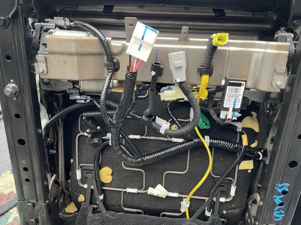

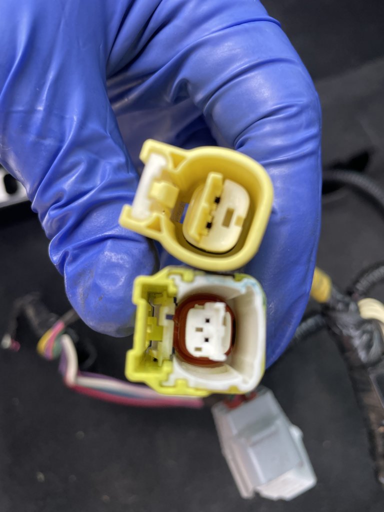

    Hope you don’t mind me reaching out but I’m attempting a 2021 Tacoma power seat swap into my 2015 and I just wanna make sure I’m not screwing anything up.
    Drivers seat I have the seatbelt receptacle transferred over, and also the position sensor. Passenger seat, the weight position sensor is plug and play which is amazing. However the yellow airbag harnesses are sadly slightly different and are not plug and play. They both do however have a yellow + yellow/black wire. Am I safe to cut off my old harness and solder in the new male harness for the 2021 seat? Will the abs system work the same in the 2021 seat with the yellow + yellow/black wires from my 2015 or should I just use a resistor bypass on both harnesses on the driver and passenger? Here’s the a photo showing the 2015 harness vs the 2021, and also the 2021 driver seat with the receptacle and position sensor transferred over.
    Basically, will the air bags in the 3rd gen seat even work with my 2nd gen Tacoma? Or do I need to use the bypass resistors on both seats, and thankfully since I have the weight position sensors in the passenger side I don’t have to worry about an abs light? Any help here is hugely appreciated.

    Don’t cut the plug off. Simply depin the plugs and swap over if the pins are the same and hopefully it works just fine. This is the way I’ve done my FRS seat swaps.
    usually the white inner piece pops out to unlock the pins or along those lines. May take a minute messing with it.

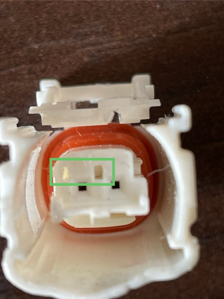

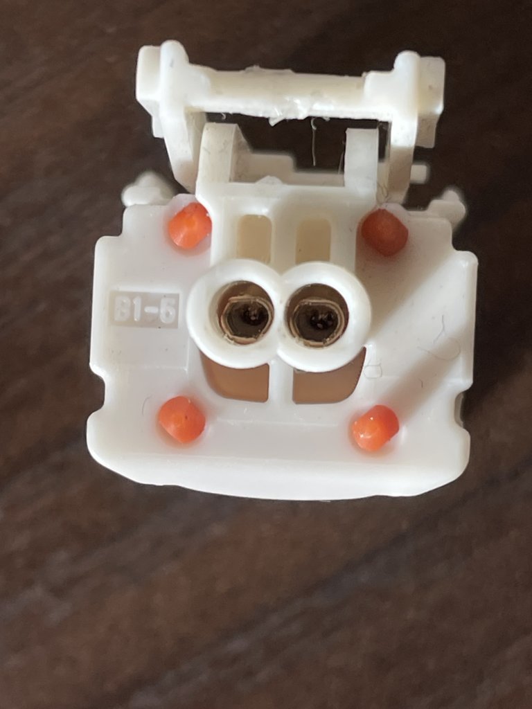

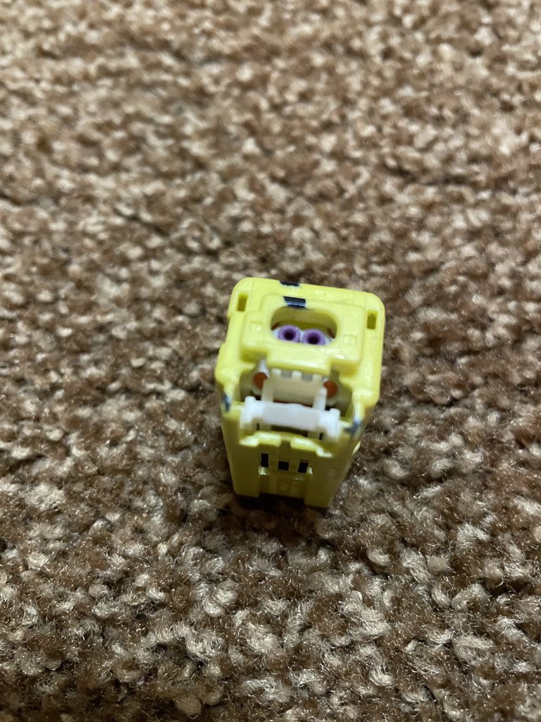

    That makes sense. Were you able to depin and repin your harnesses easily? I figured out how to get the inner housing out but I’m struggling to even see if these metal pieces are remnants of the old pin or just receptacle pieces. I’m assuming these holes are what I would use to release the pins. I guess at this point I’m reassured the airbags in the new seats WILL work but I’m concerned about breaking the harness or pins on the factory harness as opposed to just using a resistor.

    Hard for me to tell what exactly that is. Looks like the terminal pins were ripped off the wire. But this would be obvious as you’ll have bare wire left behind.
