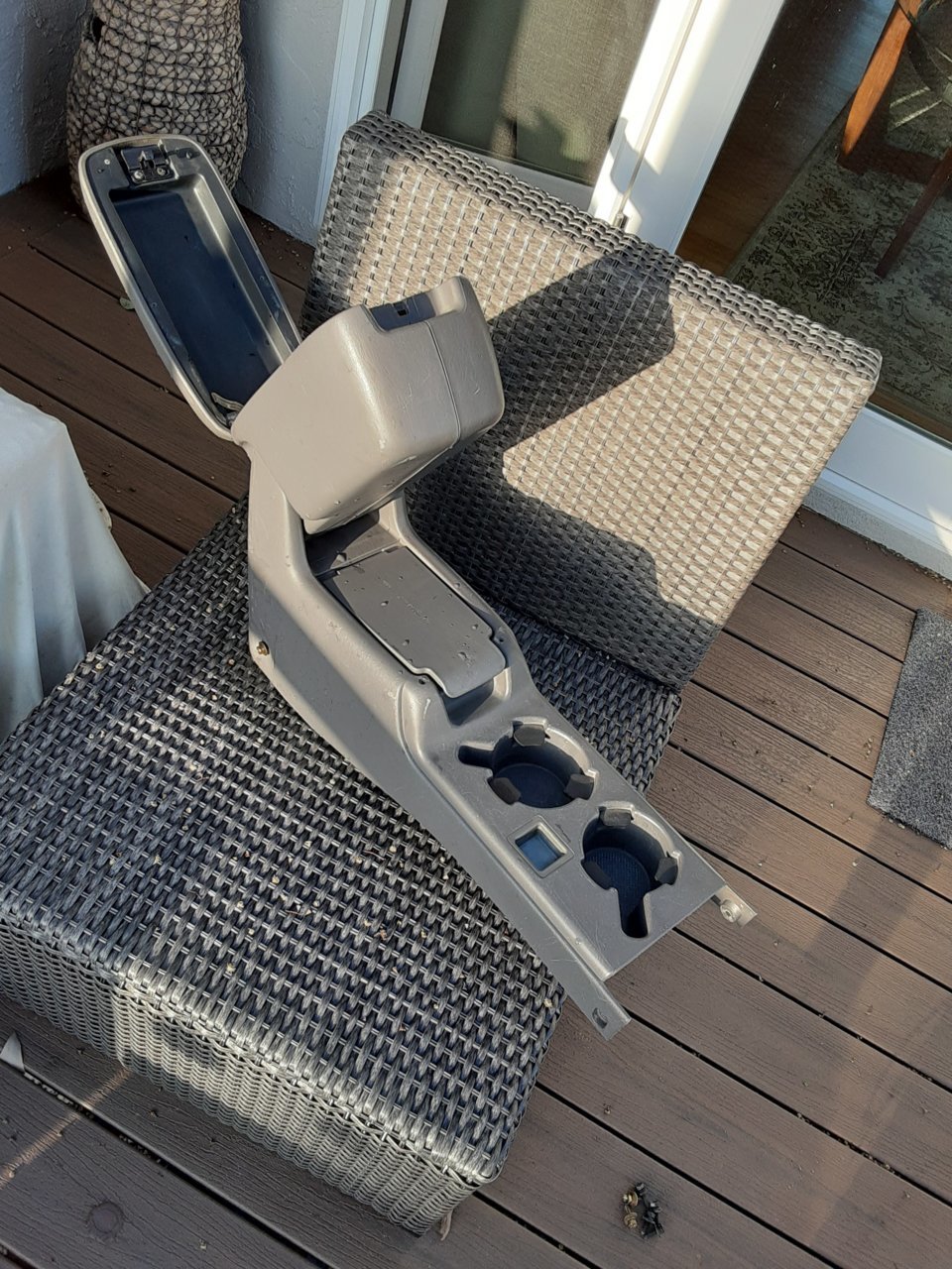

    Got the console at least today from junkyard. They said it was from 2004, Now I just have to find a seat. Love all that new storage

    You shouldn’t have any drama installing the console, if the original brackets from your square cup holder console are there- just 1 in the back, you should be golden. That is a pretty clean console, good score.
    GQ7227 likes this.

    Thanks BTW! Yea washed it up good and only some minor scratches on there. May order the oem top latch part because it's little worn. Also got all the hardware, and there is a bracket for the the most rearward bolts I was able to score off the donor truck.
    Artictaco: Thanks, only 40 bucks too! Is it basically the same install as Blue92's write up then?
