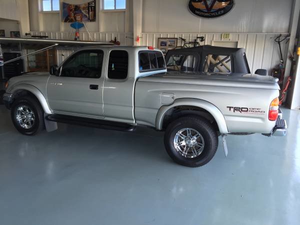

    Here's a before how she stands now.

    Vantaco, the ends of the bumper just unbolt, and yep there's a regular bumper. I think I have a shot of it (trying to sell as TIPICO said). You can see them beside the tailgate.
    Here you can tell where I took them off.
    You can also notice here where the plastic cover of the bumper is too short, this is what you'll need to find. I got a whole brand new bumper from a yard, took the plastic part and am selling the rest of the bumper.
    Dennis, believe it or not this is a brand new frame. It likely looks older because I had it undercoated, and I 4x4 alot so there is a tone of dirt stuck to the oil that is on the frame. Trust me it's nice and shinny black under there.

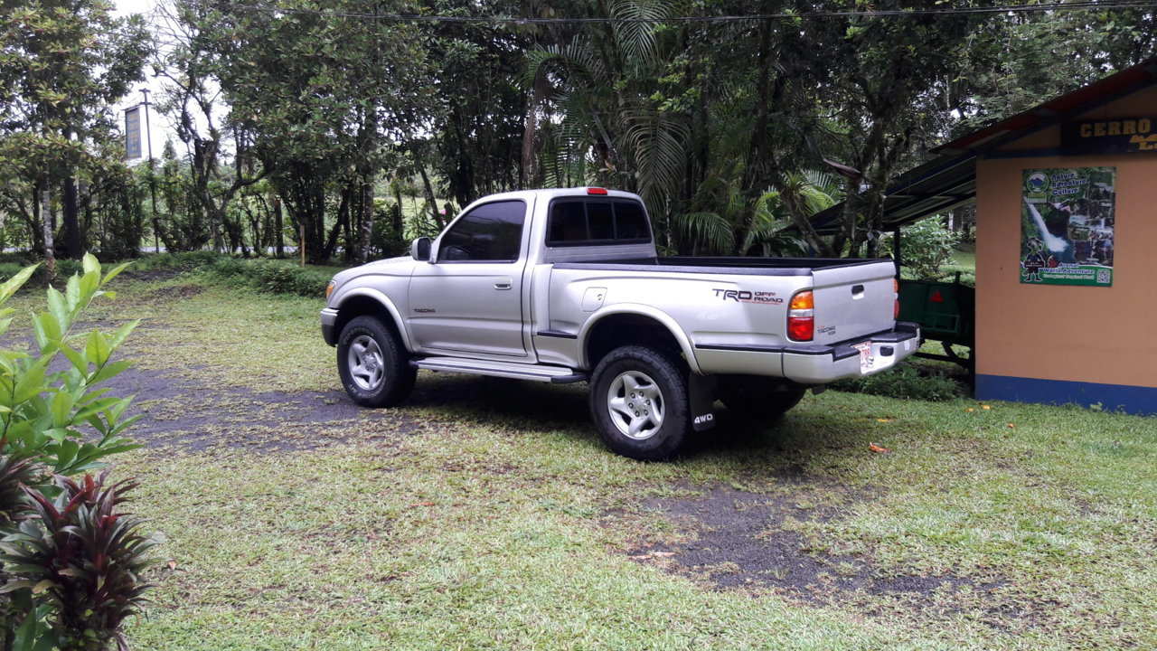

    Wish mine was a stepside/sportside - love the way they look!04 Tacoma.jpg
