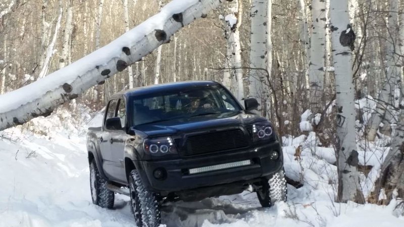

    20161225_121829.jpg :D this is where im at so far except i finally ditched my step bars...

    you will rub with with those tires regardless of lift if you actually flex your truck.
    but yes, the rear 16 springs are essentially the same as the 3+1 leaf pack found from the TSB.

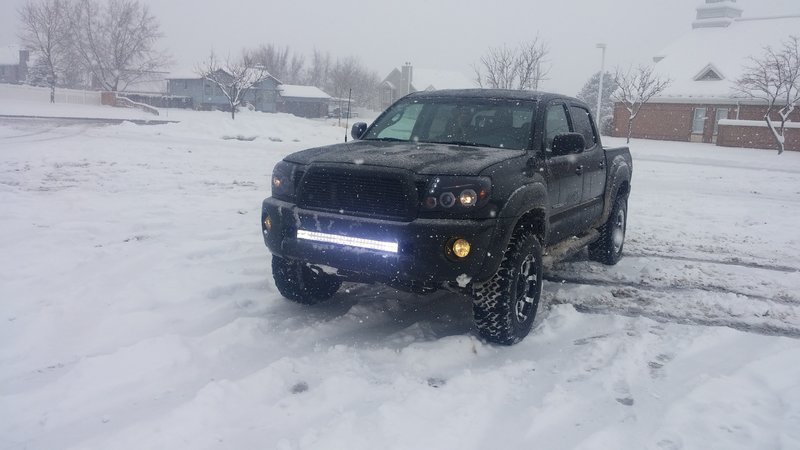

    FB_IMG_1480724596268.jpg Havent done a whole lot of flexing, just minor affroad use. But because they're skinnier tires, i litterally have not rubbed one single time. It must be like a perfect storm i managed to accomplish. 17" rims with 4.49bs and +19mm offset. 255/75/17 bfg km's. been running this setup for 15k miles.

    Your tires aren't much bigger than a 265/75/16 so it makes you aren't rubbing, and especially so if you have removed mudflaps.
    Anyway, if you put on a 3rd gen suspension please take measurements. I was debating picking up front susp from a 16. I am looking for a very mild/relatively inexpensive yet OEM lift.

    I will take some measurements for you for sure! But keep in mind i will be running a leveling kit with this setup so it will be different from just a straight swap. However i will do a before and after measurement so you can see the difference. 255/75/17=(exactly) 32x10x17 i think a 265 is only about a 31.5 so about a half inch taller. But they are, i believe, a 10.5 wide. Dont quote me on that.

    AHH ok those looked like 285/75R16's (or that size) 255's yeah you should be fine.
