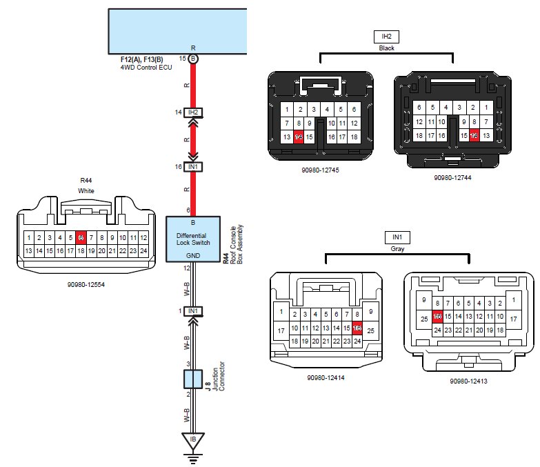

    I just grabbed the new trail edition and for some reason they put the diff lock button on the upper console. I would really like to move it down to the left side console where it belongs. Any help on that would be appreciated.

    It's been done, red wire to switch (new location) then to ground.
