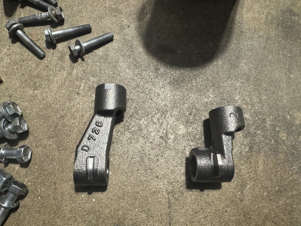

    • 31236-0K050 - Release Fork Support (Fork Pivot Ball)
    • 31204-35100 - Clutch Release Fork

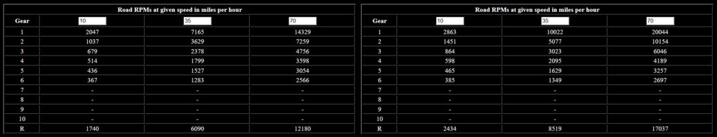

    The digits in the model code denote the gear ratio sets they contain, which are different in each.
    60:
    1 - 4.7847:1
    2 - 2.4238:1
    3 - 1.4431:1
    4 - 1.0000:1
    5 - 0.7775:1
    6 - 0.6439:1
    R - 4.0669:1
    61:
    1 - 4.7847:1
    2 - 2.4238:1
    3 - 1.4431:1
    4 - 1.0000:1
    5 - 0.8262:1
    6 - 0.6439:1
    R - 4.0669:1
    62:
    1 - 3.9827:1
    2 - 2.0175:1
    3 - 1.3218:1
    4 - 1.0000:1
    5 - 0.8488:1
    6 - 0.7132:1
    R - 3.3853:1

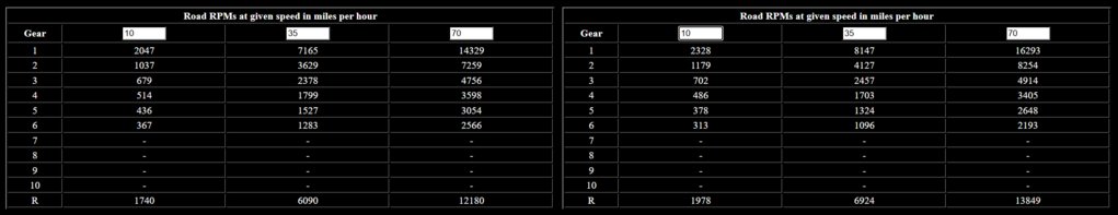

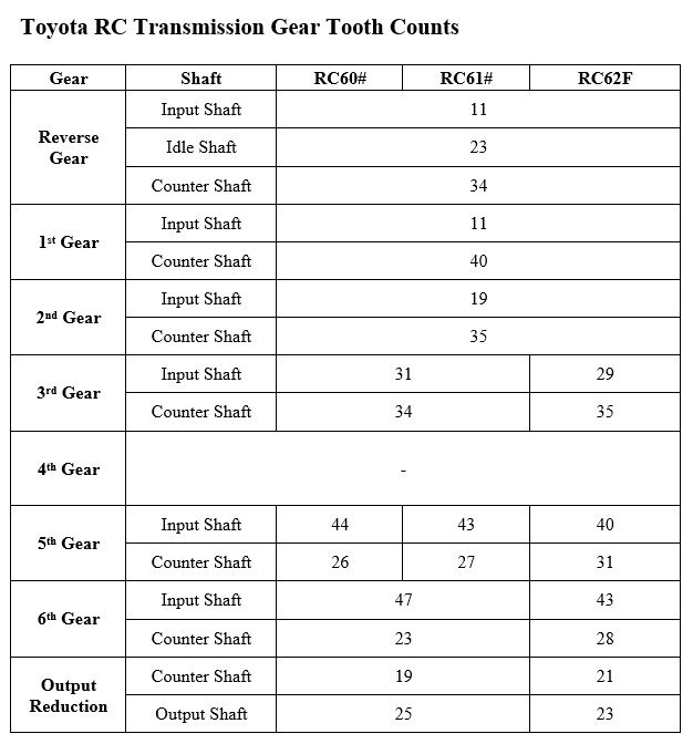

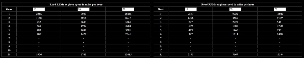

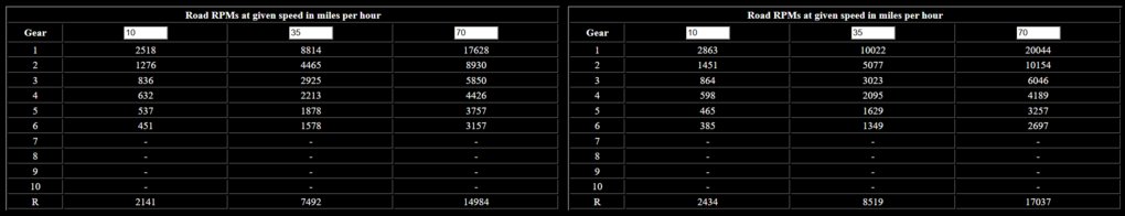

    And just for fun, here is a neat gear tooth count chart generated by @Jeff Lange comparing the differences between the 3 gear ratio bundles:
    So why does anyone want this transmission?

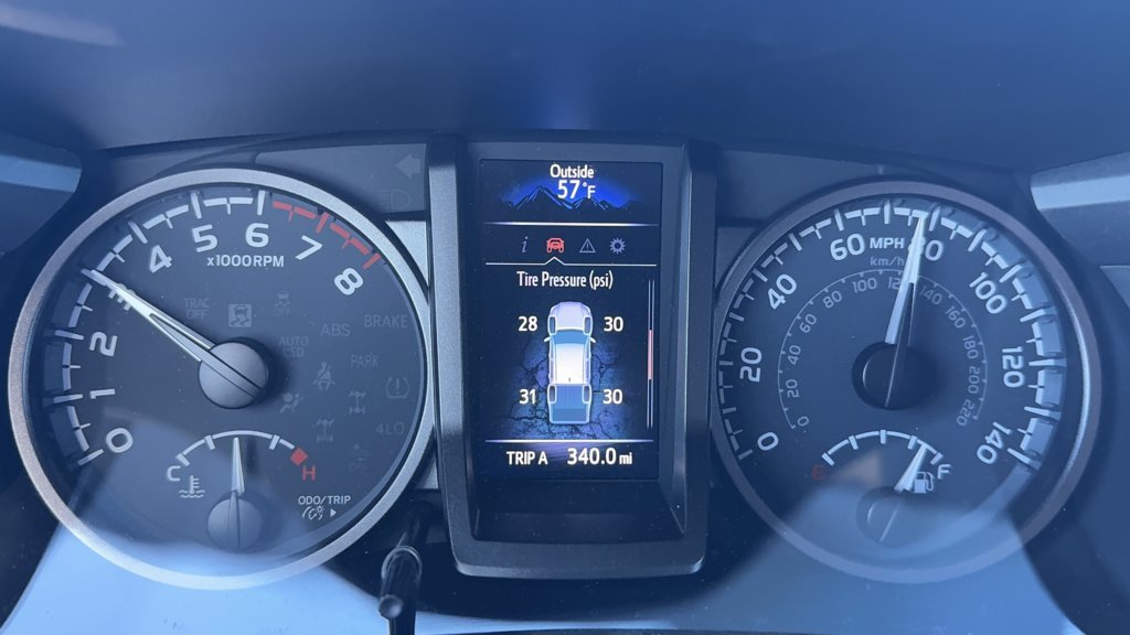

    The only benefit to the RC60/61 series as opposed to the stock RC62 series transmission is the different gearing they offer. All models are capable of the same torque, etc. There are no real build differences, the differences are really just gearing when you get down to the internals. I think it's pretty clear why the RC60 or 61 models are more desirable from a gearing standpoint.
    The RC60F is a wider ratio box, which is why it comes behind diesels and turbo gas primarily. As you can see, it has 20.1% lower gearing in R, 1, and 2. It has 9% lower gearing in 3rd. 4th is the same, and both overdrives are taller. 5th ends up halfway between stock 5th and stock 6th, while 6th is taller than any stock gear.
    This is beneficial on the low end. Lower gears mean easier acceleration. Lower ratio in reverse means more low-speed control and the truck not attempting to do 10 mph when you back out of a parking spot. The stock reverse gear ratio is stupidly tall, and this helps with that. 1st gear benefits from easier takeoffs, 2nd creeps at low speed more easily (parking lots at 5mph and such). 3rd sees minor midrange performance boosts. 5th and 6th drop the rpm which could be a good or bad thing depending on your preference.
    I had my truck regeared a couple years ago, to the 5.29 ratio. This means my gears are already 24% lower than stock. So, in my case, paired with this transmission, I actually receive a super low low-end (nearly 50% lower than stock, and my top end is about the same as stock, just a bit lower ratio. 2700 rpm at 70 vs 2450).
    To conclude, here are my main reasons why anybody would want this transmission:
    • to improve low end performance/low speed control/boost offroad crawl ratio
    • to drop the rpm at highway speed for potential mpg savings (theoretical, not always realized in the real world)
    • To help with towing and general acceleration in the low gears
    • For cool points or just to say you did something different

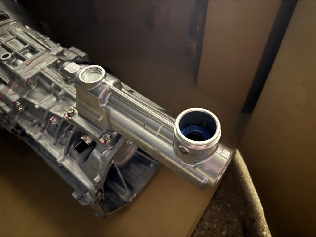

    Once the part number was available for this new transmission (33030-04080), I began trying to figure out a way to order it....
    ……which proved to be much more difficult than it should have been. The RC60F was confirmed to be the transmission in the 2024 Tacoma in November 2023. It didn’t hit the parts catalogs until around February 2024. I ordered from Sparks Parts first, who told me it was on backorder indefinitely. I cancelled after about a month. During early 2024, there was a recall where the transmission lost the 2/4/6 gears. They weren’t selling them through that time frame while they worked on the solution. Eventually, Toyota released a TSB and the transmission issues were fixed. I then placed an order at Sparks Parts in July 2024. After a few weeks, they cancelled the order on me due to realizing the shipping would be too much for them to handle. They charged me $300 for shipping, so I thought we were good, but anyways. It didn’t work out.
    Next, I ordered it locally from Longo Toyota of Prosper. They cancelled it a few days later stating a few bogus reasons:
    • This transmission requires a $1000 core charge.... Nope - Toyota doesn’t sell rebuilt manuals, and so they don’t want cores.
    • This transmission will require you to turn on your old transmission and it MUST match what you bought.... Nope - again, no cores.
    • This transmission requires “paperwork” to be filled out before they’ll sell it.... Nope, again, it’s just a simple part you buy. There is no reason there would be any paperwork whatsoever. You’re not buying a remanufactured transmission with a weird warranty or anything like that.
    They told me the parts sales manager could call me to discuss if I wished. I took them up on that offer and requested the manager call me to discuss, but I never received a call. I gave up on it and the order remained cancelled.
    Next, I tried to order it from BAM wholesale and Toyota Parts Deal, and each cancelled immediately due to the transmission not being immediately available to ship (they called it backorder status).
    I decided to wait until Black Friday, knowing Toyota usually runs some pretty crazy deals for a week or so at that time of year. Lo and behold, this year Toyota ran the typical 25% off + dealer discounts deal which brought the total to $2,580 out the door. That is an insane deal when you consider just the MSRP on the part is $3,800. The dealer price was around $3,100 and with discounts it came to around $2300, plus tax. I bought it and waited. I was pretty sure this order would go through, because it was officially on the Toyota parts site as a US domestic part number, with there really being no good excuse since it was on the genuine Toyota website. So, I had some faith/hope this time.

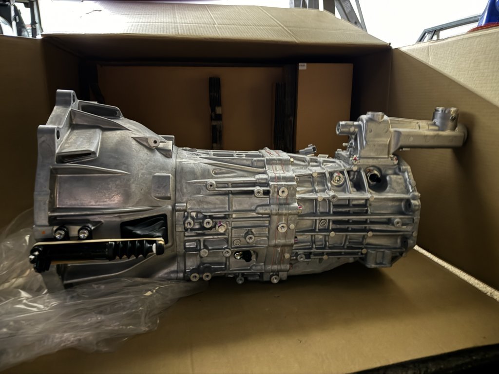

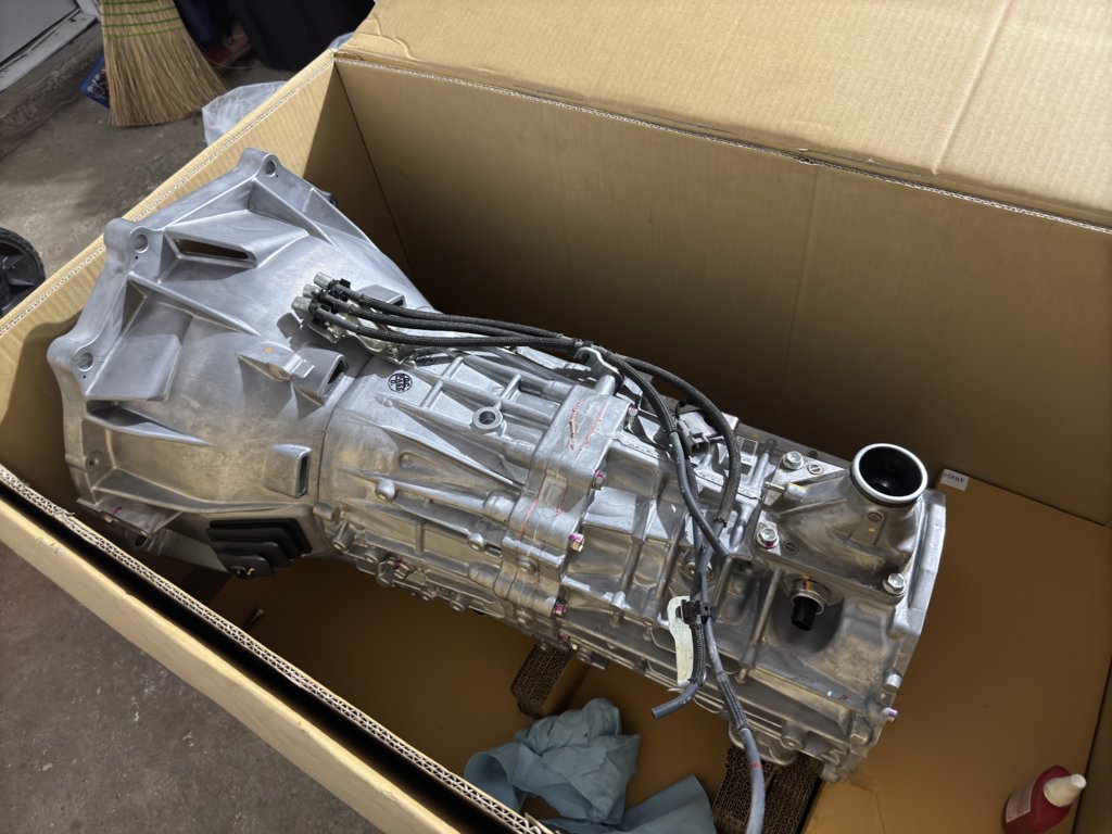

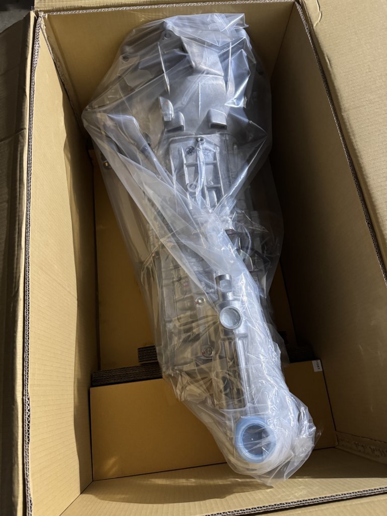

    Around a week after I ordered it, I got an email from the dealer saying it would be shipped via freight from California, and that it would not be returnable. I agreed to those terms and waited a little longer. After about 3 weeks total, I got a notification that it was ready to pick up! Score!

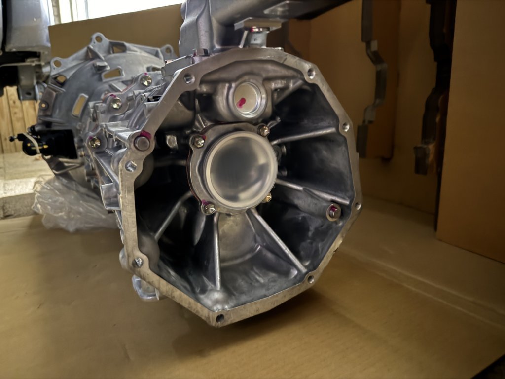

    I picked the order up that evening and it was exactly what it should be: a brand-new shiny transmission in a nice cardboard box that fit it perfectly. The dealer parts salesman and I loaded it in the truck, and I headed on home.

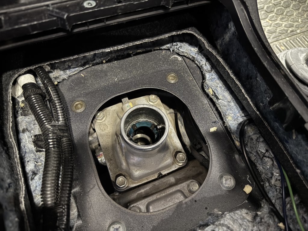

    • Drain the transmission fluid. 24mm head bolt. Remove the fill plug first and then drain plug. Put both plugs back when done.

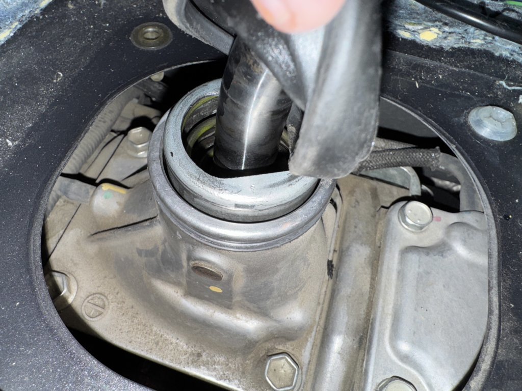

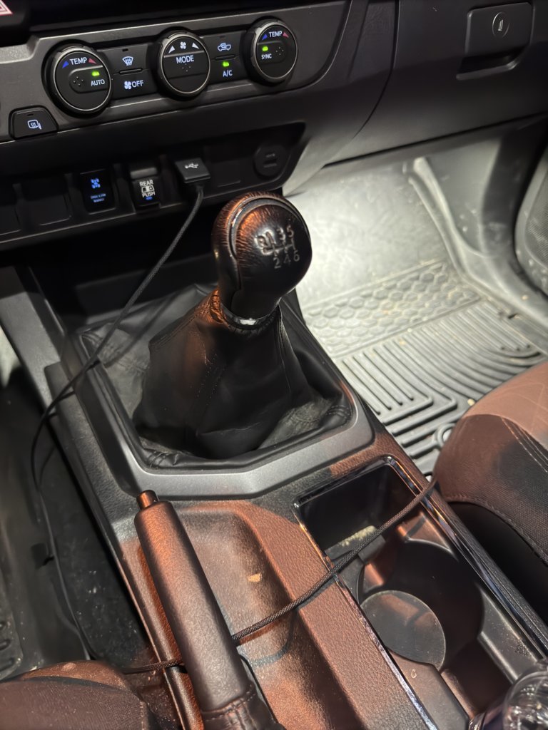

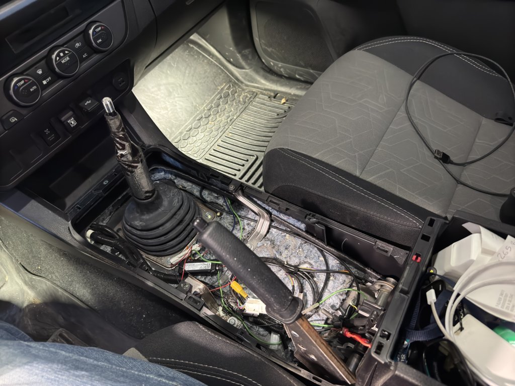

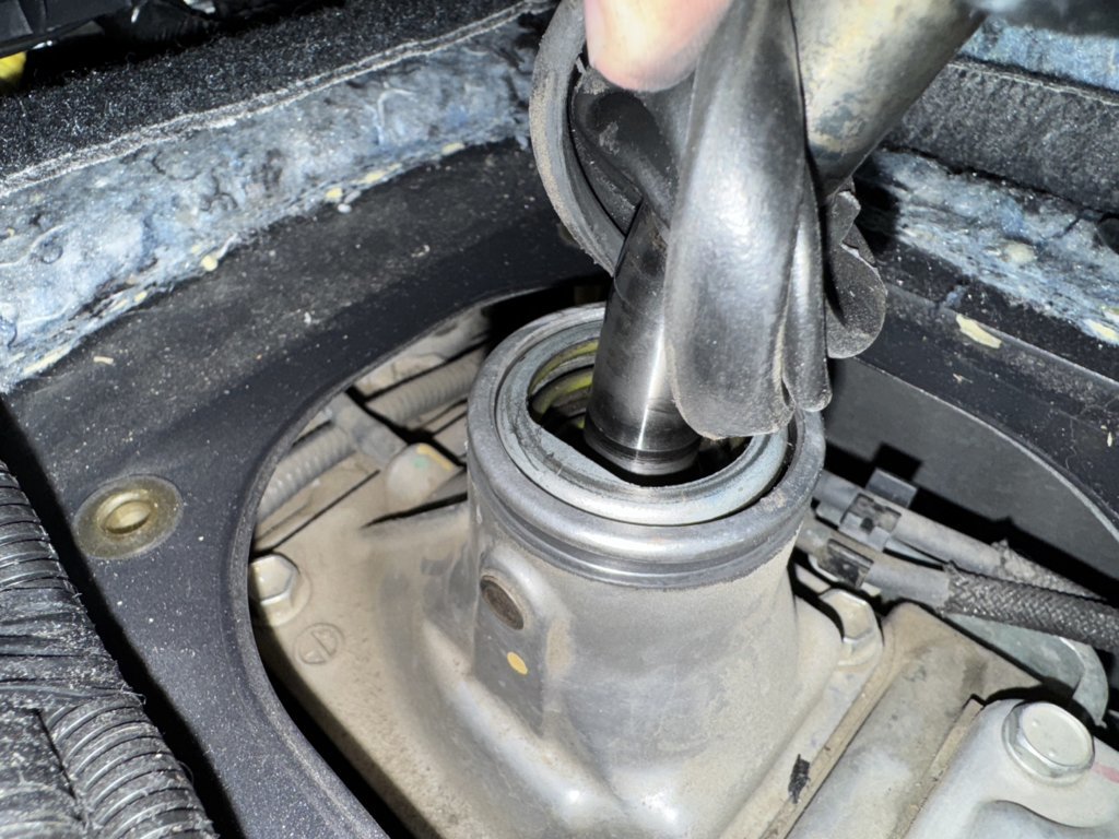

    • Looking down at the shift knob, grab the chrome trim ring on the boot and twist it clockwise. Pull down and it comes off the knob.
    • Unthread shift knob and set aside.
    • Open the console and pull up the parking brake.
    • Give a firm tug and pull out the large upper console finisher trim piece. Work the parking brake boot off of the handle.

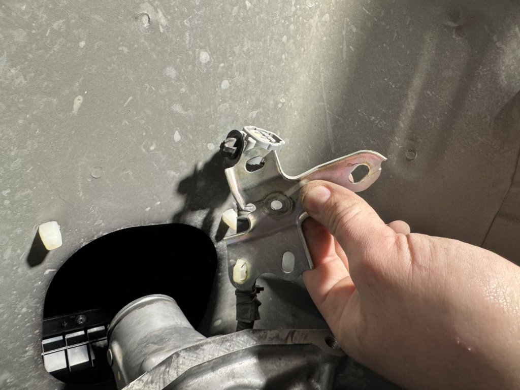

    • Remove rear driveshaft. Chock wheels. Keep parking brake set. You may need to spin the driveshaft around once to get to all the nuts. Jack up wheels and undo parking brake with trans in neutral to spin the driveshaft around.
    • Remove front driveshaft.

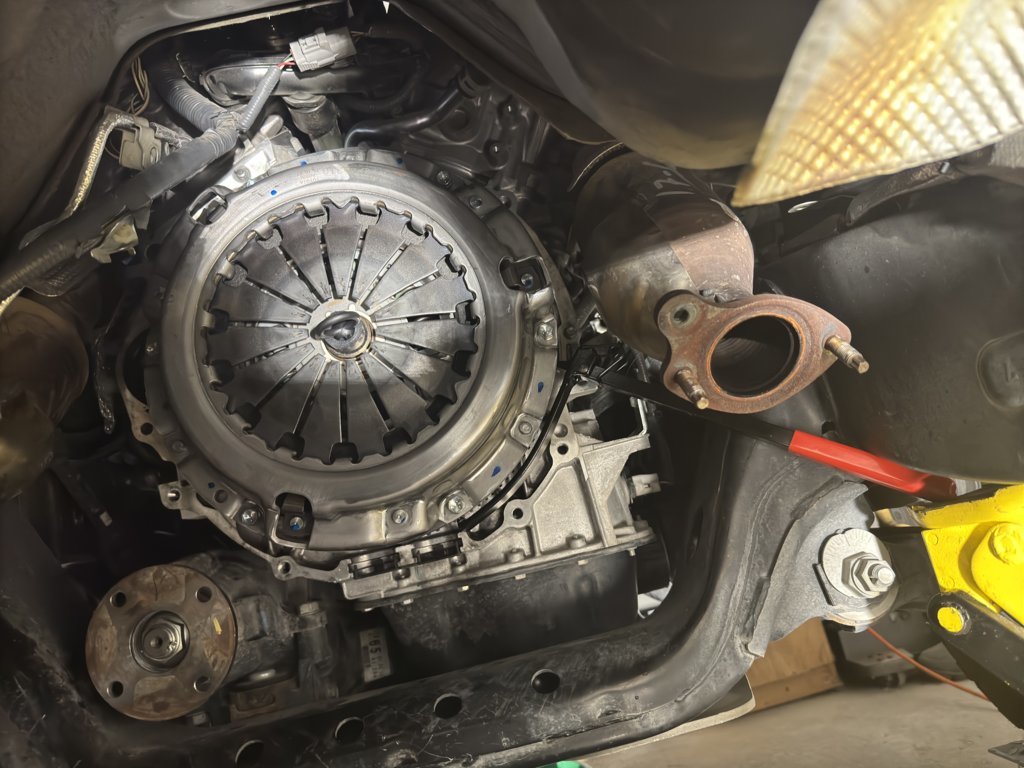

    • Remove the metal piece that goes around the left secondary cat.
    • Remove the bolts at the muffler connection.
    • Remove nuts at the secondary cat to main cat connections on both sides of the exhaust.
    • Use exhaust hanger pliers to remove the bushings holding the Y. Pull out the entire Y pipe with both secondary cats in place. Set aside.
    • Remove the transmission mount to crossmember bolts (4). These are the short ones.

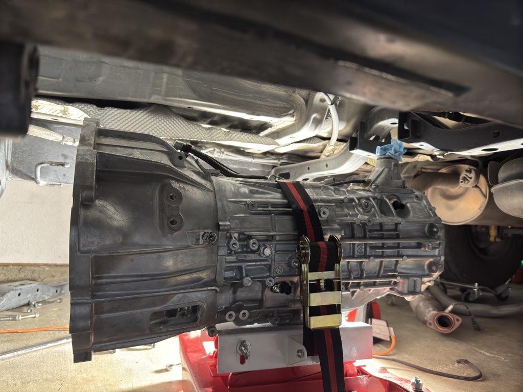

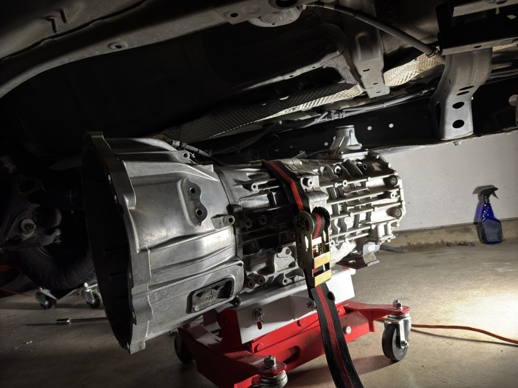

    • Roll your transmission jack under the transmission and lift the transmission up slightly. Remove the transmission mount to transmission bolts (4). These are the long ones.
    • Remove the support bars connecting frame to crossmember.
    • Remove 4 bolts/nuts for the crossmember and remove the crossmember.
    • Use transmission jack to lower transmission as far as it will go. Throw the jack’s strap or chain over the transmission to secure it.

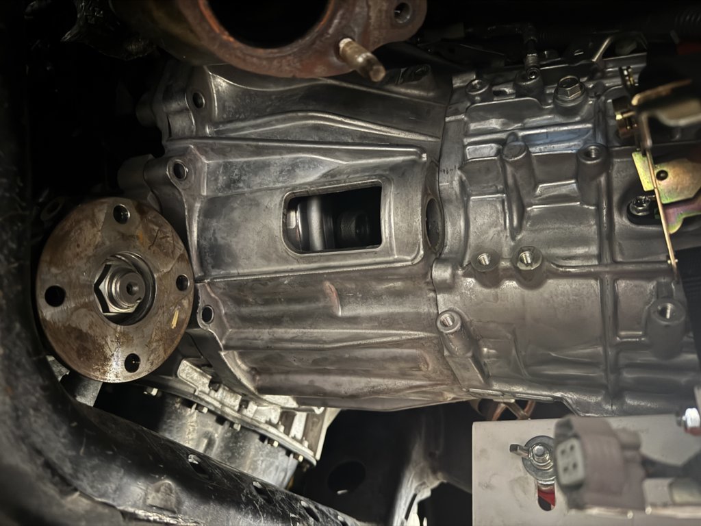

    • Since the transfer case would be moving to a new transmission, I removed it before I pulled the transmission. So next few steps focus on transfer case removal.
    • Unplug transfer case connector and remove the bolt holding the wire harness to the transfer case.
    • Pull the breather hose off the actuator.
    • Pull the breather hose off of the top barb of the transfer case.
    • Loosen/remove the 8 bolts holding the transfer case to the transmission.
    • Pull the transfer case. May need to tug on it. It seals with an o-ring, which can be a bit tight to remove from the transmission. Set aside.

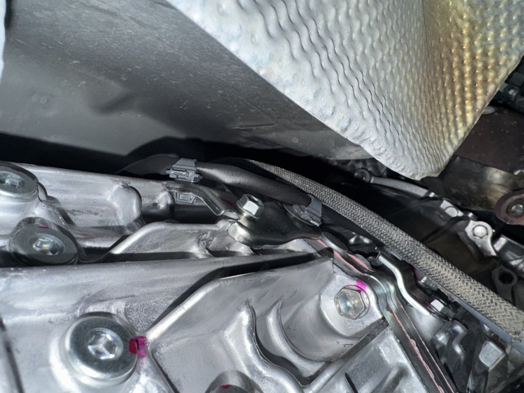

    • Work your way up the transmission to remove the wiring harness. It’s bolted down in 4 or 5 different places with 10mm head bolts. Take photos of any wiring connected to brackets and remove the brackets from the wiring. Needle nose worked well to pinch the tabs on these.
    • The last wire harness bolt was a real pain. 10mm head, facing vertically, can’t see it and can barely get to it. Use a small 10mm box or open end wrench and work it out slowly.
    • Work on the clutch accumulator. Remove the 4 bolts for the heat shield.
    • Use a 10mm line wrench and remove the hard line to the accumulator, and hard line going to the slave cylinder, from the accumulator. You can leave the slave line in the slave.
    • Remove the 3 10mm head bolts and remove the accumulator. There will be dripping brake fluid, have towels handy.
    • Remove 2 10mm head bolts for slave cylinder and remove it.
    • Undo the bolt for the bracket holding the accumulator line to the bellhousing. This one is also a pain. 12mm head, use a swivel socket and extension to reach it.
    • Remove the 3 bolts per side and each exhaust bracket supporting the main cats to the bellhousing.
    • Work on transmission bolts. Five 17mm head bolts towards the upper half of the transmission pattern, and then six 14mm head bolts. The 2 longer ones are for the starter, so don’t mess that up. The short ones won’t reach the starter, and the long ones will be too long for any hole that isn’t a starter bolt hole.

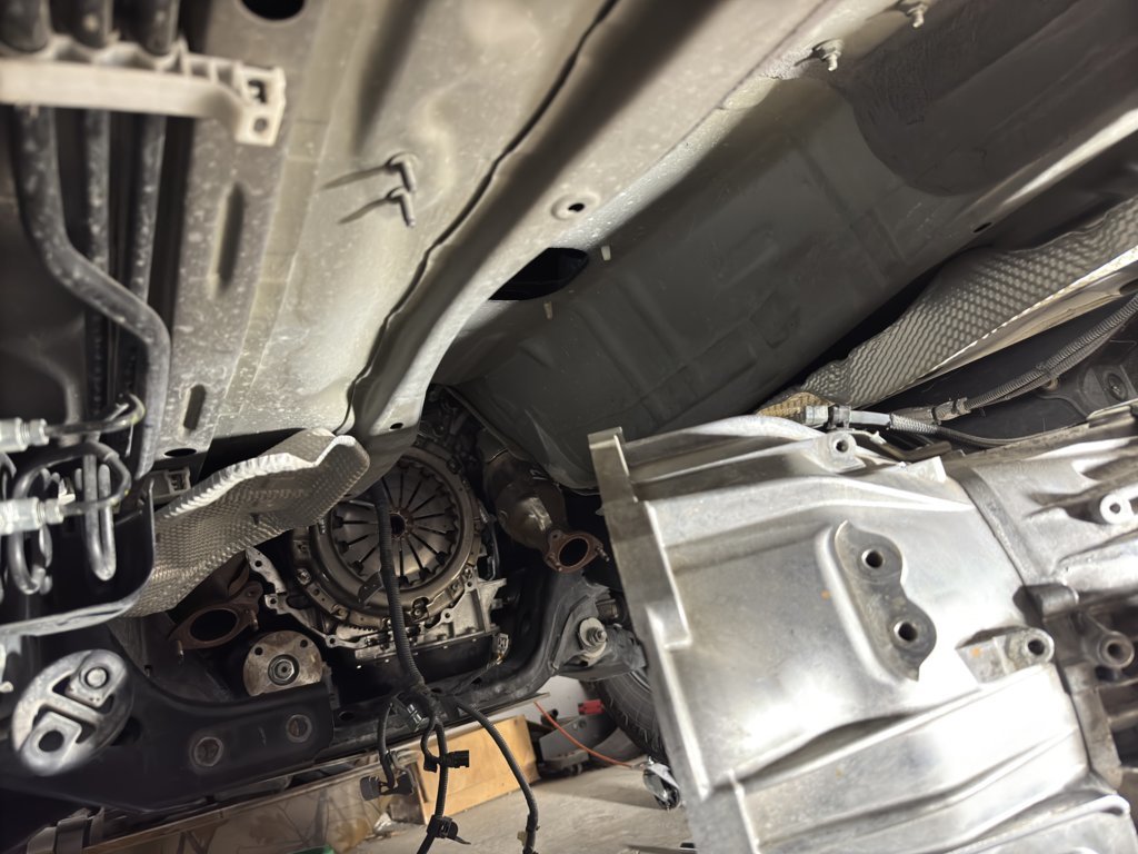

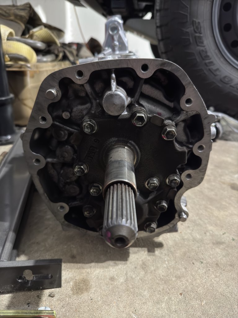

    • Secure transmission to jack and pull it out. Lower down to the ground gently.

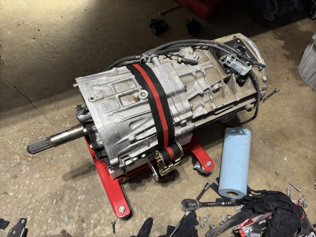

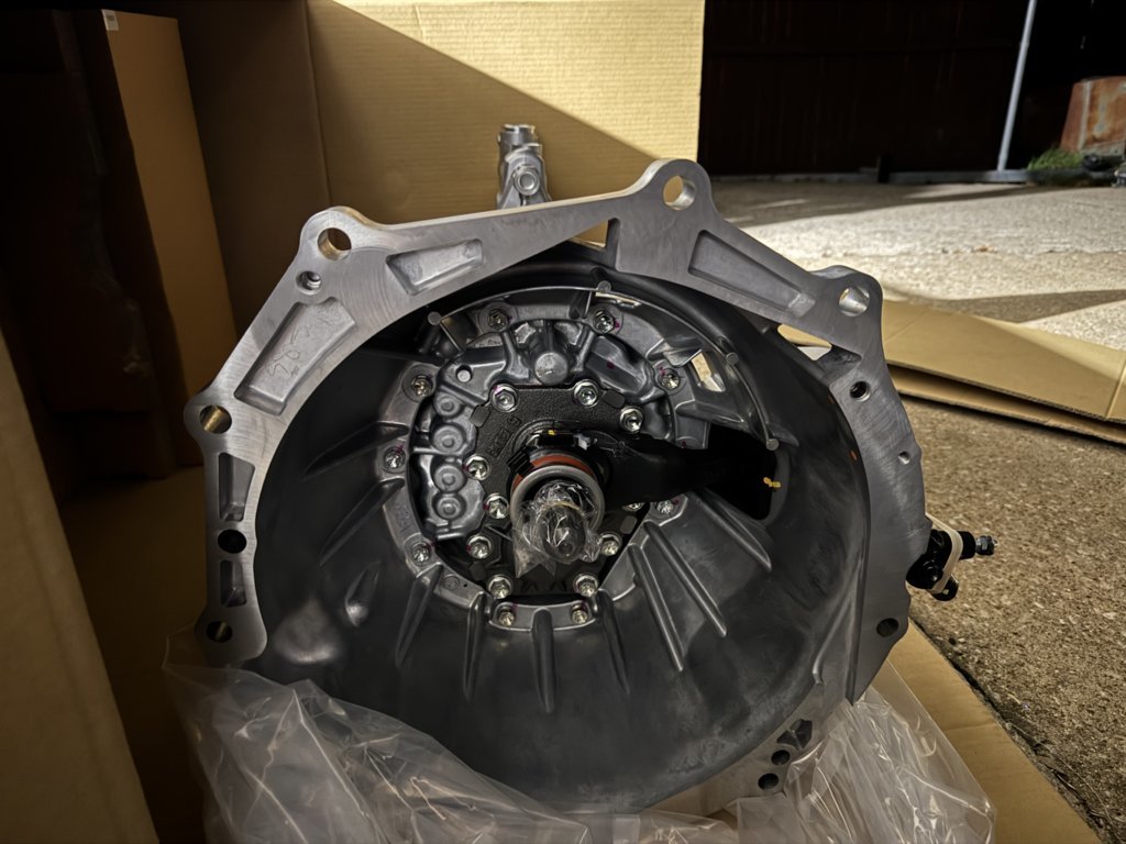

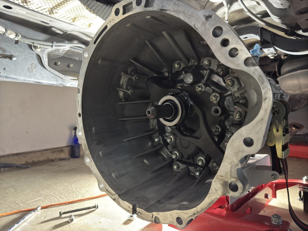

    Swapping parts between transmissions

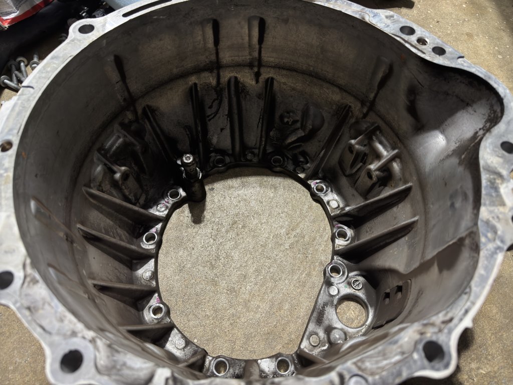

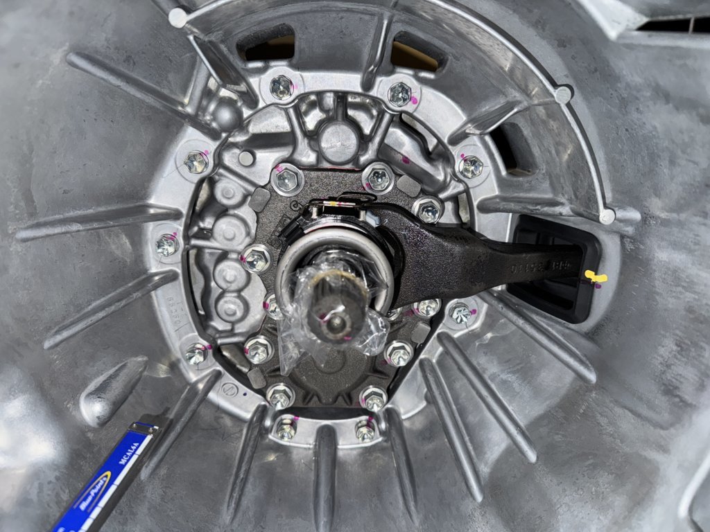

    • Remove bellhousing from old transmission and new transmission. Install old bellhousing on new transmission.
      • x10 14mm head bolts, 27 ft-lbs.
    • Install new release fork support on the old bellhousing if you are replacing (recommended)
    • Install either old or new fork (if you choose to buy one), as well as new throw-out bearing (highly recommended)

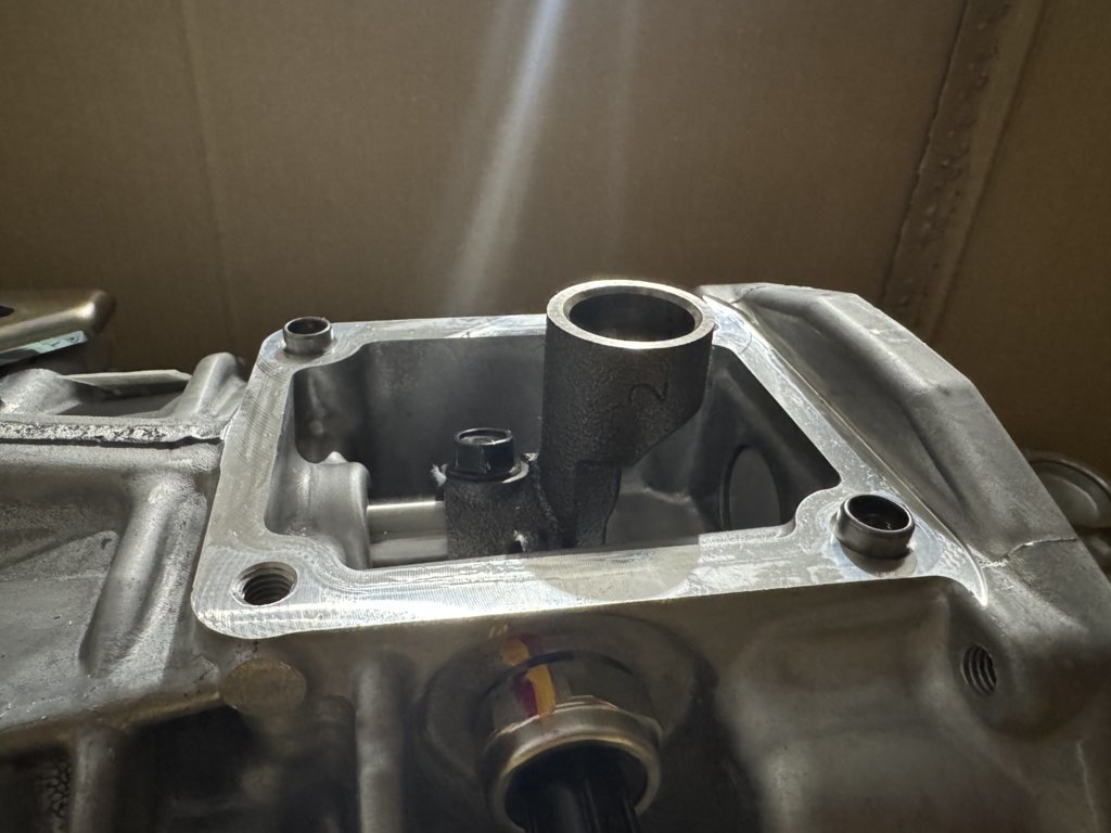

    • Remove shift tower assemblies from both transmissions.
    • Remove the shifter housing pieces from each transmission.
    • Install the shifter housing piece from the stock RC62F onto the RC60F shift shaft and install the bolt with red Loctite. Crank it down tight with a 3/8” ratchet.

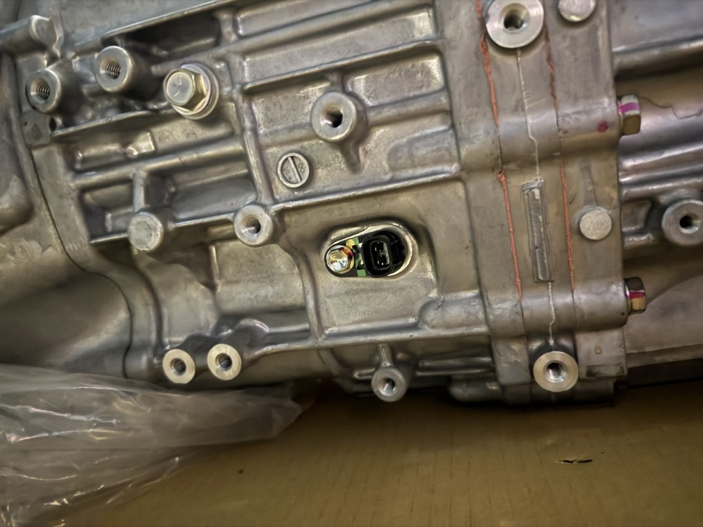

    • Find the backup light switch on the old transmission and follow it's wiring up to the top where it is clipped to a bracket. Grab the white clip for the breather hoses and move that over to the new transmission backup light switch connector bracket.
    • Undo any other brackets for the backup light switch wiring and undo the wires from those brackets. Move the brackets from the old transmission over. Due to the 2024 being an I4 and only having exhaust on one side, the new transmission has different brackets that don't support the same setup as the 3rd gen. So, your brackets need to be moved over.
    • Move the breather hose assembly over, bolt down the brackets and clamps in the correct spots.
    • Remove transmission mount from old transmission and install in same orientation on the new
      • x4 14mm head bolts, 30 ft-lbs.

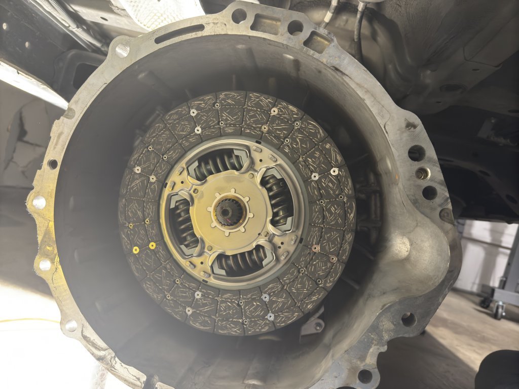

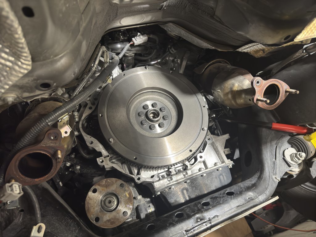

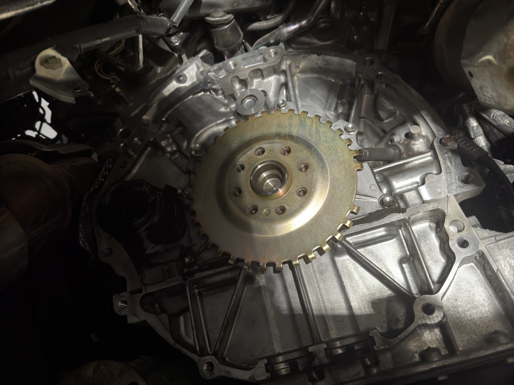

    If you are replacing the clutch/flywheel while in there

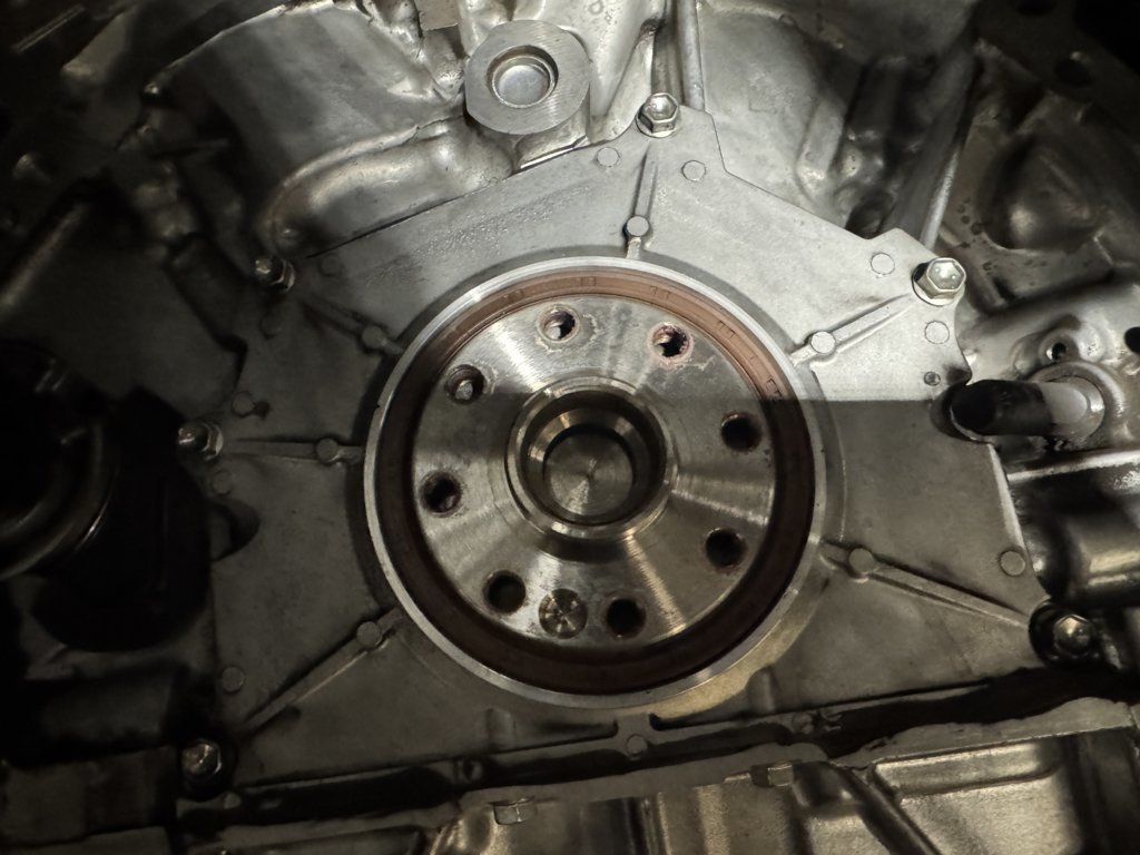

    • Zip off the clutch bolts, remove pressure plate and disc
    • Zip off the flywheel bolts with an impact (hold the flywheel so it doesn't fall)
    • Hammer new dowel pins into new flywheel if applicable
    • Install new flywheel with new bolts
      • Use three-bold 1324 or red Loctite 271, and install bolts to 22 ft-lbs. evenly
      • After 22 ft lbs. on all bolts, rotate each bolt another 90 degrees
    • Clean flywheel surface with dish soap and warm water
    • Clean pressure plate clutch disc surface with dish soap and warm water
    • Using a clutch line-up tool, install pressure plate and disc
      • Tighten clutch bolts evenly
      • 14 ft-lbs.

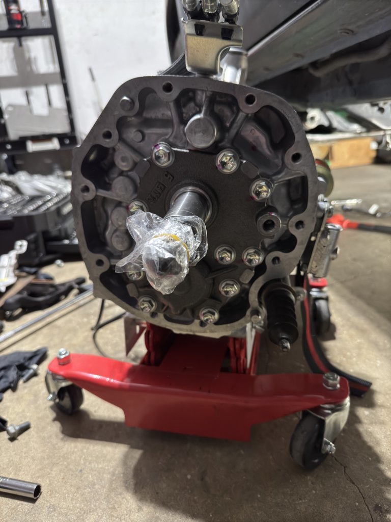

    • Roll it up there on a transmission jack, get it to the same angle of the engine, roll it a bit closer, making sure to clear the body, wiring harness, and dangling clutch line. Peek through the window in the bellhousing to see how your alignment looks. Once you're close, shake the transmission and push forward. It should slip in relatively easily.
    • Reinstall bellhousing to engine bolts
      • x5 17mm head, 53 ft-lbs.
      • x6 14mm head, 27 ft-lbs.
    • Make sure the 2 longer 14mm head bolts go back to the starter location

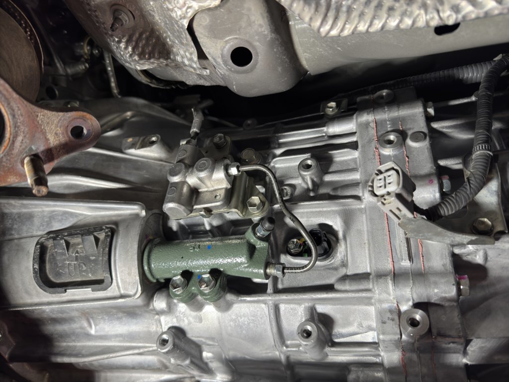

    Release (Slave) Cylinder Equipment Reassembly
    • Bolt the accumulator line bracket down to the transmission snugly
      • 12mm head, 15 ft-lbs. (snug)
      • Use a work light to light up the side of the transmission so you can see the bolt hole and line up the bracket accordingly. Without light, I messed with it for over 10 minutes and still didn't get it. It's way up there and hard to reach.
    • Fasten the release (slave) cylinder to the transmission. It will be spring loaded when you push it against the release fork.
      • x2 12mm head bolts, 9 ft-lbs (snug)
    • Attach hard line to the slave cylinder and accumulator loosely
      • 10mm fittings, use a line wrench (snug)
    • Install accumulator (or deleted version of your equipment if applicable)
      • x3 12mm head bolts, 9 ft-lbs (snug)

    • Install inner shifter boot with 2 screws and 2 clips
    • Install console finisher trim by clipping it down
    • Thread on shift knob
    • Pull boot up to shift knob, twist counterclockwise to lock the knob to the boot

    RPM Comparisons:
    4.30 gears, 30.6" tires
    (RC62F left, RC60F right)
    5.29 gears, 30.6" tires
    I have the setup on the right
    5.29 Gears, 34" Tires
    Comparing my bone stock truck to what I have now
    Original (left), Current (right)
    Percent difference in each gear from then to now:
    1 - 39.8% Lower
    2 - 39.8% Lower
    3 - 27.2% Lower
    4 - 23.0% Lower
    5 - 12.5% Lower
    6 - 11.0% Lower
    R - 39.8% Lower
    Overall, a big difference in all gears except the tall ones.

    The beauty within after opening the box:
    Miscellaneous photos after unpackaging:

    The input revolution sensor shown here stays in place, unused:
    Photos of the clutch setup, that are all unused on this swap:

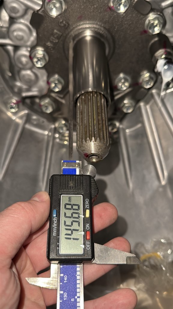

    Measuring the input shaft to confirm it is roughly the same as the stock 146mm measurement:
    Beginning teardown, starting with the interior:
    Remove the inner boot, then pull off the small circular oil seal boot, press down on the lock ring and turn counterclockwise. Pull shifter out:
    Photo of backup light switch connector bracket orientation for reference:
    Transmission out!
    The empty void after removal:
    Photo of the old clutch setup, parts were in good shape:
    Old bellhousing removed and ready for cleaning. You can see the fork support that I later removed and replaced with new:

    The shifter housing piece that needs to be swapped. 2024 Tacoma uses the one on the left, you need to move the one from the right over to your new transmission and install the bolt tight with Loctite 271 (red threadlocker):

    Breather hoses moved over - starting to pretend to be an RC62F!
    Comparisons of the fronts of both transmissions - they look identical! Old on the left, new on the right if it isn't obvious:
    New transmission dressed up, under the truck, and ready for install! It passes for an RC62F! All new clutch fork, fork support, and TOB installed - bellhousing cleaned up nice and easy:
    Removed old flywheel, left the reluctor in place, installed new flywheel. Check out what I had to do with the flywheel holder to make it work solo (used a floor jack on it and raised it up into the frame so it couldn't move):
    Clutch fits on the splines perfectly - the clutch disc comes from the factory greased up, so I didn't need any spline lube for the splines - nice touch.
    New OEM clutch installed and ready for the transmission to mate up:

    Accumulator and new slave cylinder installed and plumbed:
