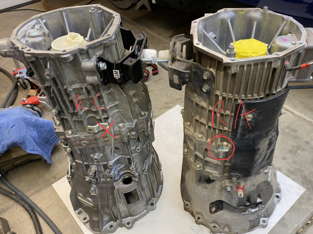

    Did you by chance measure the overall length of the RC60F transmission? I was going to replace my RA60F transmission with an RC62F but the RC60F seems to have the best ratios of the 3 (im a 2013 DCSB sport) I hate the ratios in my truck, i also dont like the aluminum quill that wears out and squeaks in neutral.

    Didn’t need to measure it since it was a direct swap for my RC62F. I want to say it’s been determined that the RC series transmissions are like 1” longer than the RA or something like that. RC are the same length as the 2nd gen auto, even use the same factory front driveshafts.
    I've got a good deal on my used RC62F if that interests you at all to get away from the crap quill design. Otherwise, the RC60F is the way to go since you can get it new for a decent price at Black Friday.

    did you use the rear mount from the RC62f that mounts to the cross member? im piecing together this swap for a 2nd gen.

    You can't keep the 4th gen TOB or clutch fork, they are specific to the 4th gen bellhousing and that bellhousing does not work on the 3.5L. You have to swap the bellhousing which requires using all the 3rd gen clutch release equipment.
