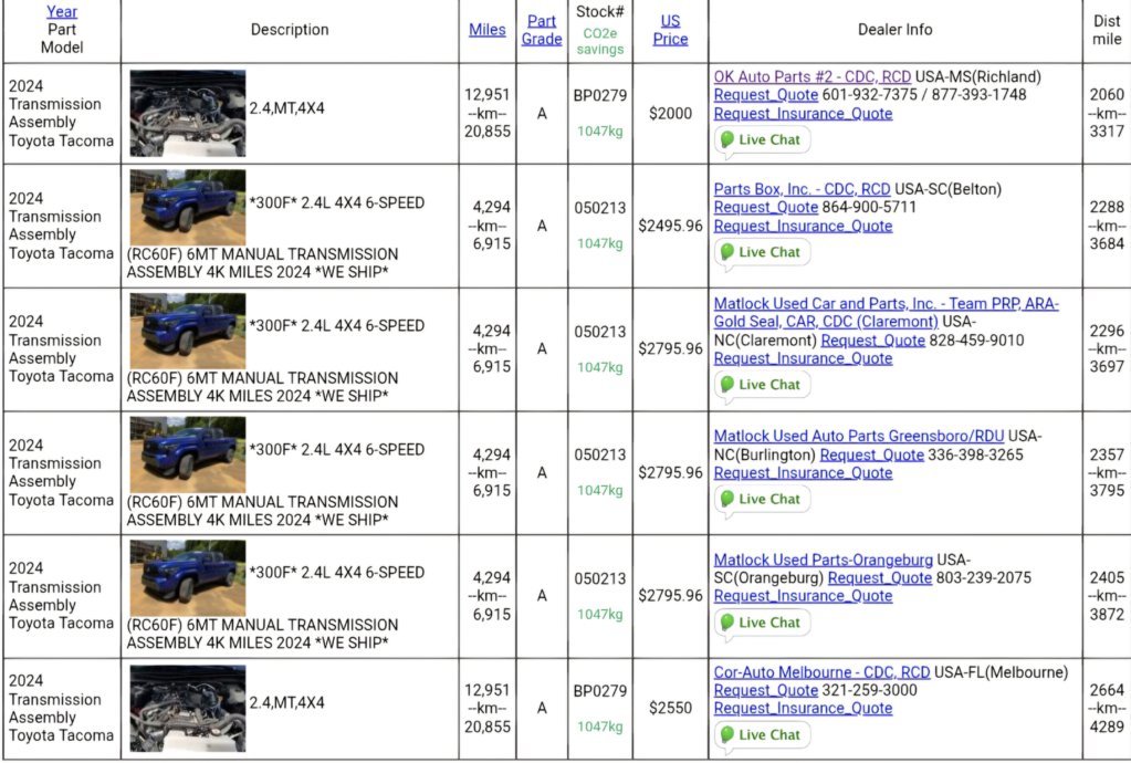

    If anyone in the South East is looking at doing this swap, car-parts.com is showing interchange and 6 available in Mississippi, the Corolina's and Florida. I am waiting to see if something pops up closer to me.
    lacab100, shakerhood and BLtheP[OP] like this.

    Nice. They must be starting to become more common in wrecks. I checked there daily for over a year and never saw a single one. Even like a month ago just out of curiosity, still saw none at all no matter how far away I set it. Hopefully this becomes a viable option for some soon.
    Although I will say those prices are not really better than what I paid for new, at Black Friday of course. So for some it might still make more sense to either wait and buy new at BF or bite the bullet and buy new even not at BF.
    Sucks these things are so expensive.
