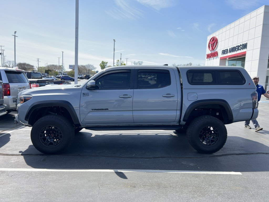

    I just purchased this vehicle at a local Toyota Dealership.
    Objectives:
    -eliminate the front spacers and keep a similar stance.
    -replace rear shocks to with Bilsteins
    -identify UCAs
    2018 TRD Sport:
    -05tma30 marked spacers, looks to be 3” lift based on internet search?
    -factory Bilsteins and springs up front
    -mystery shocks in rear (gray color)

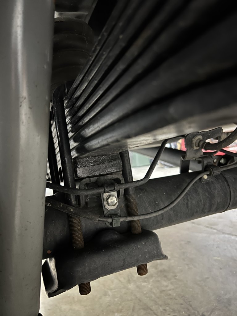

    -OME EL112R Leafs with what looks like like a 1” block

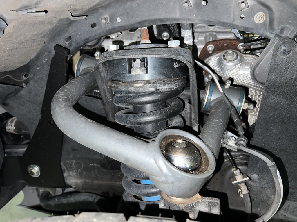

    -mystery uniball UCAs
    -286/70R17
    -Leer camper shell
    -factory 4Runner TRD pro wheels
    -mini bumper and winch upfront ~150 lbs
    Wheel well heights:
    -~23” front
    -~25.5” rear
    Partially educated Plan A:
    -5100s w/ 2886s up front
    -B110-P 5100s in the rear
    -Leave the UCAs as is
    Uneducated Plan B:
    -Open to suggestions
    I’m generally happy with how this drives now. Truck has a pedal commander, Injen CAI, Borla catback. Not looking to go anywhere in a hurry.
    Someone dumped a lot of money in this thing but skimped on the suspension (except the leafs).
    photos below

    Once you find out the UCA, of recommend greasing them, since there is no way to know last time they were greased.

    I was going to guess total chaos uca's, but they use red poly bushings. The uniballs might need to be replaced as there's a bit of rust in there.

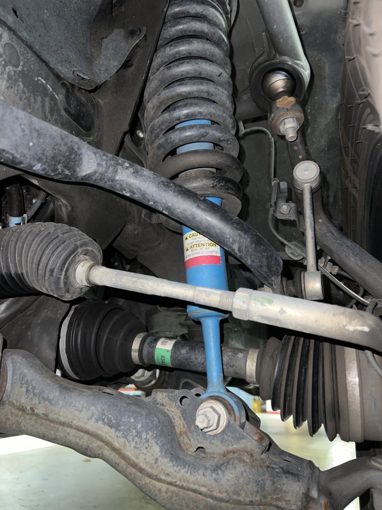

    TRD Sport doesn't have factory Bilsteins (I see blue shocks, they should be Hitachi).
    3" lift spacers should be 1.5" thick (roughly 2:1 lift ratio). Brand matters little, most all of them are just a machined aluminum donut.
    I see a remote-reservoir mounting bracket in one of your pics, so whoever had it before probably stuck the stock shocks back on it (w/spacers) for trade-in.
    Can't help on the UCAs or rear shocks (not enough of the shocks visible in your pics to see anything, if there is anything to see on them anyway)
    Looks like new(ish) inner CV boots on that, I'd have to wonder if they had torn due to that lift being 3", and not 2"... You definitely do not want to leave that at 3" lift.

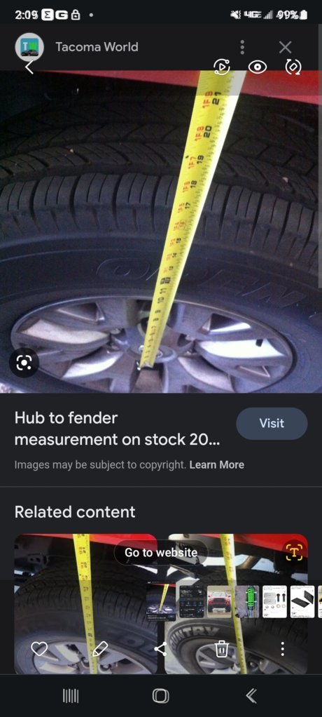

    Start by measuring center of hub to fender on each wheel. Stock is about 21 front and 22 rear. This is always how you measure lift heights.
    It does look like a 3 inch lift in front to me which is too much. Your cv boots won't last long. Stay around a max of 23 front and 24 rear otherwise your shocks will not have much downtravel left in them.
    Ideally you want 2 to 3 inches of downtravel.
    A 3 inch spacer lift will result in the uca likely making contact w the coils. And the shocks will bottom out before making contact w the bumpstop.

    Ditch the rear Block and new ubolts in the back depending on the current t height and the results if the 6112s

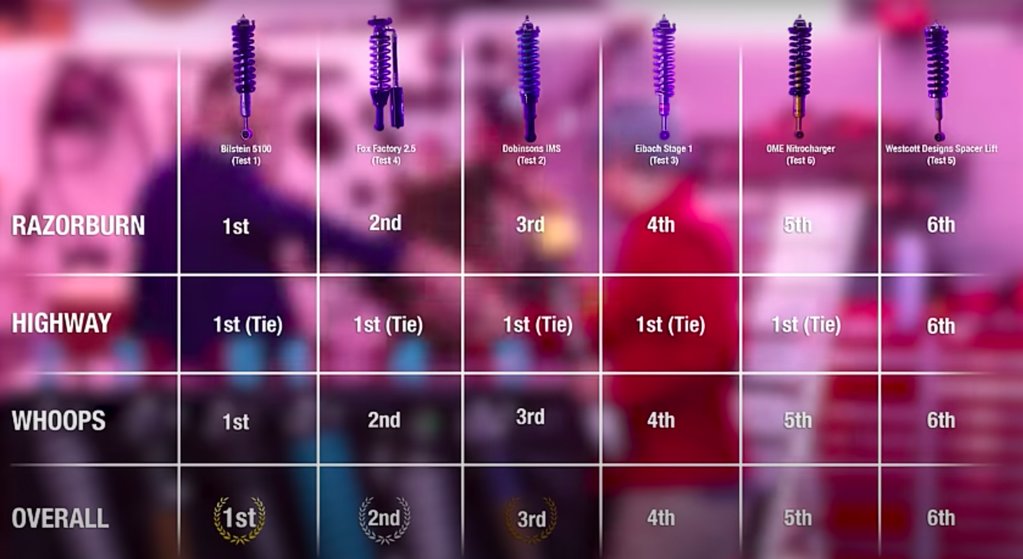

    Another 5100 fan here....
