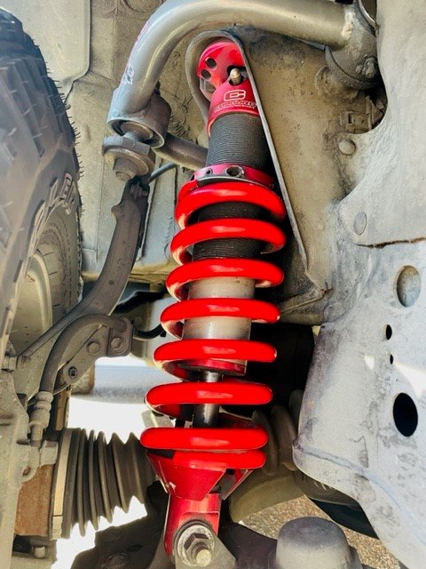

    Old fart here... I have the old Camburg/Sway-A-Way 2.5's on my 04 Taco, that have seen better days. Probably 10+/- years on them with no rebuild. I got some leads on shock service from Camburg, but a few of them came back with no-can-do, parts not available, so it's looking like I'll possibly need a new set. I'm just a weekend off-roader, but do want the same or better performance. Are Sway-A-Way coilovers still a viable brand? Or should I stick with either Fox or Kings (no shock wars please :))....

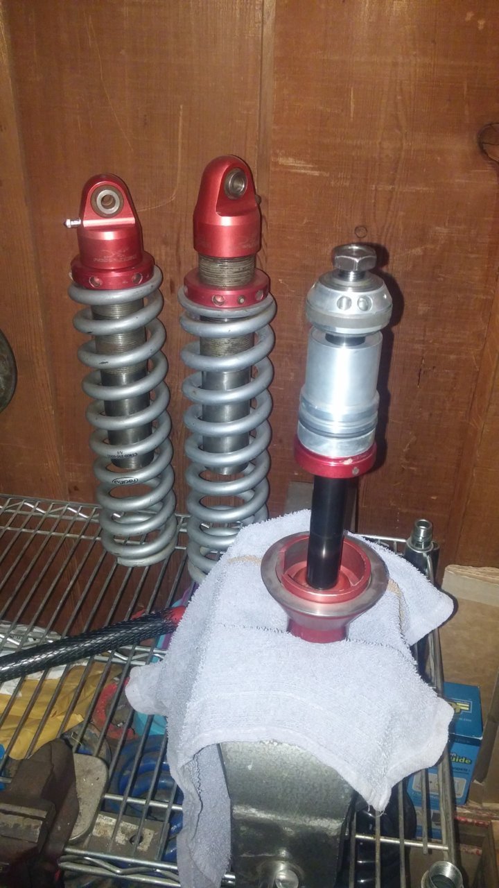

    @Anthony250 rebuilt an older pair of SAWs for me about 5 years ago. As I remember, the parts I ordered for the rebuild were pretty standard and weren't exclusive to Swayway, unless we're talking more than a general rebuild here. Ordered the parts needed from shockseals.com
    edit-
    on shockseals.com website there's a section for Swayaway seal kits
    https://www.shockseals.com/collections/sway-a-way-2-0-seal-kits

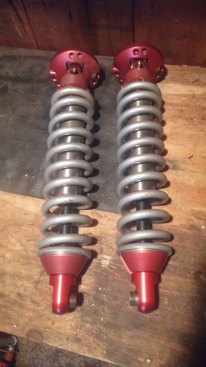

    I just rebuilt mine, all parts are still out there. aFe bought the SAW brand, but they sell all the rebuild parts. I got seals and wear bands as well as spherical joints from shockseals.com and you can get the shafts and bushings and whatnot (if they're bad, they're probably fine though) from aFe

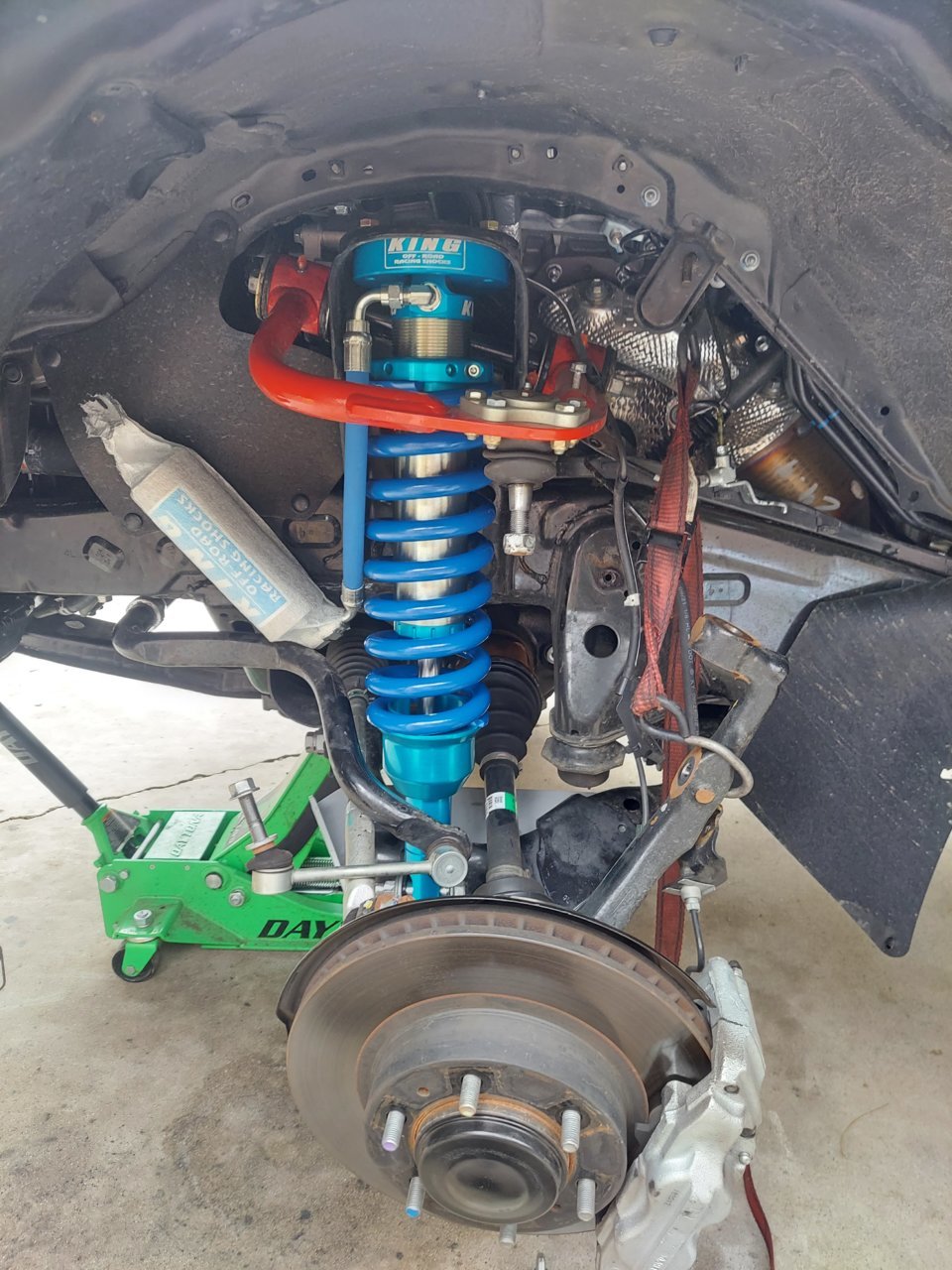

    I kept my 5100/881s around for this reason when I got my King coilovers. Have had to remove the Kings for service twice and both times I just had to swap my old setup back in real quick.
