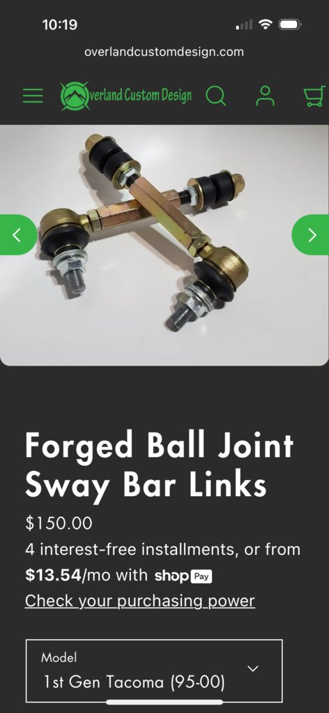

  10. May 4, 2025 at 10:31 AM
    Bigd83
    Bigd83 [OP] Well-Known Member
    Jul 14, 2024
    #453285
    68
    2000 sr5
  11. May 4, 2025 at 10:32 AM
    02hilux
    02hilux What do you mean there’s no road, I’m here
    Sep 14, 2016
    #197244
    6,118
    Planet: EARTH
    Just end links. Sway bar bushing, I honestly preferred OEM over poly but at this time and age, idk if oem is available.
