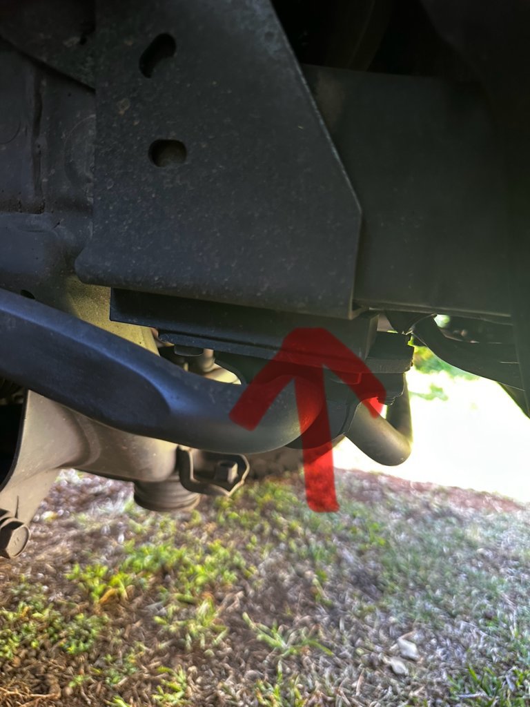

    I've had Fox Performance Elite 2.5 (Fox provided sway bar relocation kit) installed recently and today I wanted to install back my skid plate and to my surprise the 2 braces that hold the skid plate don't fit because the sway bar is too low. Anyone experienced this? Is there a solution except removing the sway bar?

    I have the exact same setup and have not had issues like that, but also didn't do the install of suspension myself. Is this the area you're talking about?

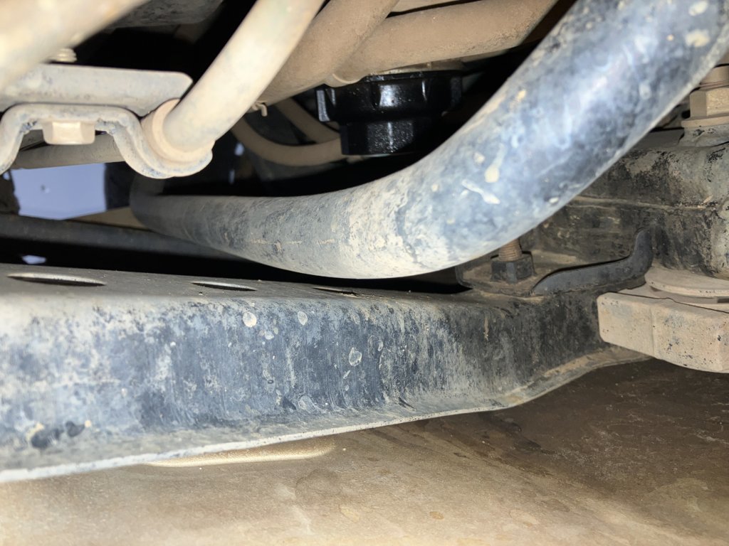

    Do you have spacers like the ones in the picture?

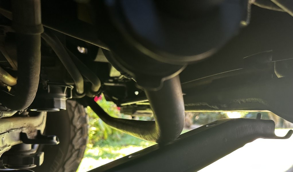

  10. Jan 23, 2025 at 2:34 PM

    Are the two braces necessary to install the Pro skid? I thought the skid used the same frame holes as the braces, but with spacers?

    That’s a good point I haven’t thought of. I’m not sure to be honest.

    I do, using the drop pieces the same kit comes with and its visible where the sway bar mounts (as far as I know since the shop I had do the install told me I wouldn't need the sway bar drop kit separately when I asked about it). Does your setup have stock or adjustable UCAs?
    For those more knowledgeable than me, would alignment be able to affect the angle on the sway bar there? Wondering if the adjustable UCAs on my setup might have allowed my shop to ensure the sway bar clearance was made which the OP isn't getting.
