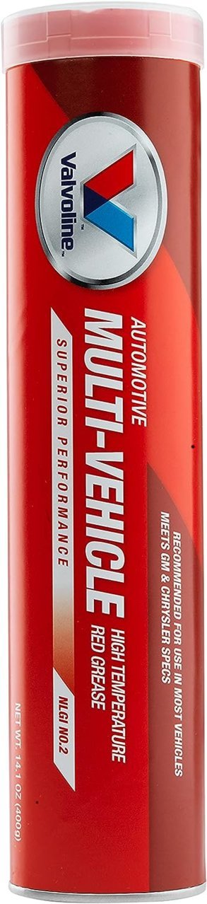

    I just recently replaced my old sway bar bushing with new ones without adding any grease for lubrication. After driving for about 2-3 weeks, I started to hear the clunking noises which coming from the sway bar bushing. I crawled under the truck and added some Valvoline Multi-Vehicle High-Temperature Red Grease and the clunking noises went away. My question is, is it fine to put grease in sway bar bushings?

    That valvoline is probably petroleum based. This other energy suspension stuff is probably your best choice.
    https://www.amazon.com/Jet-Lube-73550-Dielectric-Cartridge-Translucent/dp/B007IBAC9S?pd_rd_w=XMehC&content-id=amzn1.sym.8300047d-cdab-4038-92e8-d589d534357f&pf_rd_p=8300047d-cdab-4038-92e8-d589d534357f&pf_rd_r=4JY2S251V2HPEK59THMG&pd_rd_wg=nRjsw&pd_rd_r=db3293f1-6fbd-4ed7-8fa8-9e52c626cf98&pd_rd_i=B007IBAC9S
    This is my go to do all. Primarily, I use it for assembling hydraulic cylinder seals into their seats. Also anywhere an oring touches metal.

    I just recently replaced my old sway bar bushing with new ones without adding any grease for lubrication. After driving for about 2-3 weeks, I started to hear the clunking noises coming from the sway bar bushing. I crawled under the truck and added some Valvoline Multi-Vehicle High-Temperature Red Grease and the clunking noises went away. Now, the clunking noises are coming back, so what am I doing wrong here?

    Normally speaking, lubrication eliminates a squeak, not a clunk. A clunk is more a symptom of something being loose. You said you replaced your sway bar bushings. How do the sway bar links look?
