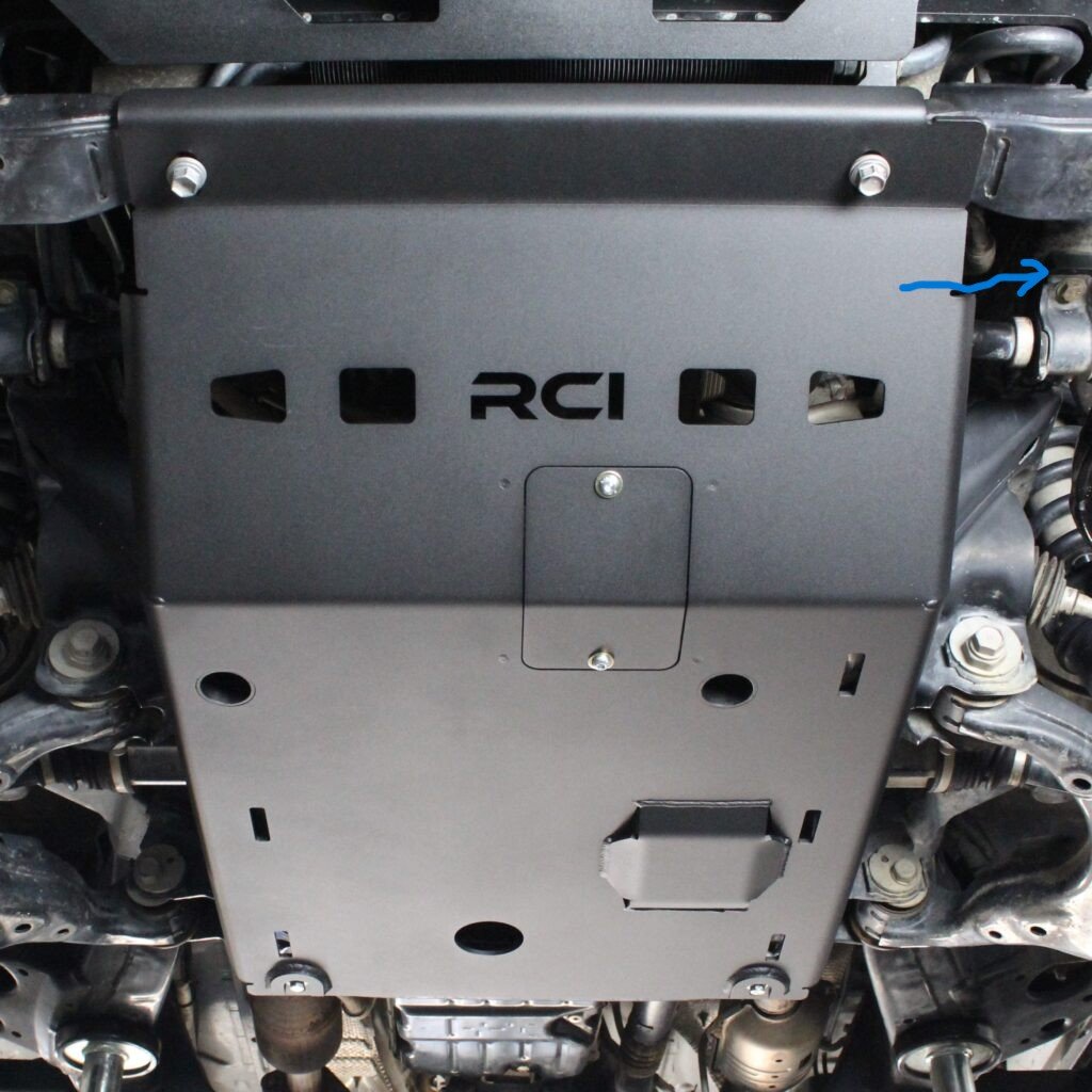

    I may have found a partial answer in the product photos. The truck in the pic below has a relocation spacer. Whether there's enough clearance between the sway bar and the skid remains a mystery . . .

    i installed the sway bar relocation spacer, have Fox coilovers and RCI skids on my 2021 TRD OR and everything clears fine with a "few fingers width" between it all.

    Thanks, yeah, I saw your posts about that. On my truck, it cleared the TRD Pro skid fine at full droop, but under compression I was concerned that it would rotate into the skid. It *may* have cleared, but it would be really close.

    Thanks for all who chimed in. And for anyone that finds this thread with the same question, I can now confirm that there is no interference. Similar to honkonbobo, I have a few fingers width of clearance.
