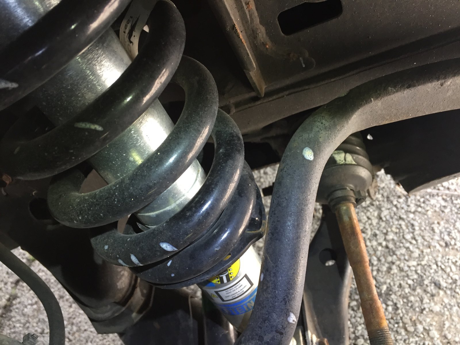

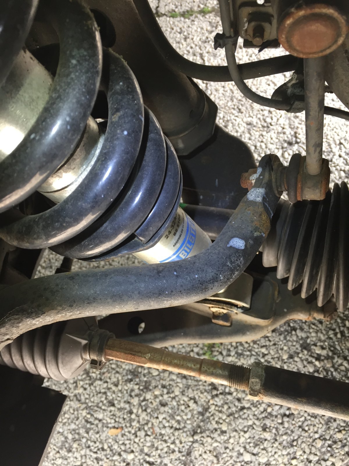

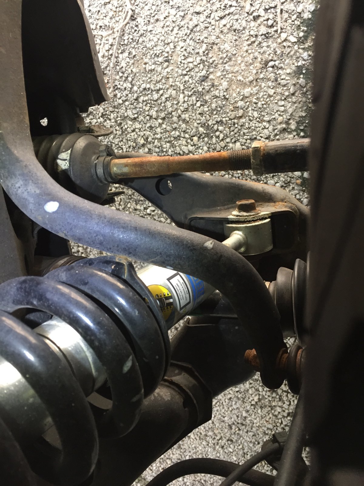

    Is it possible that my sway bar is making contact with the shocks/spring on the passenger side?
    My truck has been in two accidentals. I've been driving it for a year (only 500 miles since last repair) Just recently I'm getting a clunk only when turning and going over a bump (right or left don't seem to matter) I get it when I backing out of the driveway mostly. I've only recently started hearing it. Kind sounds like something hitting the backing plate.
    I jack up the front end and tried wiggling everything I could get my hands on. I tried turing the wheel from end to end and no sounds. Everything seems good. No play on the tire up and down or right and left. I engaged the 4Hi on a drive and no noises.
    Drivers side (The good side)
    Passenger Side - The bad side (it's not touching but its super hard to tel from the pictures)

    I guess my next step is to remove the sway bar and see if there's anymore sound.
    I'm thinking due to my accidents that maybe my sway bar is bent out of shape slightly. I might drive without one but I'm afraid in a deer jumps out and I have to swerve sharply....so I probably replace it.

    A clunk while turning is usually a worn tie rod or loose control arm bolt. Judging from their appearance I'd speculate that your tie rods have been on there for a while and are worn out.

    I do have a broken cam tab. I had an alignment done last fall and I took pictures of it. I compared the picture to how it's currently sitting and it looks OK. I jacked the truck up checked the tire for play. I'd say it's good....
    Two years ago I did the steering rack ,refurbish OEM, Cv axles, New OEM and the shocks Bilstien 5100's. They came preassembled with OME 884's. Is there a chance the spring retainer is sitting wrong?
    The only thing I can think is that the sway bar is making contact. I see a little rust on the spring retainer that might suggest rubbing....IDK
    I'll probably remove the sway bar temporarily and see if the sound goes away. If it does I'll lube the sway bar and reinstall it, If not I'll look into torquing the LCA's. Either way I've got a few weekends worth of testing to do.

    To reiterate, and with zero certainty that it's your problem... torque the LCA bolts to spec, or perhaps a bit further. No way to know without physically putting wrenches on them and tightening. So... do this first -- it's way easier than replacing parts.
    They make a loud clunk when slightly loose, without losing alignment. Or at least mine did, and I wasted money on sway links and rod ends before I figured out that was my problem.
    The sway bar linkage can't hit your springs unless something is broken or wildly worn out. It would be obvious.

    I see no evidence that your sway bar is hitting anything. Someone on the board once found a worn lower strut bolt was allowing the strut to slip in certain situations. The bolt had a notch worn into it.

    One of my bolts through the spindle connecting to my sway bar had backed off a bit and it was really hard for me to diagnose. Everything seemed super tight, but i finally parked just right and all tension on the swaybar was relieved and it was noticeably loose. I couldn't tighten it, since the threads were ruined, so I slapped a couple washers behind it and tightened down. All has been good so far.
    I agree with @OldSchlPunk that it doesn't look like the swaybar is contacting the coilover, but you could always buy the sway bar spacer/relocate for like $25 and install that, but I'd test by just unhooking the swaybar first.

    I just heard back from the shop and they confirmed the sway bar is hitting the bottom spring retainer. Not sure why this is only showing up now 700 miles after my 2nd wreck but I have had two wrecks in this truck.
    I'm having the shop cut the old sway bar links off and remove the sway bar. Might as well I'm paying for an hour of labor for the inspection anyway. I'm looking forward to driving my truck without the sway bar for the first time.
