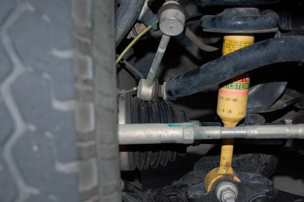

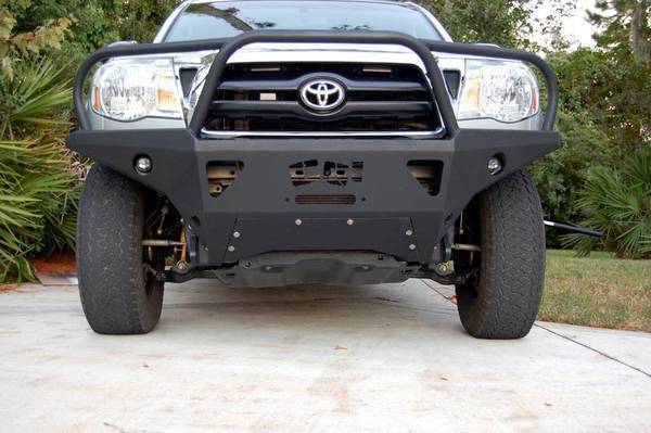

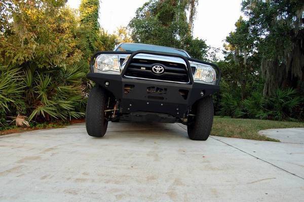

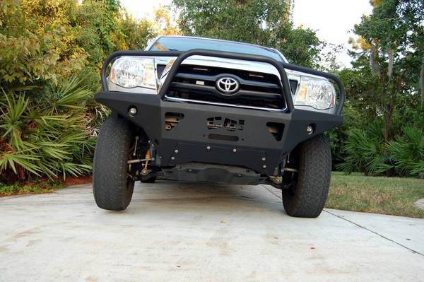

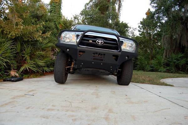

    Let’s get the bs out of the way. I do not recommend you disconnect your sway bar or completely remove it. There are obvious safety concerns involved with it. More significant, This thread is not a debate and if it becomes one it will be locked immediately. The reason I post this is to share my observations of an experiment I ran.
    I was curious what the benefits of a disconnected sway bar over a connected sway bar are. I also wanted to make sure that disconnecting the sway bar couldn’t cause mechanical damage(make contact with the suspension etc.).

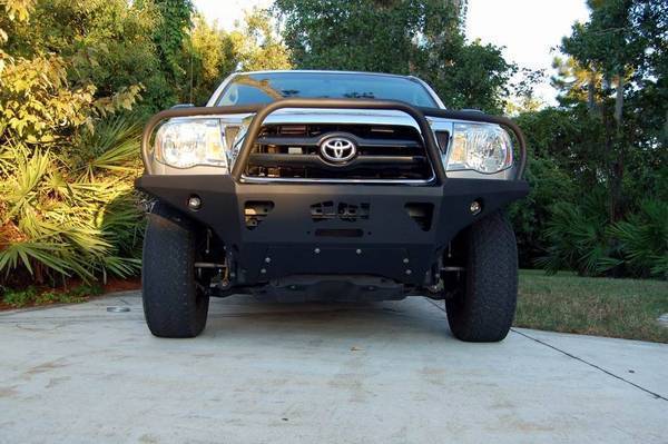

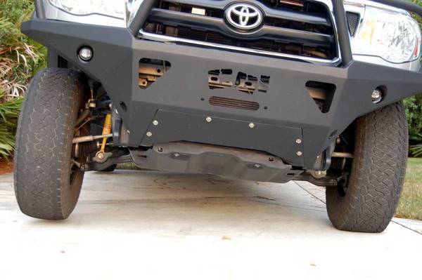

    My experiment consisted of using the hilift to get one side of the truck completely off the ground. My goal was to get the front tire approximately 1” off the ground. First I did this with the sway bar connected and then with it disconnected.
    Enough with the Chit Chat, here are my observations
    Sway bar connected-No jack present
    Sway bar connected-Jack lifted passenger front about an Inch off the ground
    Sway bar disconnected-Jack lifted passenger front about an Inch off the ground

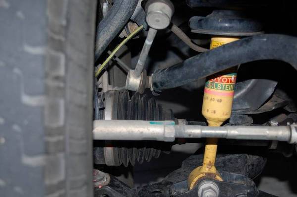

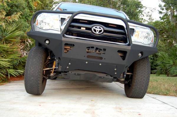

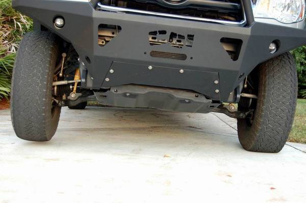

    Now the juicy part-I went over to the driver side slider to see if any problems arose with the sway bar disconnected
    Sway bar disconnected-Jack on drivers side-lift about 2 inches

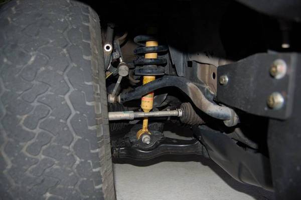

    Then I go over and check before I continue and discover this
    Sway bar disconnected on passenger side-Jack on Drivers side-lift about 2 inches
    I didn’t think that looked right, so I went over to the jack and pushed it down one more time
    Sway bar disconnected on passenger side-Jack on drivers side-lift about 3 inches
    On the farther away pics it's easier if you click on it and get a full size image.
    To conclude, The disconnecting the sway bar has obvious gains in travel from wheel to wheel but it can’t be done. The sway bar simply gets pushed right into the cv. If I continued to lift the drivers side it would have just gone down farther and farther into the cv. Now add this to a spinning shaft and your guaranteed a shredded boot and there’s a good chance you’ll destroy the cv entirely considering the force the sway bar can push down.

    If you don't want to have a sway bar then the only option is to completely remove it. It's either all on or all off. This is also answers the question as to why nobody makes sway bar disconnects for 2nd gen Tacos.

    I think that's the reason why a quick disconnect wasn't developed. The only way to disconnect it is to remove it as brutalracingguy and Jandrews have made clear.

    Thank you. I'm not sure how the sway bars are setup on the first gens, but I can tell you that if you disconnect it that it will go up and down a significant distance and contact anything in it's path.
    I always thought that it would disconnect on the spindle. I'm going to look into how other models work.
