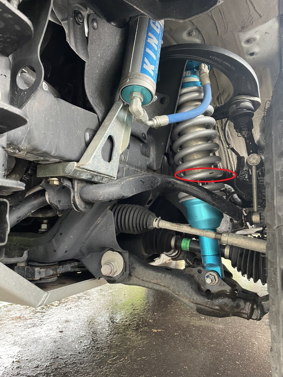

    As expected, the sway bar is hitting my coilover on the driver side (see picture of contact spot on spring).

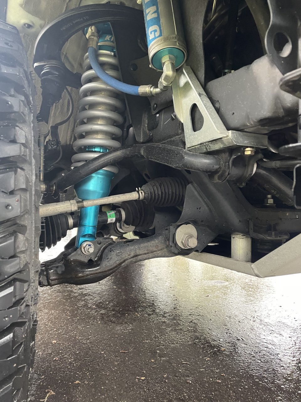

    Drivers side w contact
    passenger side no contact

    My guess, the coil is in just the wrong spot to where it shouldn't be. The fix would be to rotate the coil so that there is a gap there instead of coil, if that makes sense.
    Using the bottom of the shock as a (not great) reference point, you can see what I mean. Notice how on the drivers side where it's making contact, you can't see the blue part at the bottom of the shock but on the passenger side, you can.
    I say it's not a great reference point because one side could be compressed more than the other at ride height, so my theory could be off. That's my guess though.
