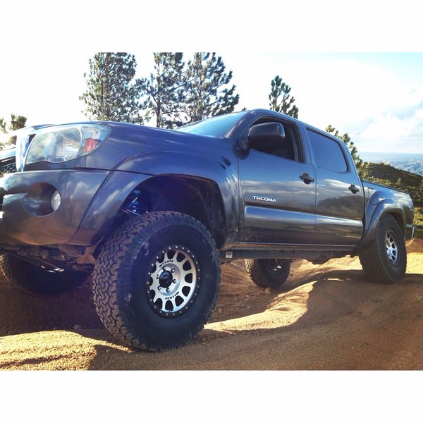

    I took mine off and very happy I did... This is my daily driver and weekend warrior, on road I cant tell its off but the extra flex off road sure is nice...:broccoli:

    Nice wheels!

    THROTTLE231

    Thanks man...:cheers:
