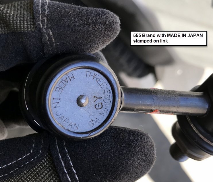

    History - Approximately 3 years ago I was hearing a popping / knocking noise from the front of my truck when going into my driveway or othter entrances where there was a dip/angle.
    I replaced the OEM sway bar links with the Moog Sway Bar End Links using the part #'s below from Moog-Suspension-Parts.com. I didn't notice before but I did when grabbing the pics below from their site that the part number is BECKARNLEY who provides many aftermarket parts. I'm not sure if Moog owns them or vice versa.

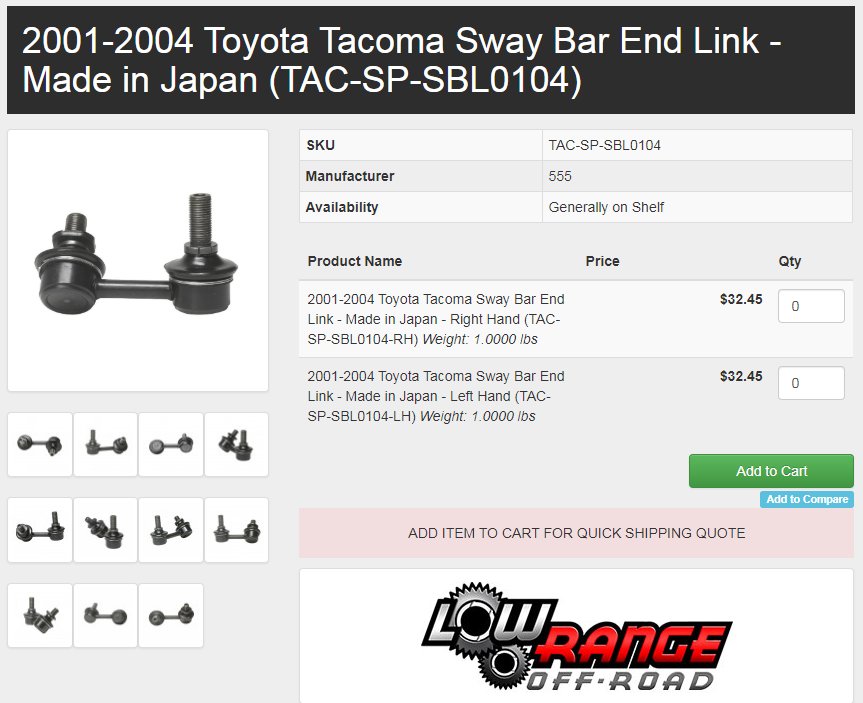

    Present Day - Started hearing that same popping noise so this go around I went with the 555 brand from Low Range Off Road which I installed Saturday.
    http://www.lowrangeoffroad.com/toyo...ar-end-link-made-in-japan-tac-sp-sbl0104.html

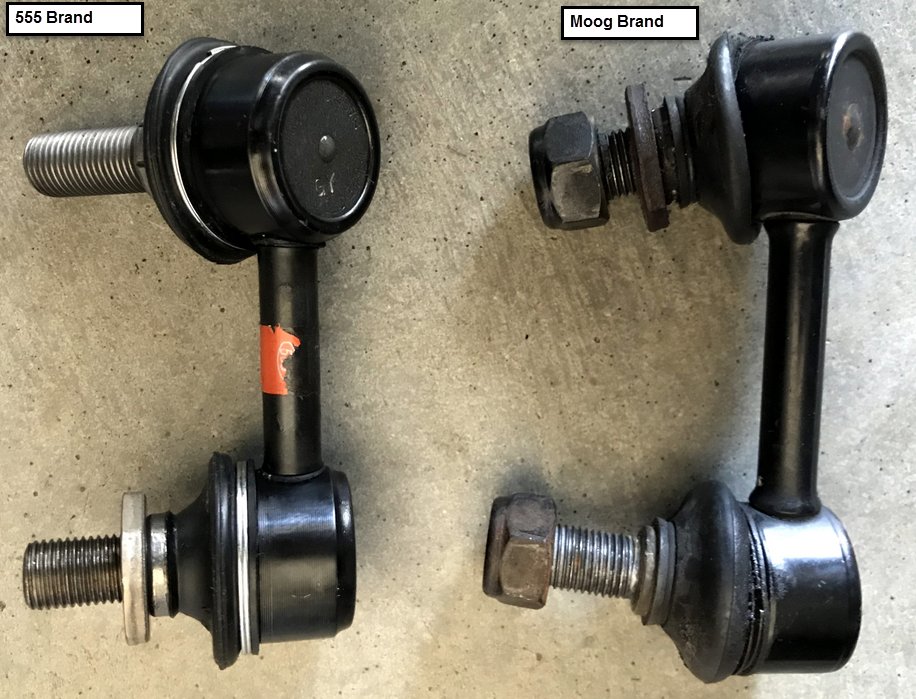

    Comparison Pics -

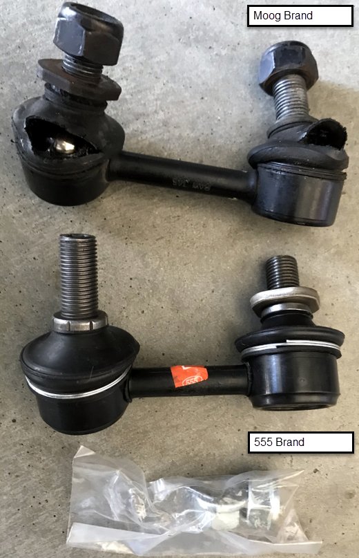

    Drivers side (LH) boots on the sway bar end links were both torn open exposing the ball joint to the elements. Pretty sure this is where the occasional popping was coming from.
    Passenger side (RH) lower link boot had a thin tear (not pictured).
    This isn't to bash Moog parts. Heck, I've got a pair of brand new Moog 81104 coil springs that I'll be replacing the oem with later this month.
    But, for certain parts I will be using OEM or the 555 brand because I can definitely see a difference in the build quality. Not only that, the 555's are only about $4 more.
