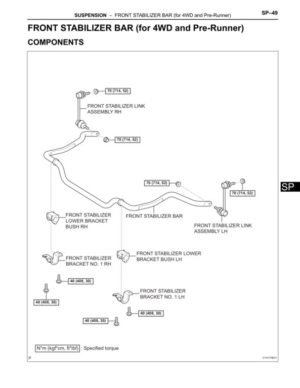

    Don't be afraid to slop a generous amount of anti-sieze on the threads, it'll help later when you need to remove it

    There is a hole in the center of the stud to stick an allen key, if the stud is spinning.
    If they are covered in rust, can go from simple job to needing to cut them off. I've had to cut a set off for a TW member before.

    The links you have aren't the same as the OP. Is that a 1st gen Tacoma you have?

    Ah OK well a 5 lug nonetheless. The torque specs listed above are for the 6 lug model. Aka pre runner or 4x4.

    Look at the key in the lower left of the diagram to translate the parentheses. Just different torque units.

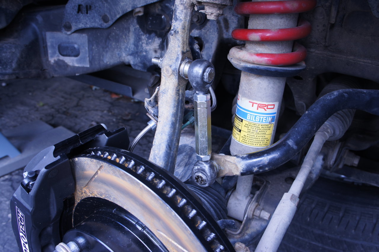

    Are those the Overland Custom Design End Links? How are they on quality? I need some and debating from yours or just OEM. lol The Overland Custom Design do look Heavy Duty too

    Yes OCD. Heavyweight, I got them because they are adjustable. I added an inch to lessen preload. Look at MOOG end links other than OEM. They are more beefy than OEM and grease-able.
