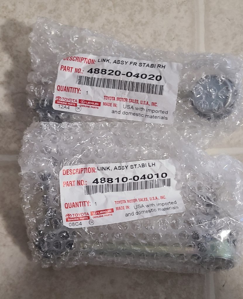

    Got my OEM end links today and installed them. Paid $90 shipped on ebay. Only took 7 days to arrive from Japan.

    $90 For a pair or individually? Could you share a link possibly?

    For the pair on ebay. They're sold out from the seller I got them from, but there are more. I posted about this earlier in this thread and got ignored. Instead of searching part numbers, I searched for "tacoma stabilizer link 05 oem."
    Here's a set for $106 plus taxes
    https://www.ebay.com/itm/3057406569...XtUwZXuSpW&var=&widget_ver=artemis&media=COPY
