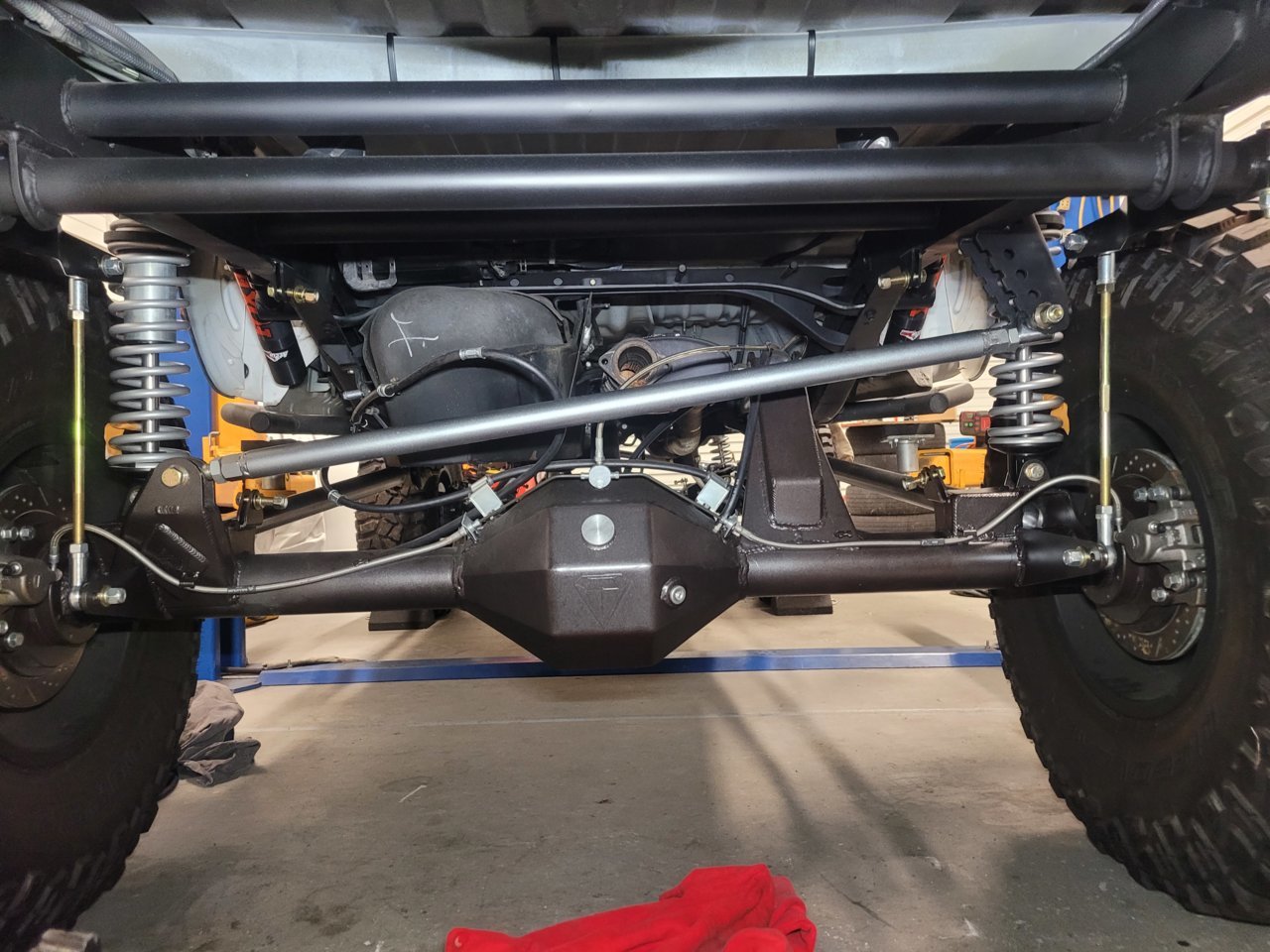

    What are you taking about.... My first gen have rear swaybar :D

    Not a whole lot of first gen goin on there haha.
    Sweet pan hard bar setup.
