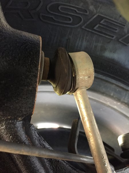

    If the endlink isn't sitting correctly in the spindle, Loctite doesn't seem like a great idea. In theory, angles could change and cause shifting where you don't want shifting.

    Got a pic of it

    Looks like it's seated correctly, but maybe over extended in terms of the angle.

    Thanks! Another thing I noticed, steering wheel shakes when it's tight and flipped! When it gets loose steering wheel doesn't shake Could the link have anything to do with steering shake??

    Ya know, the joint in the endlink could be bad. I'm sure it was moving all sorts of weird after the sway bar was flipped.

    ok i contacted pro comp, they said YES you are supposed to flip the sway bar to where its not seen, so not factory position... for future reference if anyone is wondering :thumbsup:

    Does that make your endlink line up?

    the shop had to flip it back to factory position becuase he could not get the alignment on spec with it flipped like pro comp wanted. so itll hand lower in front which is fine with me.
