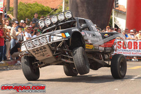

    keep this in mind. if youre driving down a freeway/highway and some ass whos plastic bedliner suddenly flew up in the air, cause it wasn't properly mounted (yes ive seen it, along with a bed mattress......), in front of you and you had to swerve very quickly to dodge it or get to safety, you going to be in some deep shit if you don't know how to handle a vehicle without a sway bar.
    Or possibly even going 40 across an intersection and someone runs the red light and you swerve. youll most likely swerve into the light pole unless, again, you know how to handle the truck without a sway bar.
    Safety like this is the very reason why there is a sway bar. people can handle a vehicle better if both tires are on the ground in an emergency situation. If you feel you can handle the truck without a sway bar and are willing to take the extra little chance, by all means go ahead. If you don't think you can handle a tire lifting off the ground during a hard swerve, leave it on. its all about safety.
    Also, these trophy trucks are barely going 25, maybe 30 mph.

    Huge difference between shock set up on a trophy truck and ours but I get your drift. I'd like to add I hit turns kinda fast sometimes and have never had left off like that.
