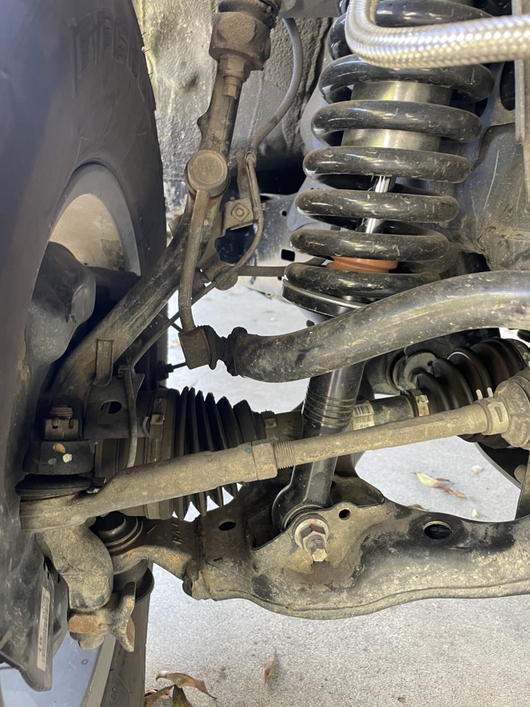

    Looks like I bent one of my sway bar links. Any recommendations on after market ones I should replace them with or do you recommend me sticking with OEM?
    Can I keep driving it with the bent link until I get replacement?

    Bent it offroading? I have actually only seen a bent one, one time. Take the sway bar off and go easy for a while and see if you like it more. I stopped running one years ago and never looked back. Every customer of mine that has removed theirs has done the same.

    I used some made by moog. They have a zerk fitting which I prefer.

    OEM part failed, no reason to repeat the mistake. Just get aftermarket: https://www.rockauto.com/en/moreinfo.php?pk=1831922&cc=1431544&pt=7580
    It's greaseable and has wrench flats for easy removal later on.

    What's a sway bar? Yank it off and throw it in the bin. :thumbsup:

    Front suspension was binding ?
