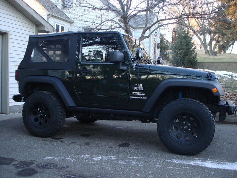

    ... I bought the 'helwig' sway bar to put on my 2wd reg cab. Truck never see's the dirt, strictly a road warrior.
    ...don't have one on my 2010 Wrangler though.
