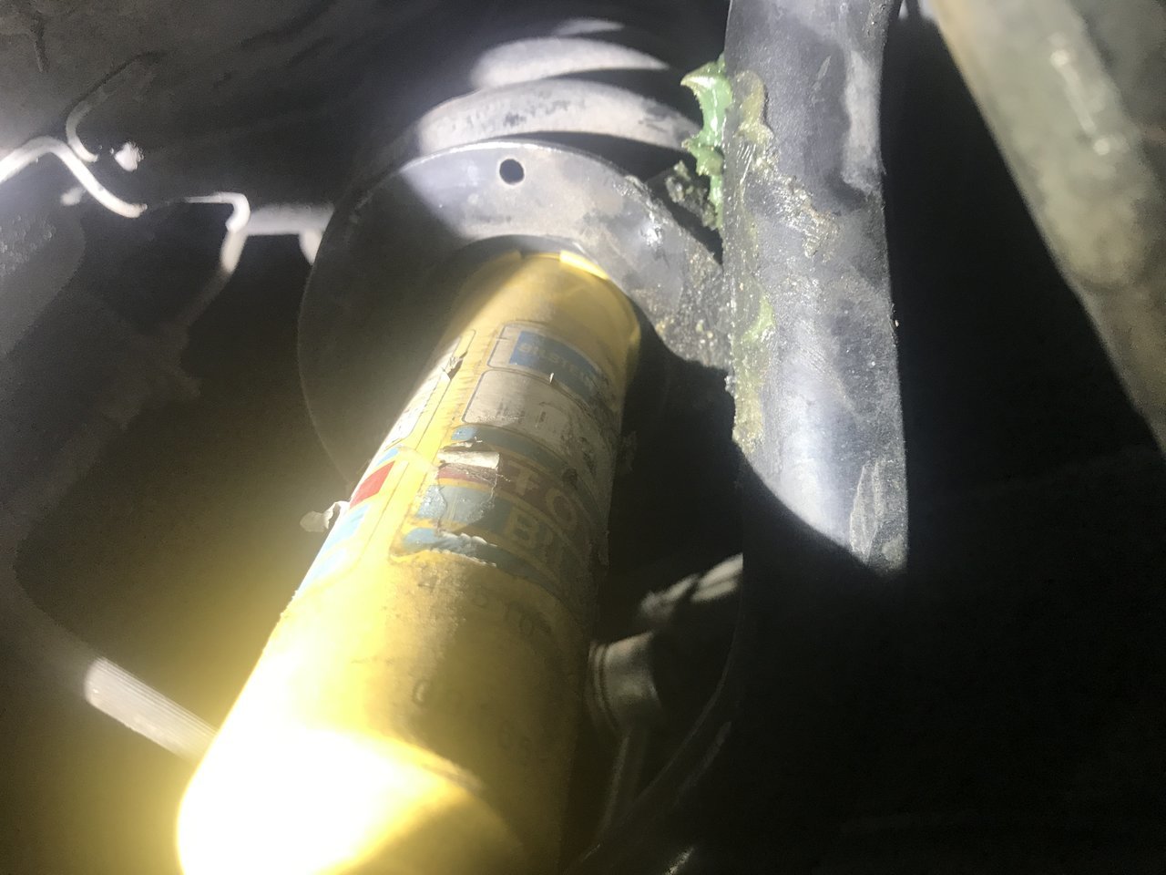

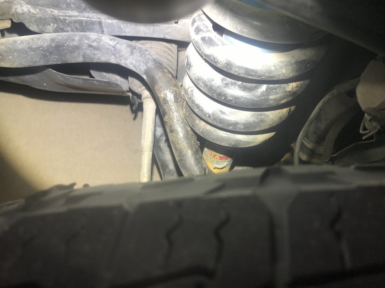

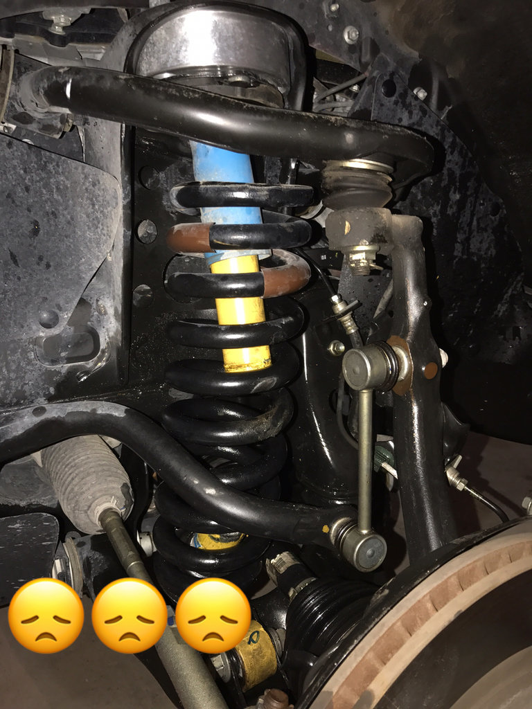

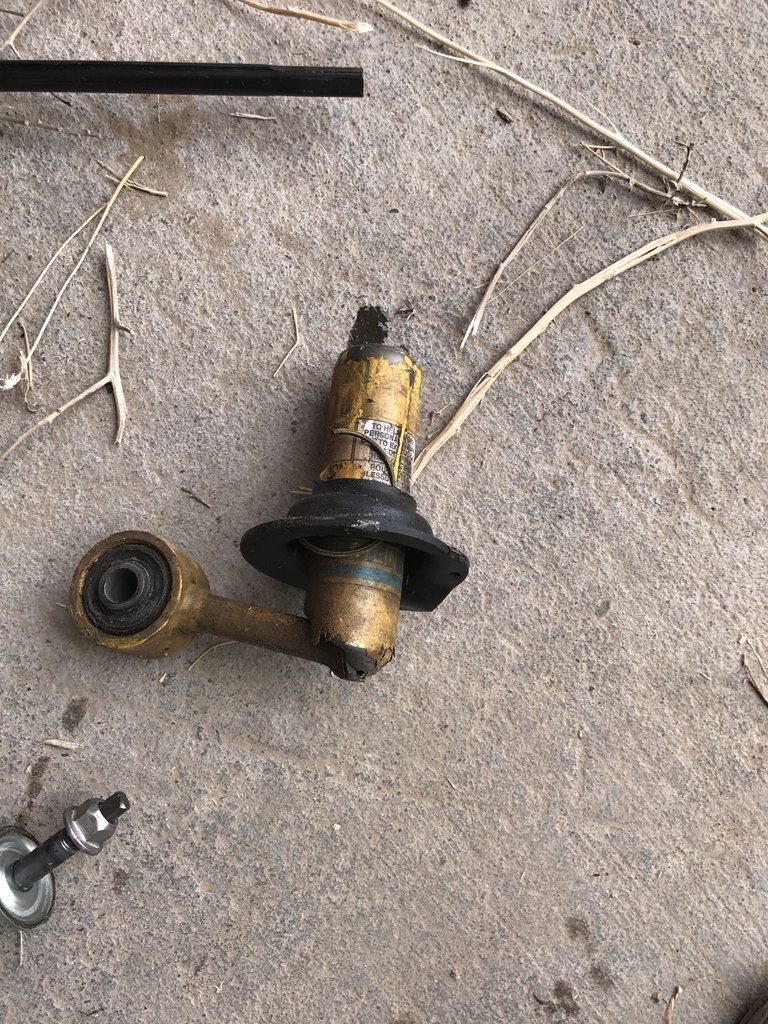

    A couple weeks ago i broke my front drivers side shock, which i have since replaced, but my coilover is resting on the sway bar, maning it really uncomfortable while off-roading, could the sway bar be broken? Or the shocks were not put in right?
    IMG_8190.jpg IMG_8185.jpgBroken^
    "Fixed"^

    You need a swaybar relocation kit to go with your lift. Cheap and easy to install.

    Or you could just take it off?? ;)

    You also need to run bump stop extensions so you don't snap the strut in half again. What happens with spacer lifts above the struts is that the struts bottoms out before the control arm hits the bump stops. All that force is transferred to the struts rather than the bump stops.

    He added a 3" spacer lift to the top of the coilover, likely voiding any warranty claims.
