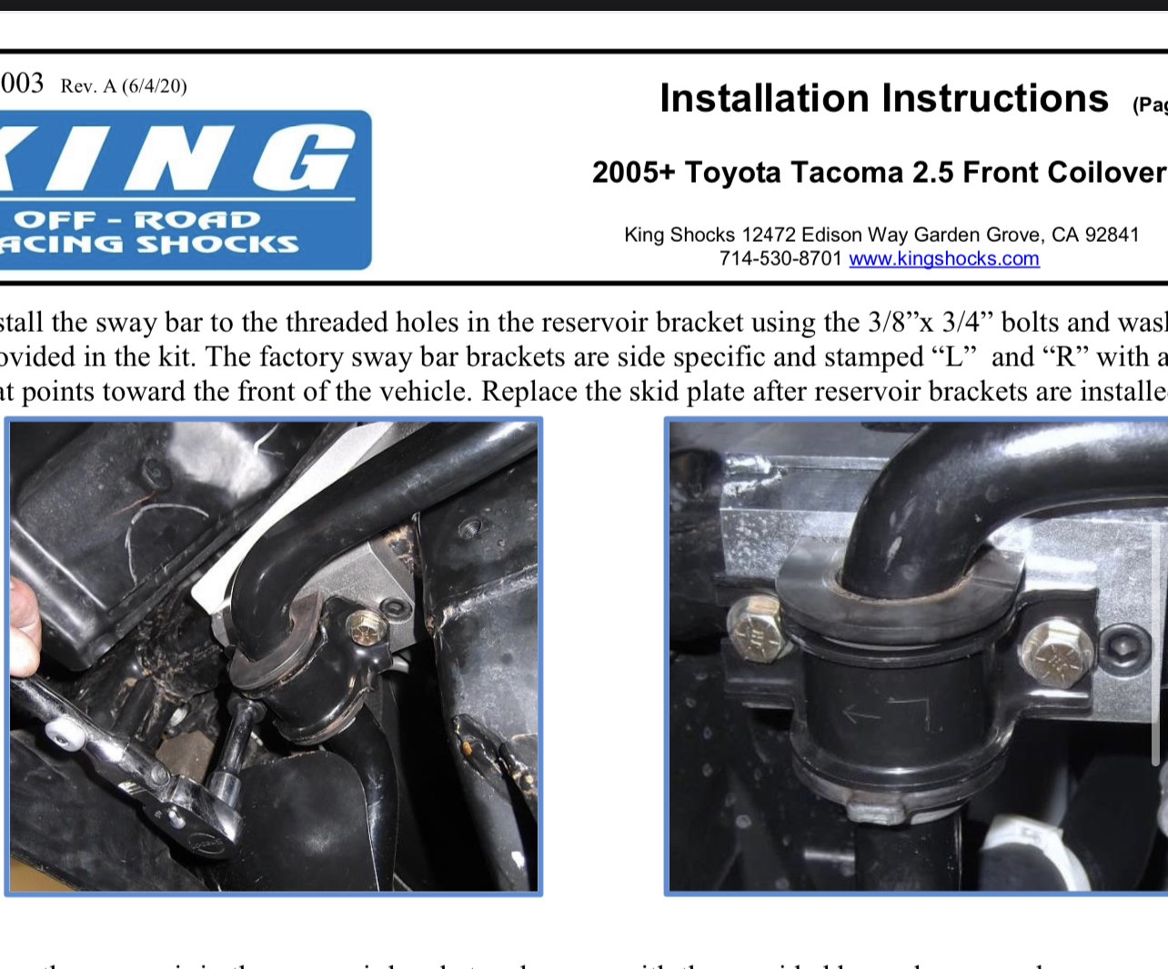

  14. Jan 23, 2024 at 2:18 PM
    #34
    johnnytwotimes
    johnnytwotimes Well-Known Member
    Feb 3, 2021
    #354931
    217
    SoCAL
    2021 TRD OR DCSB
    Question with sway bar brackets orientation. I have a 2021 and I installed a relocation kit which I noticed the brackets had L and R but no arrows, does that mean you can mount it either way? Not talking about switching sides of the brackets just the orientation.
  15. Jan 23, 2024 at 2:22 PM
    #35
    drizzoh
    drizzoh itsjdmy0
    Jun 29, 2020
    #332922
    2,323
    Andrew
    Arizona
    2021 Tacoma TRD Off-Road 4x4
    No sure side matters, but with the relocation brackets the sway should be pushed forward while being spaced down to clear the suspension components better.
    That said, I ripped mine off shortly after installing the lift. Rides so much better with it gone.
  16. Jan 23, 2024 at 2:40 PM
    #36
    johnnytwotimes
    Feb 3, 2021
    #354931
    217
    SoCAL
    2021 TRD OR DCSB
    So the picture above the brackets have an arrow pointing towards the front of truck but I guess newer models don’t have that marking. Idk if it matters and I’ll probably take out the sway bar anyway see how it feels. I daily mine
  17. Jan 23, 2024 at 4:30 PM
    #37
    drizzoh
    drizzoh itsjdmy0
    Jun 29, 2020
    #332922
    2,323
    Andrew
    Arizona
    Oh you mean the actual brackets for the sway bar itself, not the relocation blocks. It's been a while but I believe those are side specific and that the bar should slide forward when installing so the open end on those brackets that surround the bushings would face the front.
