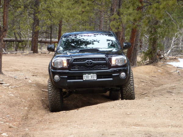

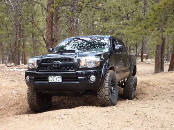

    I took mine off for a wheelin trip and havent looked back! :D
    few pic's...
