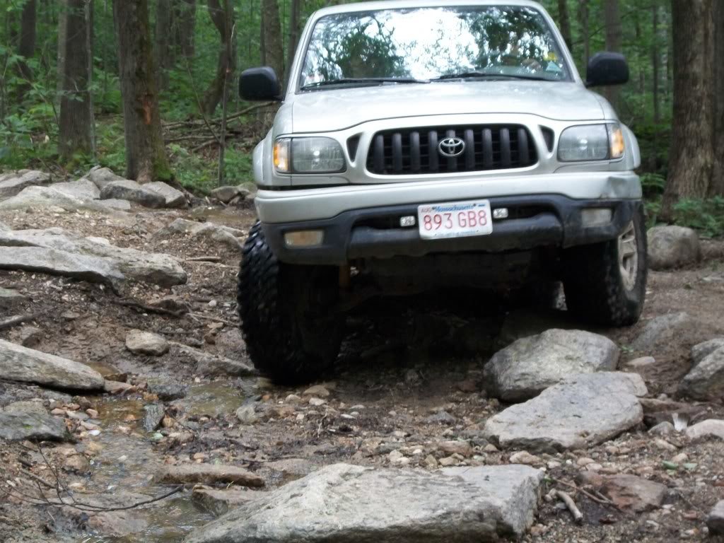

    Its funny how when i want to find a IFS flex shot i can't. I know i have pic's of the tire completley stuffed but i can't find a single one:confused: These are the closest that i have. The sway bar off makes a huge differnce when your riding through a lot of small rocks/bumps it not as jarring as one end doesn't have to follow the other anymore.

    Heheheh, yup can get ass end flex all day but front IFS flex is rare....

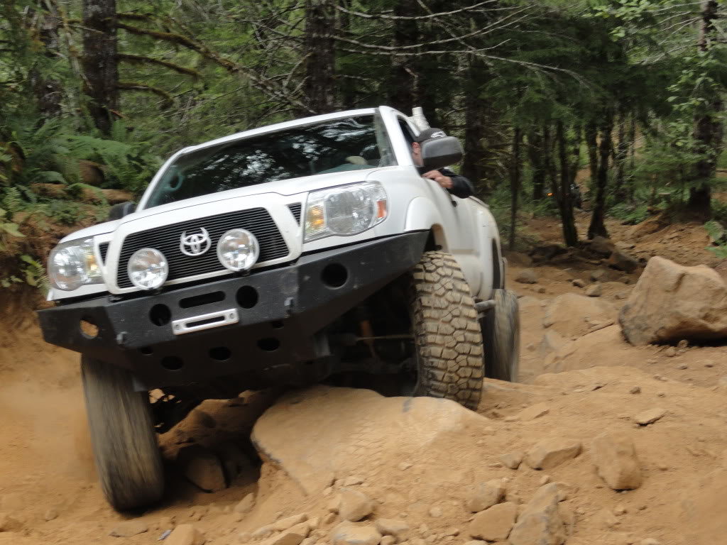

    IFS flex w/ no sway bar. Best pic I can find at the moment.

    Nice locker :D

    Thats damned nice eric, probably the most I've seen...;)

    Thanks. It still went a lil farther into the fenderwell after that pic because I still managed to get up over that rock and up the rest of the hill(pic doesnt give the steep-ness any justice)
