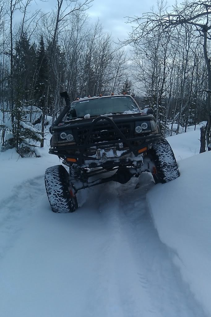

    IFS flexes?...
    This is what flex I got after removing my sway bar....and some other shit ;)

    Pshhhh solid axle no big deal ;)

    Your truck looks Badass

    I think that's the best IFS flex shot I've seen :thumbsup:

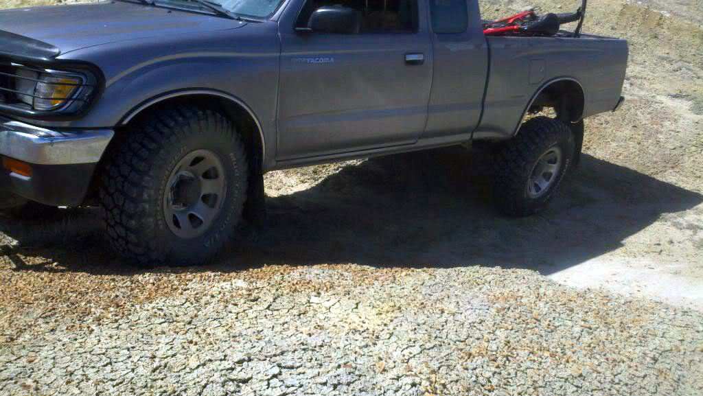

    So I ran about 2 months with my sway bar off after I had my 885's, 5100's and LR UCAs installed. I liked the flex, but I did notice that my passenger side tire was hitting up into the wheel well too much when the driver's side wasn't. I have a 1/4" top plate spacer on the driver's side to compensate for Taco Lean, and I figured it was because that side was stiffer that it wasn't hitting the wheel well.
    I must admit I liked the softer ride and having the extra travel for wheeling, but with the weight of my winch and bumper it was just a little too soft for hitting any bumps with any kind of speed. Now with the sway bar back on as of last night, my ride leveled out and it's much more responsive for the tons of freeway driving that I normally do.
    So, all in all, I like having the sway bar both on and off, but unless I wheeled every weekend I think I'll keep it on.
