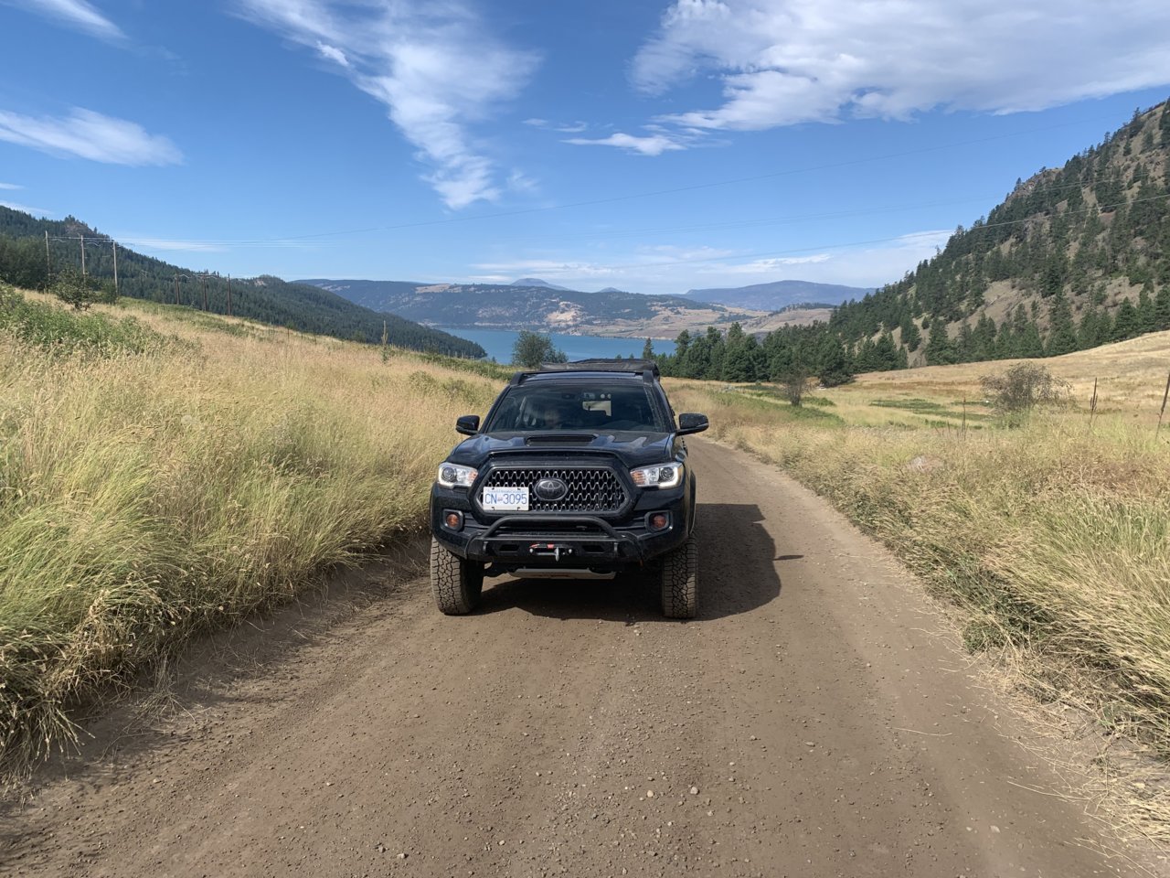

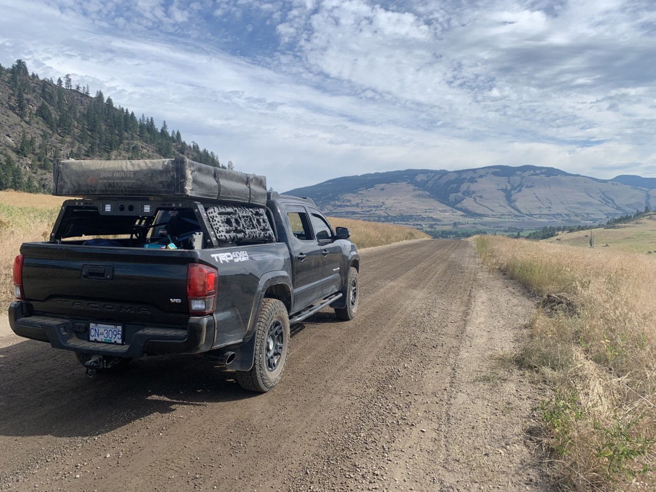

    Ricardo13x
    Ricardo13x YT: @UrbanOpsOffRoad IG: @urban.ops.offroad
    Feb 9, 2020
    #318785
    2,961

    Hmmm, I’m thinking about doing this. I know it will do so much better off-road.
    I do have 2” OME lift, about 500 of added weight and 33x10 tires. I spend a lot of time driving through mountain passes at maxed out payload doing 70-85.
    Wondering if it’s a good idea or not.
    Pics for attention.
