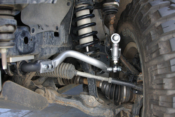

    Here's a $750 quick-disconnect system :rofl: https://www.apexdesignsusa.com/products/kwiklynx
    It uses the "sliding pillar" concept but attaches to the upper ball joint stud, and is designed to not rattle. In addition to the sliding links, there's a shock absorber on the sway bar itself, which probably contributes to the high cost:

    ^Yeah deleted mine too, and running 700lb springs:
    You will typically have a skid plate in situations where deleting the sway bar is beneficial.
    If you're handy with a welder you can also copy this design and modify the OEM sway bar:
