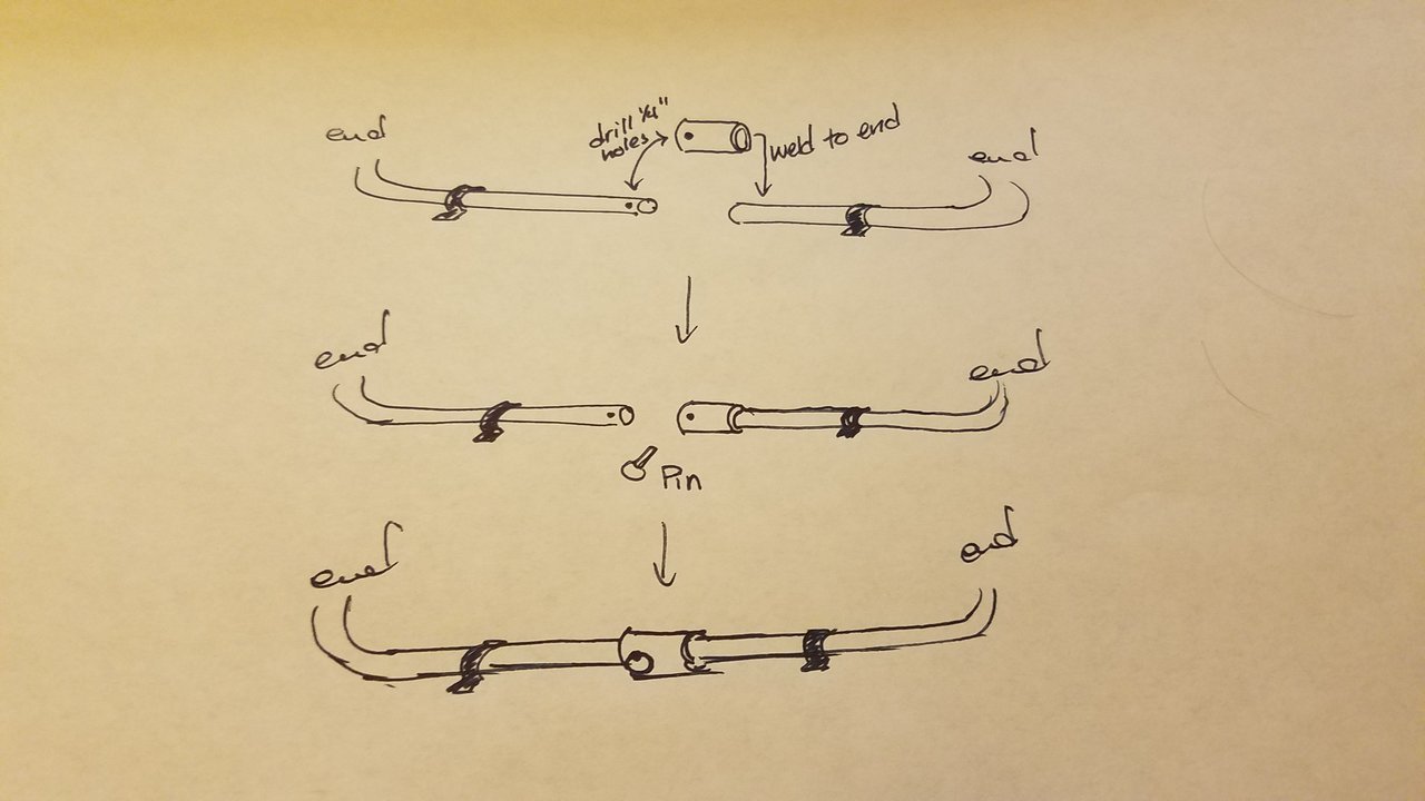

    So fellas, thought of this today, it'd probably take more time than I'm willing to spend on it but theoretically shouldn't this quick disconnect work? It involves cutting the oem sway bar and welding a collar onto one end, and connecting it again with a snug pin. Pull the pin, and presto! No more sway bar.

    Your understanding of the mechanics is spot on, material properties.. not so much. The bolt would shear almost immediately.

    Haha hadn't done the math yet for the material mechanics, just shower thoughts. Thanks for the feedback! :D
