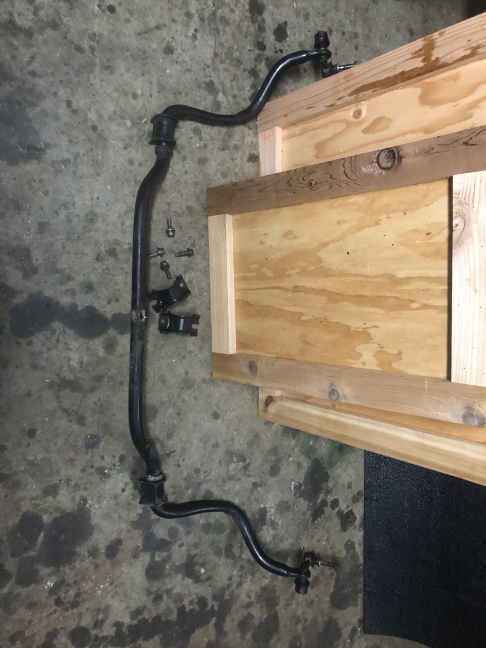

    Ok well off it came
    I’ll report back. If I don’t it’s because I died because I took it off.

    Haha no problems taking the sway bar off, maybe a slight amount more body roll but not bad at all. No off roading yet. Got a trip planned in a week so we’ll see.

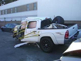

    :laugh: Put a handle on that, and you have an off-road Segway.

    That would make a nice little popup trailer. Only thing 3rd gens are good for - shots fired pew pew

    Ok, did some crawling and night and day difference. Way better without the sway bar. The road I drove normally makes me nervous as shit and it was like nothing. Of course now my tires rub like hell, 255/85/16, that never happened before. But makes me glad to know the suspension has that much more movement going on. Also did more high speed on road use on this trips and def need to take it easy without the sway bar but not to the point where I’m gonna put it back on. Thanks.
